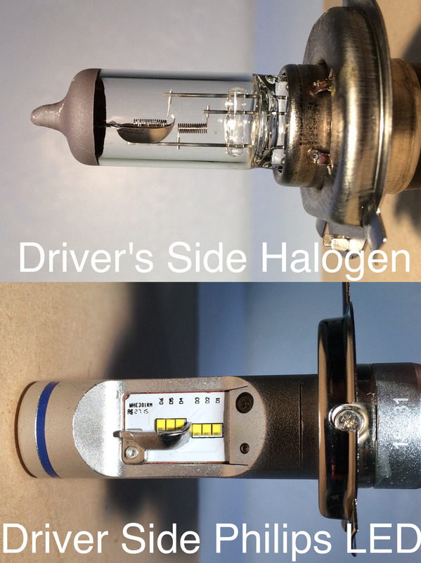

Buy Phillips H4 LED's and put into H4 housings. Plenty bright! Love mine, and no need at all for a light bar.
Don’t you have bad scatter of the lights since LED have different beam patterns, the H4 bulb housings are made for incandescent bulbs, unless you got some projector light housings?
I've explained this in a few posts now. New high quality LED lights (Philips) have largely overcome these problems. The LED elements are in exactly the same location as the halogen filaments used to be. I think the multitude of crappy China specials on ebay for years ruined many people's opinions of LED lights. The Philips brand ones are excellent in my experience. Mine are in Koito H4 housings. Would never go back.
thanks for the explanation, might need to look into this, I prefer the warmer spectrum of light though, wonder if there are options?
They add various phosphors to LEDs these days to get the warmer colors out of them (think house LED lights). Not sure with the Philips automotive headlights. Maybe read into it on their website.
I should comment that I do get a bit of unevenness on high beam, but it's not enough it really bothers me. And I live in a city, so never get to use high beam anyhow. Low beam is smooth and even with the nice H4 style vertical cutoff.
