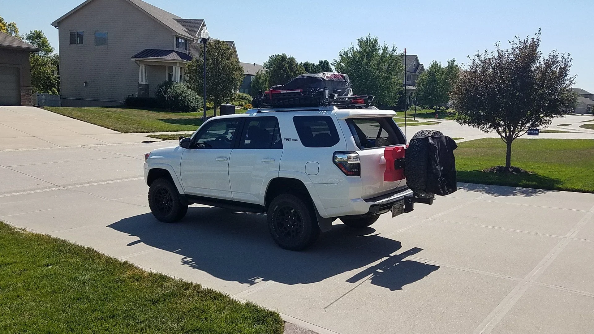

I went with OME BP51. Heavy spring in the rear...2.5" in front.
How’s the ride around town, especially when not loaded down with gear?
Well I don't mind the ride however I have a hitch mount for a spare all the time so I'm carrying a medium load. Went with the heavy load spring when I have more gear. I had a upgraded OME spring in the rear giving me a 1 inch lift. I like the BP51 suspension...but if I could start all over I might look at King or Icon. I've always liked OME...
