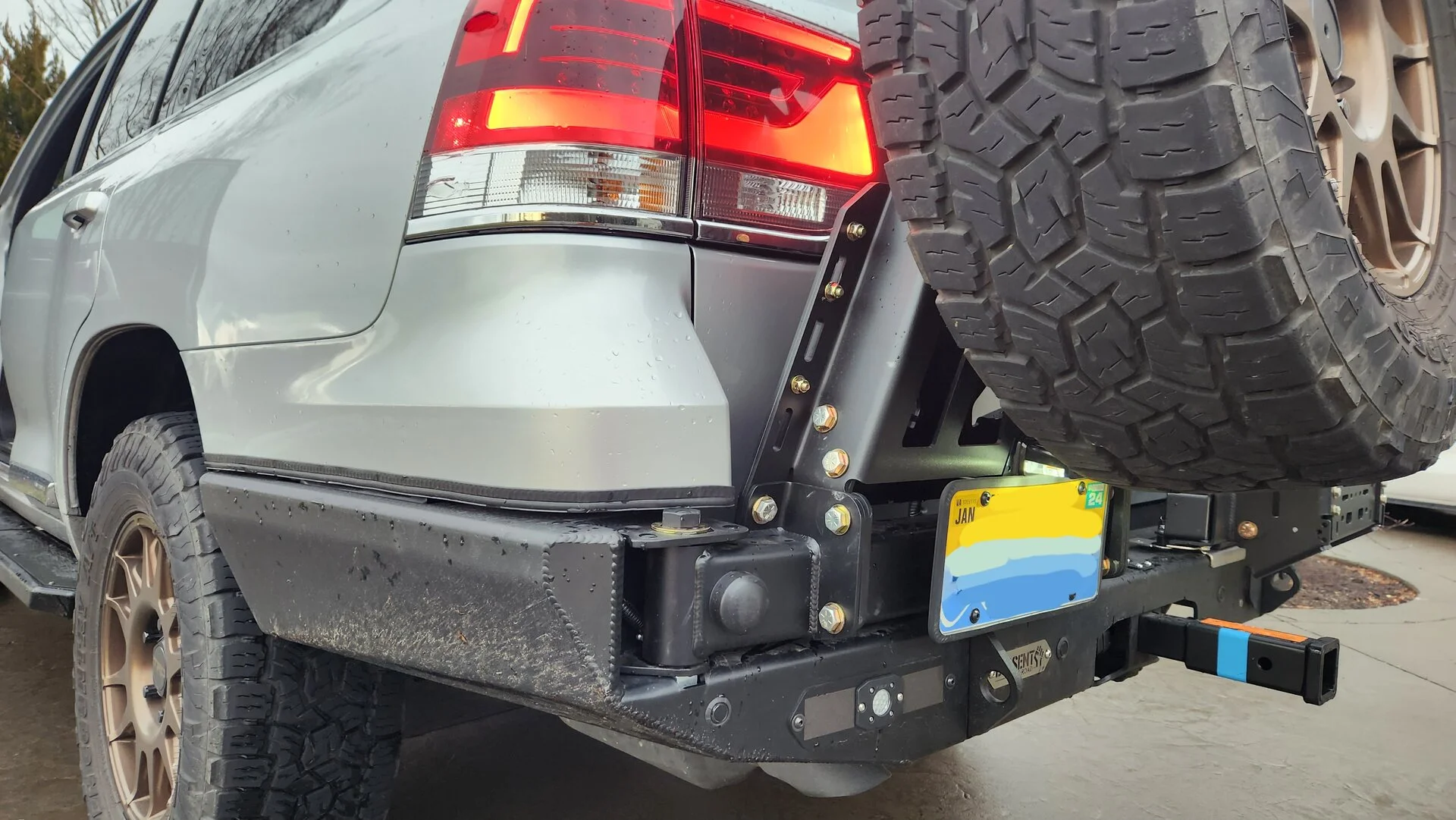

Just to clarify, I have a rear bumper with a swingout that blocks part of the stock plate location, so I am running a plate on the tire swingout where it needs a different light setup.

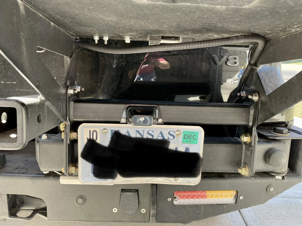

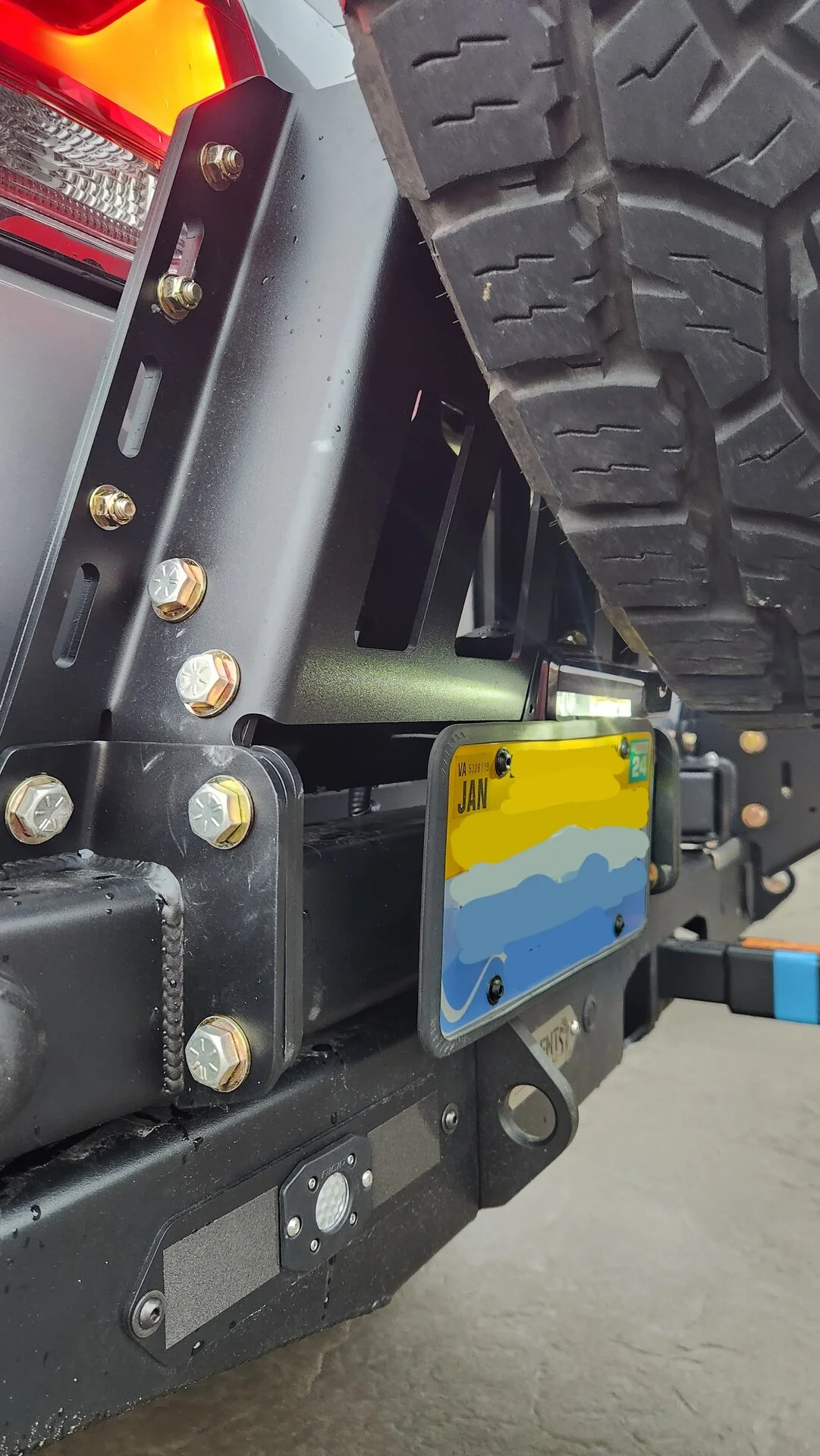

Just relo’d my license plate light to my accessory swingout. The original light had died, and I replaced it with the one from Amazon noted above. I drilled holes in the accessory crossbar throughout the cable through. The light works pretty well and you can all see my license plate as before it was kind of hidden by the spare tire. Although that did give me free access to the Kansas Turnpike in Wichita as the cameras couldn’t see the plate.
