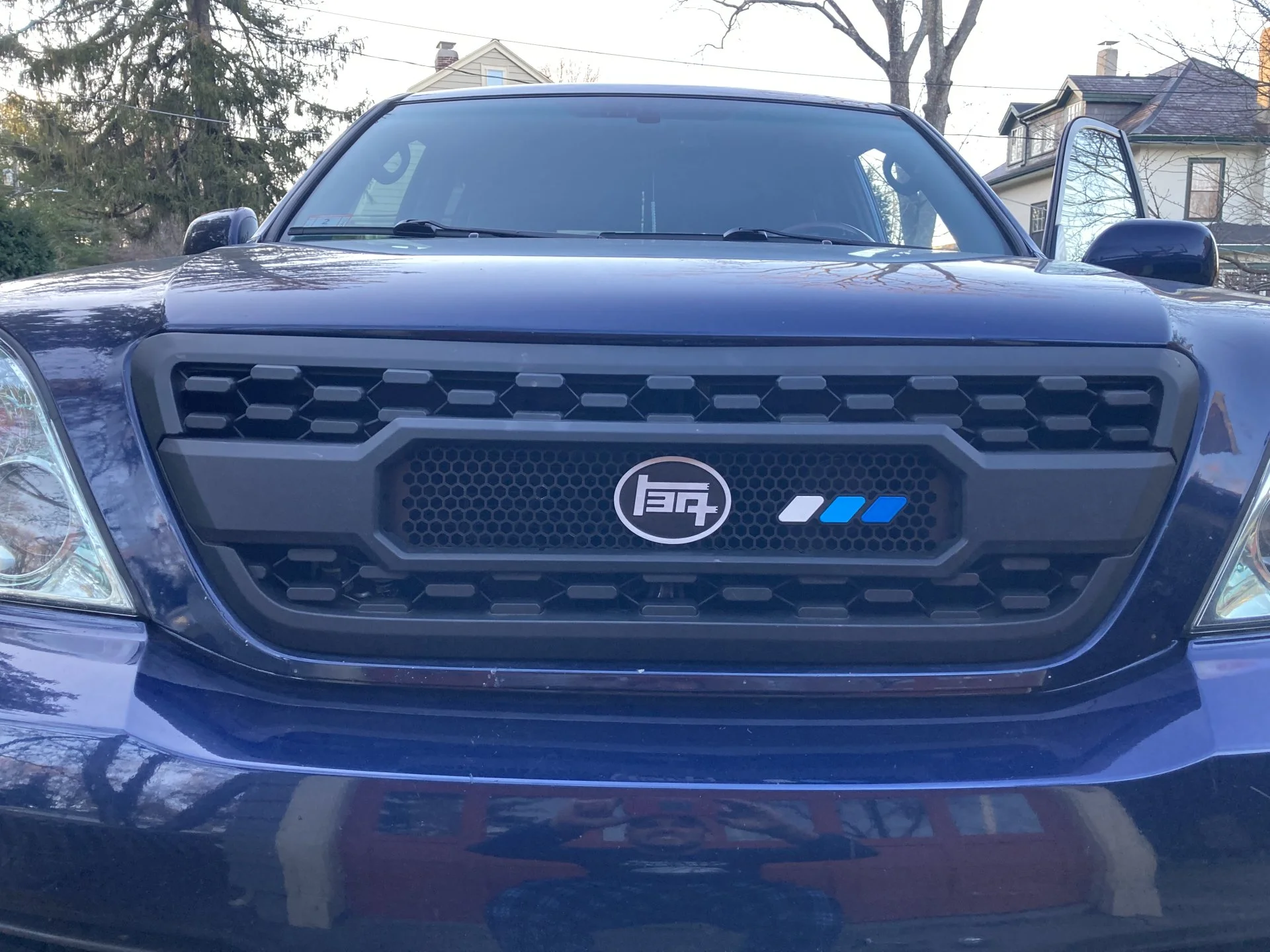

Recently I installed the Garage Alpha TRD style grill w/ the 3 grill lights and wanted to give out some insight on my install process.

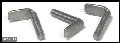

My original hardware rusted and the bolts broke off. Instead I used 8x Weld bolts (pictured below) paired with flange nuts. But I would use nylon lock nuts if I were to do it again.

Lastly, the finish of the grill itself is a flat black, almost looks unfinished and needing paint. Not too worried about it just wish it didn't look so fresh off the 3D printer. The Lexus/ Toyota logo separates from the grill so painting the logo itself would be a very easy process.
All in all the grill looks nice on the 470, I do believe the kit could improve in quality as the grill itself looks like it would shatter with the smallest stone, along with the useless hardware.

Those weld bolts look like a good option.
