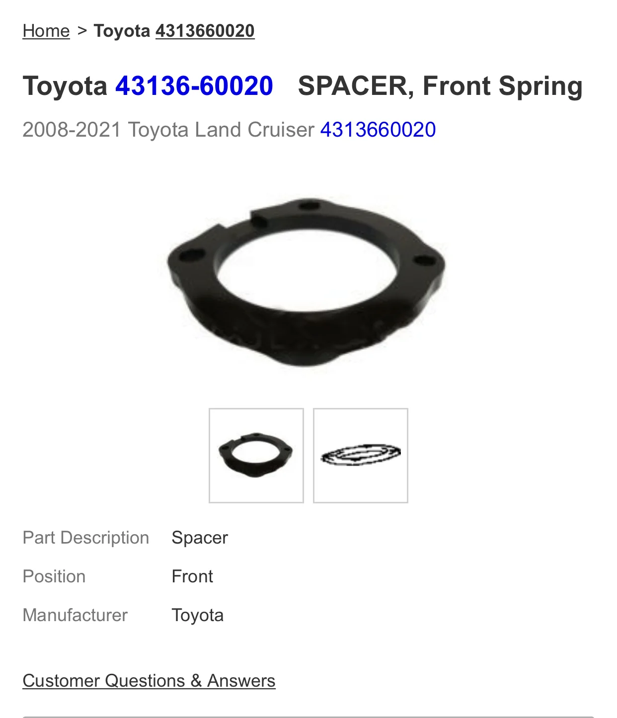

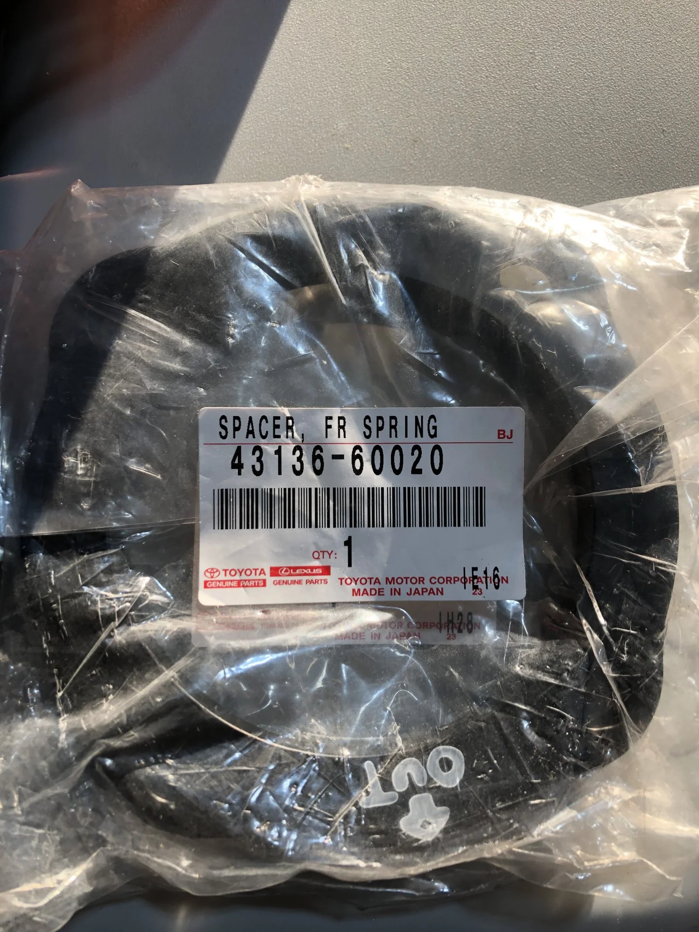

Can you please be more specific about what you are calling a "leveling kit"? People use that term with different meanings. It'll help us give you better ideas.
Do you mean these spacers:
If so, your dealer did something very wrong. I've installed them myself, and they just space the strut housing down a tiny amount. You don't even have to remove the spring from the strut. My guess is that something was likely left loose.
Perfect. Thanks.
They messed something up on the install. It literally sits between the stock strut/shock top mount and where it mounts to the vehicle frame. To put it on, you need to remove the shock/strut assembly, put the spacer on top, and then reinstall it. There is nothing to it.
That being said, they'd have to do everything you'd do to remove a shock/strut assembly. They could have easily failed to install nuts/bolts, tighten nuts/bolts, or properly torque nut/bolts.
