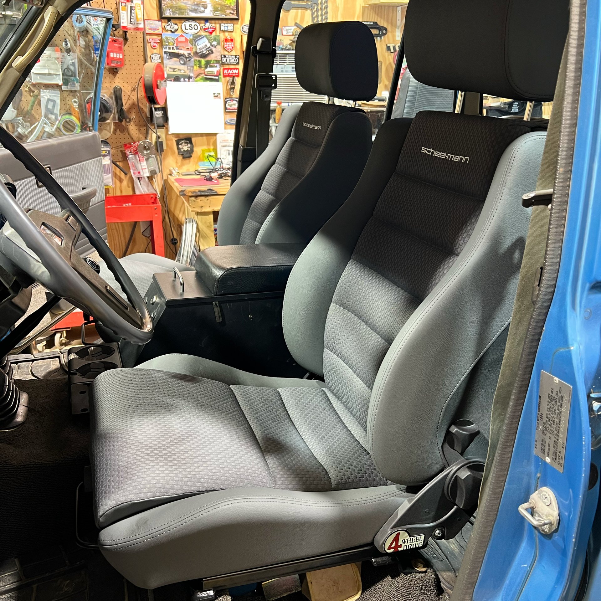

I’m 5’8” and they are great once in the seat. The side bolster takes getting used to. I have White Knuckle 15* sliders so I use them and a A pillar OEM handle I installed long ago to go up and over versus sliding in like a normal 60 seat.
I just did a 1750 mile trip in it. Total and complete game changer and I had new SOR foam in my 60 seats.
So a taller back but the base height looks the same as stock. Not bad. This truck won't be a long distance truck so I'm not sure I'd want to put these in.....but I have this idea of how I want them to be. I'd think about maybe doing a smaller headrest too. Something custom. We'll see.

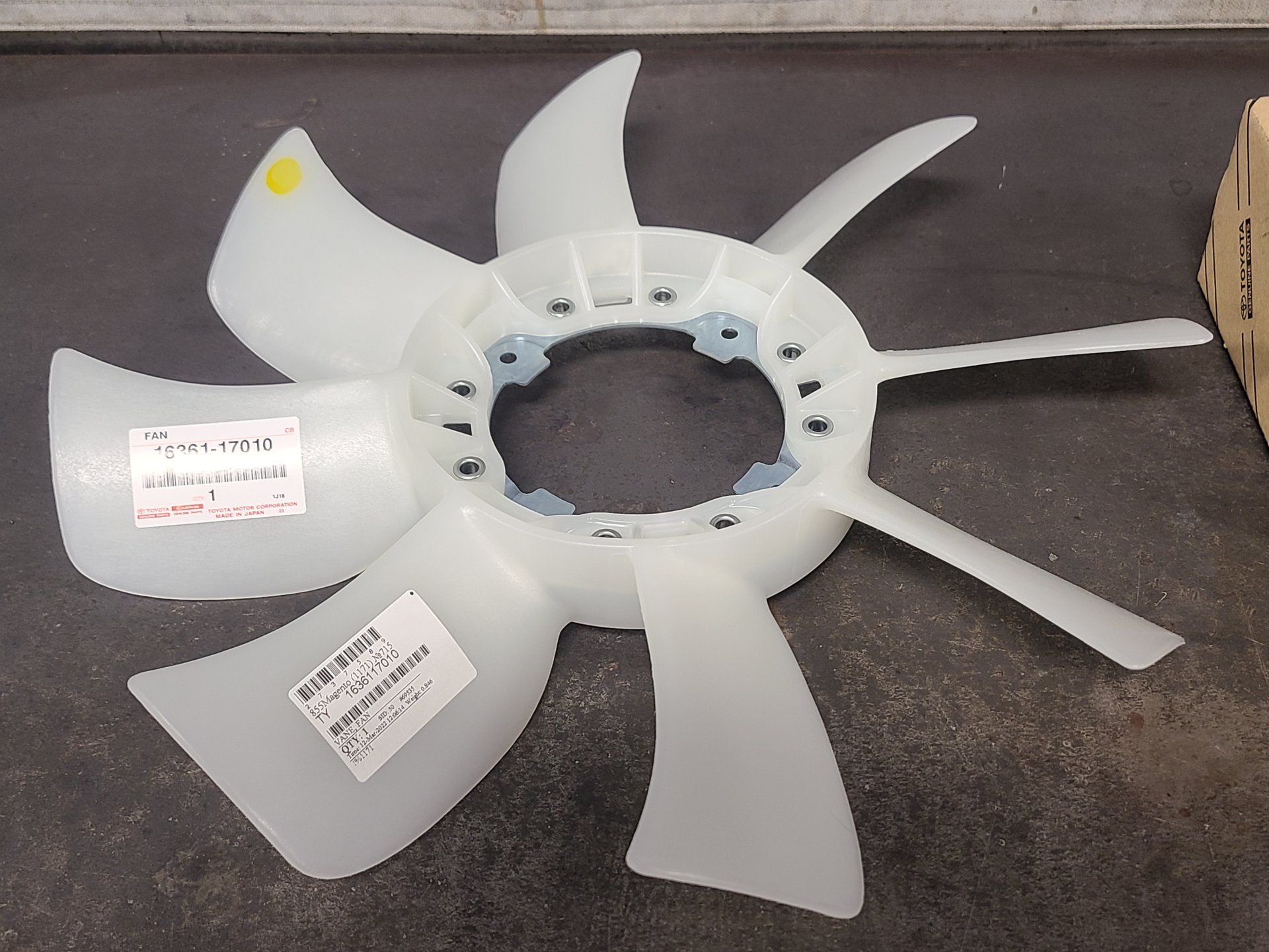

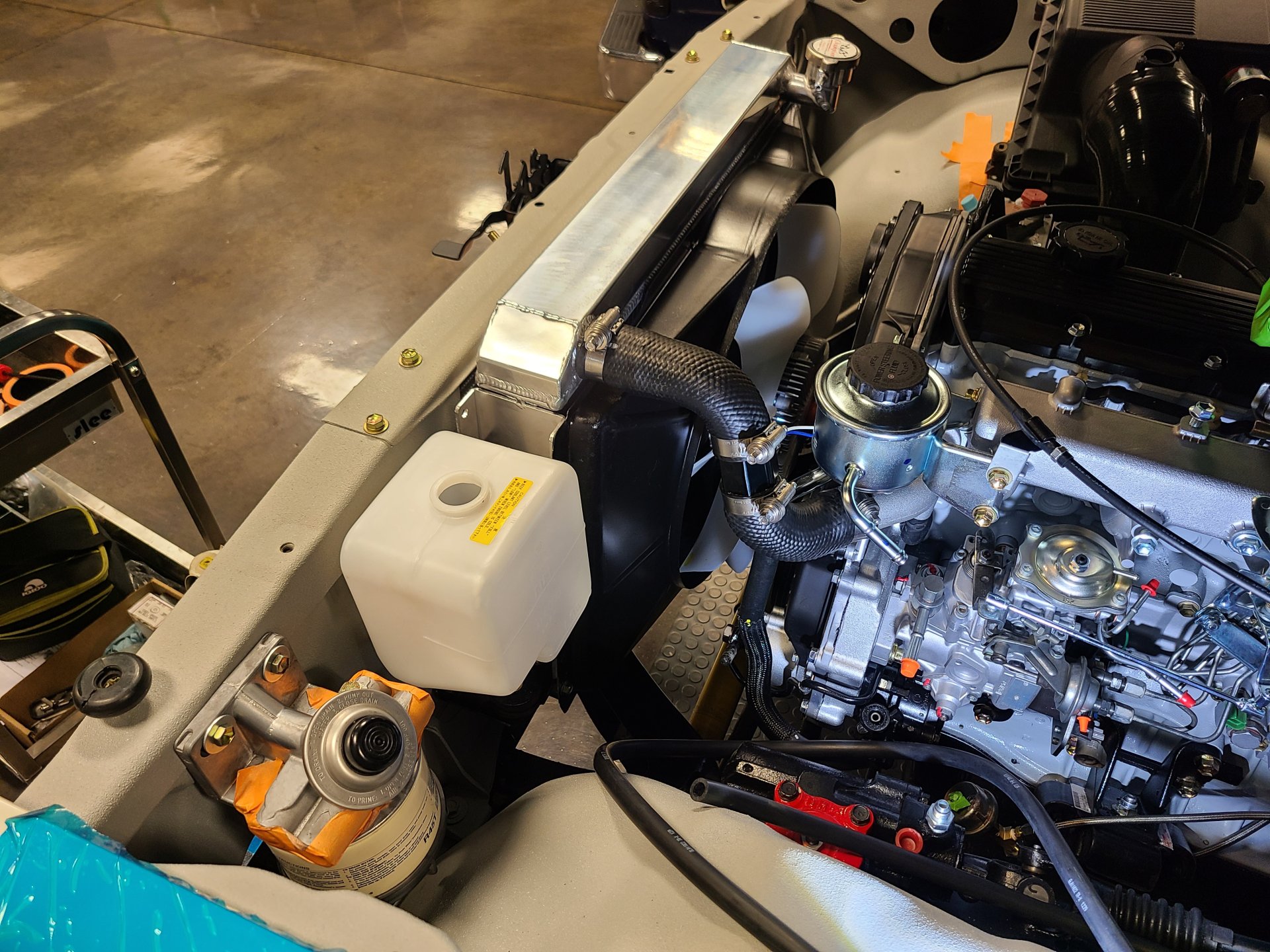

Another solid day today.....a lot got done. Radiator and shroud finished up today....some trimming on the shroud but nothing major. We cut out Champions nutserts and used our own hardware. Shroud fits on like Toyota designed it to fit. Cleaned it and gave it a quick coat of black paint today....we'll powder coat it down the road when the radiator and intercooler come out for ceramic coating. I'd like to drive the truck around before we do all the coatings...make sure we don't need to make any changes.
Fan and clutch we used

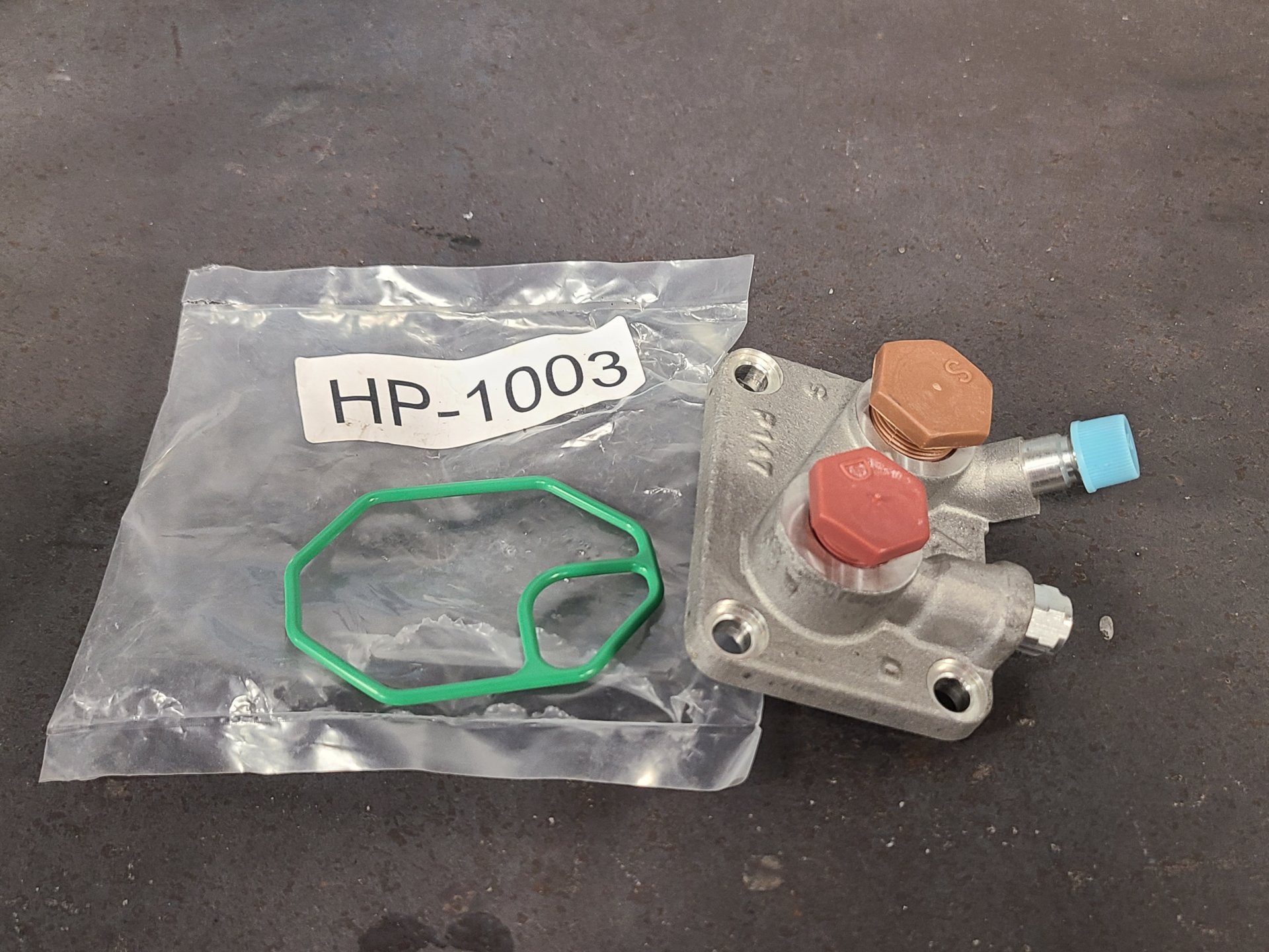

Got into the AC setup today.....ordered up the fittings we need. I've been buying all my stuff thru coldhose.com. These guys have it all. Hopefully I got all the right fittings so we can start making lines tomorrow. If it all goes in the way I want it to, it should be really clean.
We use this cool top plate from them for the Denso compressor......makes things really easy to hook up.

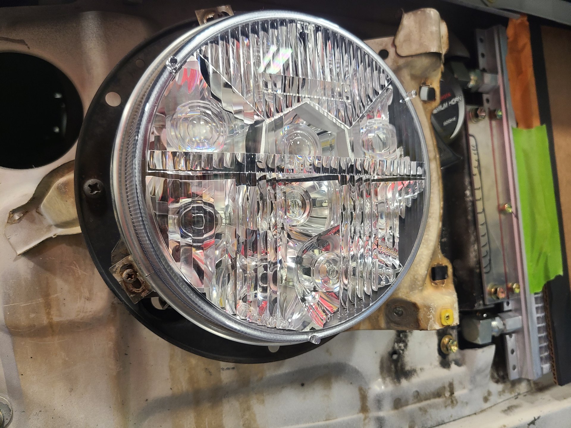

Having a headlight quandary......not sure if I want to go with these super cool gen 1 Trucklite LEDs I have had squirreled away. I have them on my HZJ73 and I really like them although the bull bar kind of blocks a lot of their light output. I think the optics of this light are pretty precise.....bull bar uprights aren't so good for them.
These aren't as offensive to me as some of the other LED lights out there. I don't want it to look modern.
Here they are on the 73......they look pretty cool.
The other option would be the Koito(on the right) with a high dollar LED bulb. I'm running LEDs in some of my reflector light trucks and they are very good when aimed properly. Lots of light. Need to get this trucks face on....getting tired of looking at this mug.
Mounted the fuel filter in an unusual place.....I hope it works out. Due to the strut for the hood lift and the vacuum reservoir, I couldn't shove the filter in the back corner like I wanted to without a really complex and ugly bracket. The filter has a water drain on the bottom so it sits pretty tall which made it tough to fit more forward on the fender area....so we're sticking it all the way forward on the rad support. Easy to access for changes, easy to drain, out of the way. Should keep the fuel lines in and out nice and clean too :)
We will run both the fuel line in this area as well as the vacuum reservoir line.....nice a clean.
Koito x10000
Kinda what I'm thinking too. Not sure how an LED bulb will work in them....they have a shield in front of the bulb. Easy to swap in and out so no big deal. I had the upgraded headlight harness on this truck but gutted all that out.

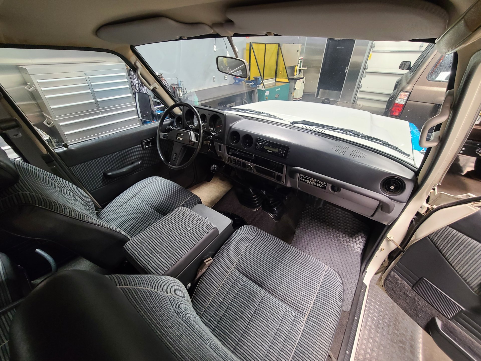

I FINALLY have an almost put together interior.....still some stuff apart in the back back but the front is back to the way it was before I took it all apart in December. Love this interior.
And the icing on the cake.....

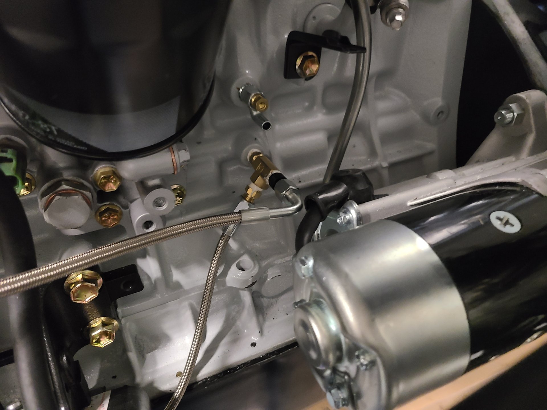

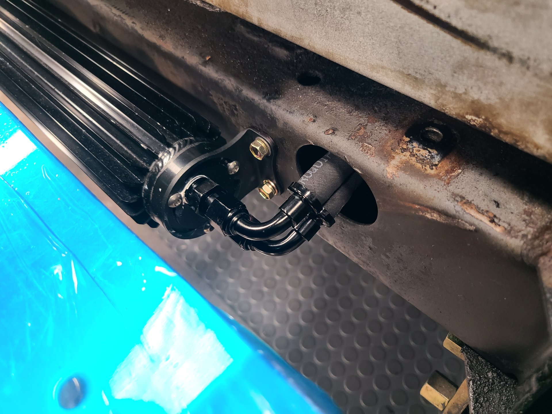

Another day of getting a lot of little stuff buttoned up. Got our PSC Motorsports fittings and hose to make the high pressure line. These guys sell a 16 and 17mm to 6AN fitting for the factory steering box....and on this application we use a 17mm on the 1HZ power steering pump(I think it's a 17mm on the pump). Makes for a really easy setup. I have had these on my other trucks for a while with zero issues. Field serviceable too which is nice.
Made up the return hose as well as the low pressure line to the cooler. Aeroquip pushlock hose on 90 degree 6AN push lock fittings. Nice setup. Passed thru the hole on the frame perfectly....
We secured this setup to a bracket we modified on our injection pump. Not as secure as I hoped but I don't think it's going to go anywhere.
I got really worried about hanging all this junk off the brass T on the block. Next one I'll do differently I think.....found a couple better fittings that they use on Hondas. I had to pull the starter today and it cleared the pressure sensor line without an issue.
Nice fit and it's out of the way.
