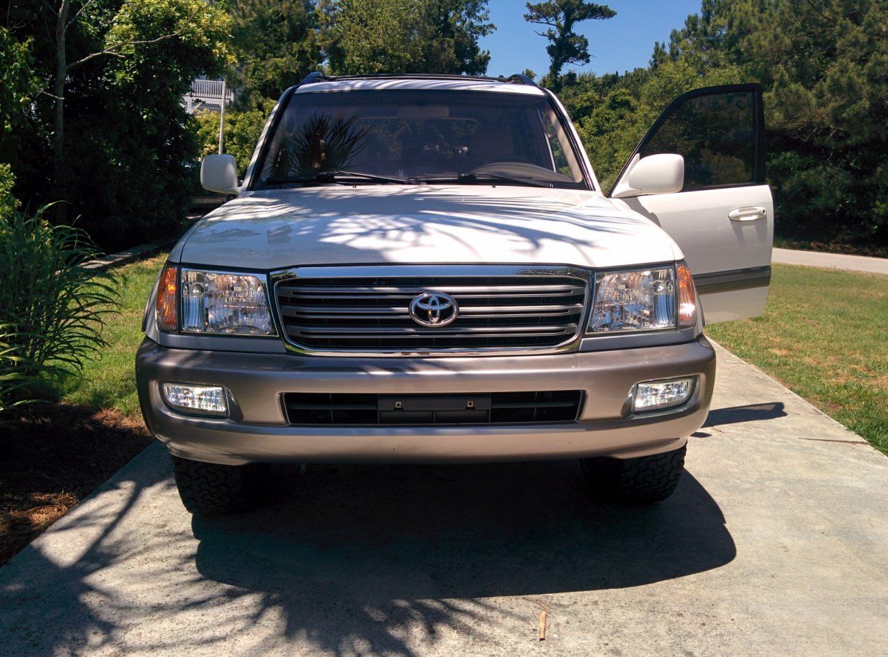

I used these in my fogs but also tried them in my low beams. They are nice they have cooling fins on the back no additional wiring pretty much plug and play...
Here are what they look like in the fogs
No issues so far, no flickering or anything. Pretty good price point @89$ US
