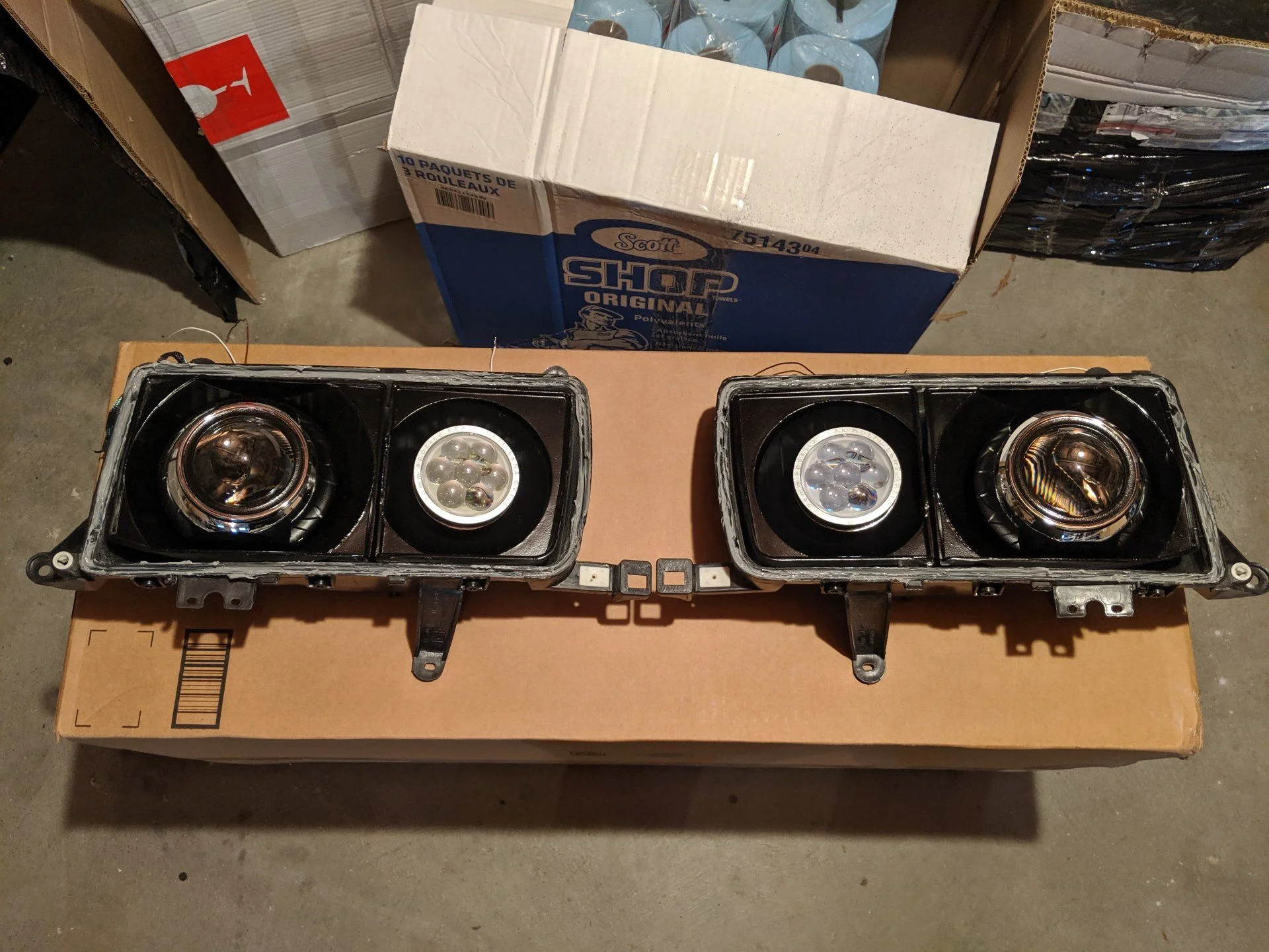

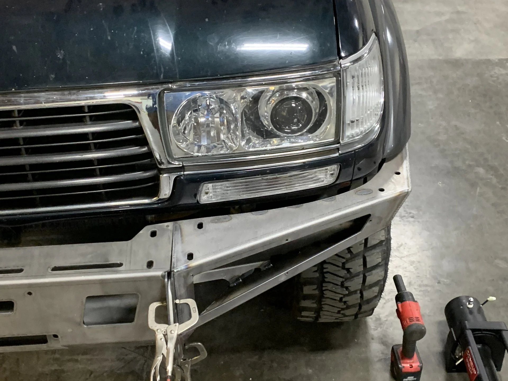

To avoid this, I installed a set of Depo light assemblies and loaded them with a Morimoto HID projectors. Much better than OEM and kind to other drivers. The conversion and install are easy with a couple small details like don’t bake the assemblies too long and melt the tabs. Ask me how I know !
I know the performance of the HID projector retrofits are AMAZING however the look of the installation reminds me of this:

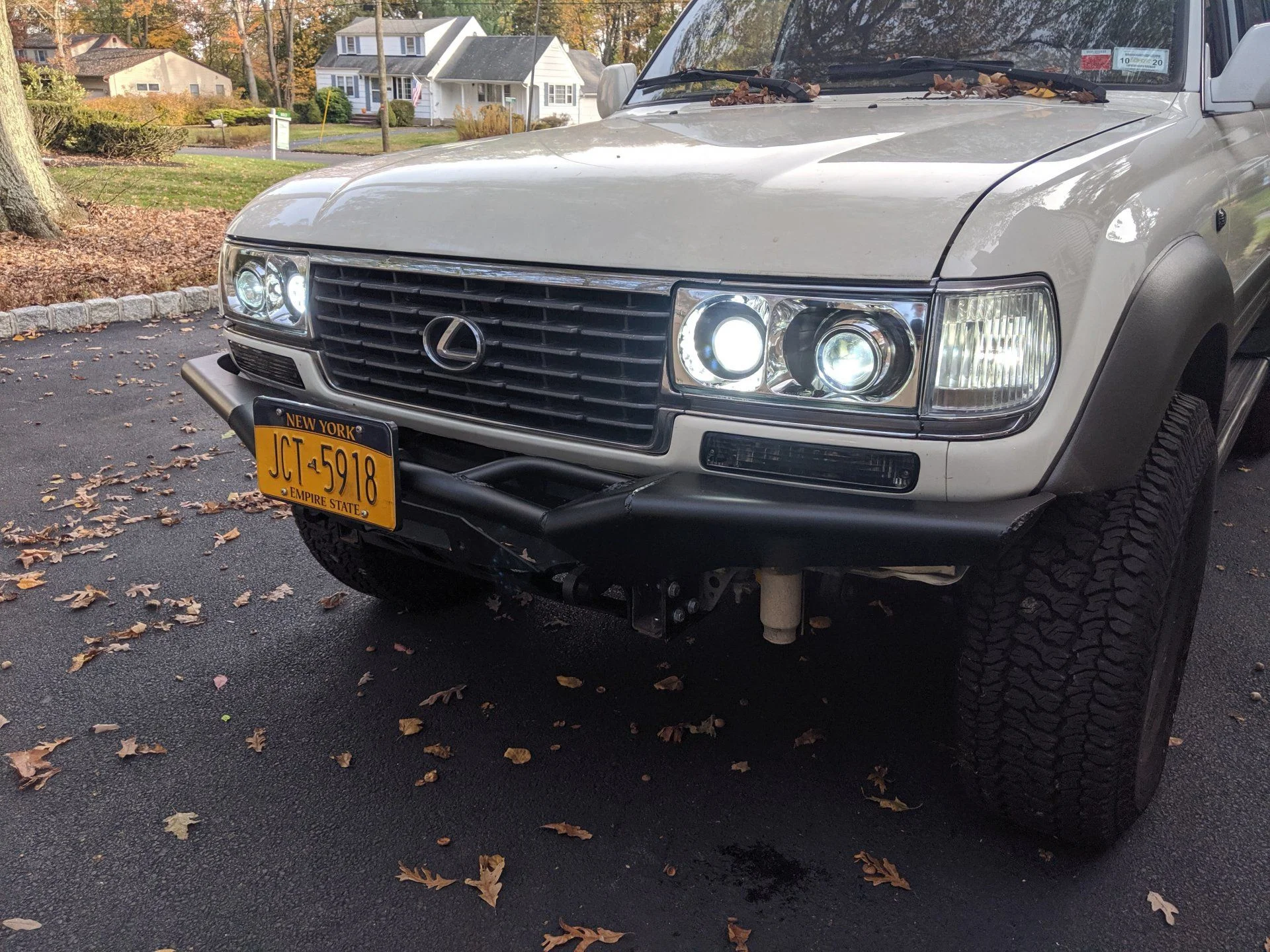

I liked my stock ones fine too. I also have really good vision at night, but for those people who look at everything in full bright all day (screens etc) I think it is hard on them. I drive at night with sunglasses on as most headlights from oncoming traffic hurt my eyes. I only went LED because i wanted round headlights as i don't think the LX450 headlights are nice looking from a vanity point of view.
