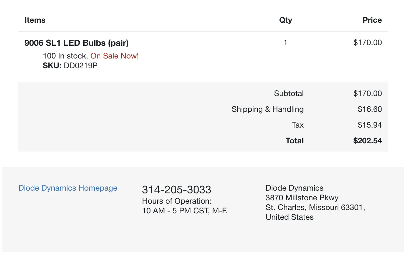

I ended up buying a pair of 9006 SL1 headlight bulbs as Diode Dynamics is running a site wide 15% sale at the moment, originally $200 for a set.

I think you'll really like those. I've been happy with mine.
@ncavi10 had a set go out on his Subi and DD replaced them, no questions asked.

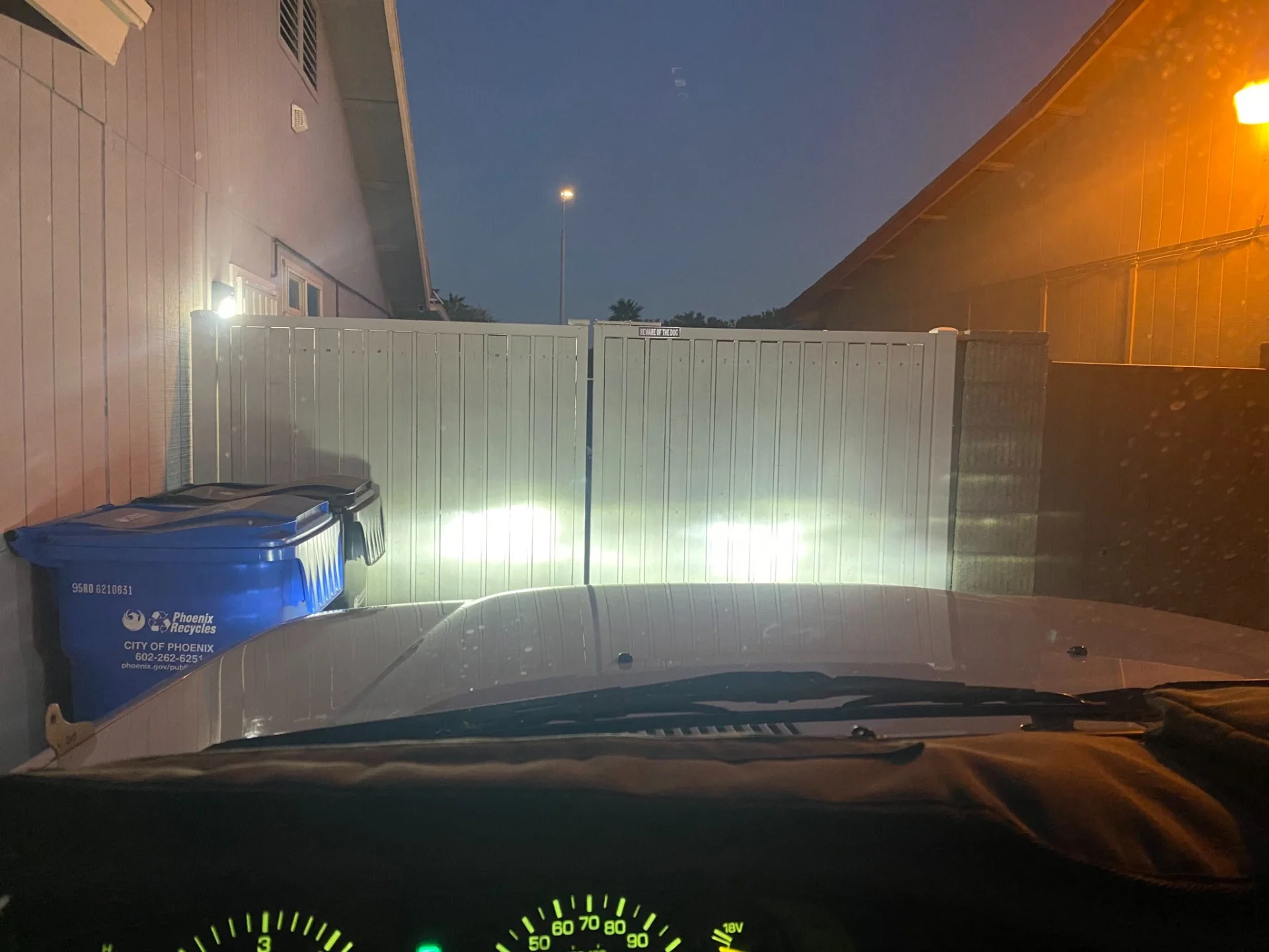

Are you using the 9006 SL1 in the stock housings? how is the light cut off? or is there any?
Yup, in stock housings. The cutoff matches factory, the idea with these is that you position the thin LED to mimic the original halogen filament... so you are reflecting the same factory beam pattern, just with more light. The cheap LED's don't do this well.
