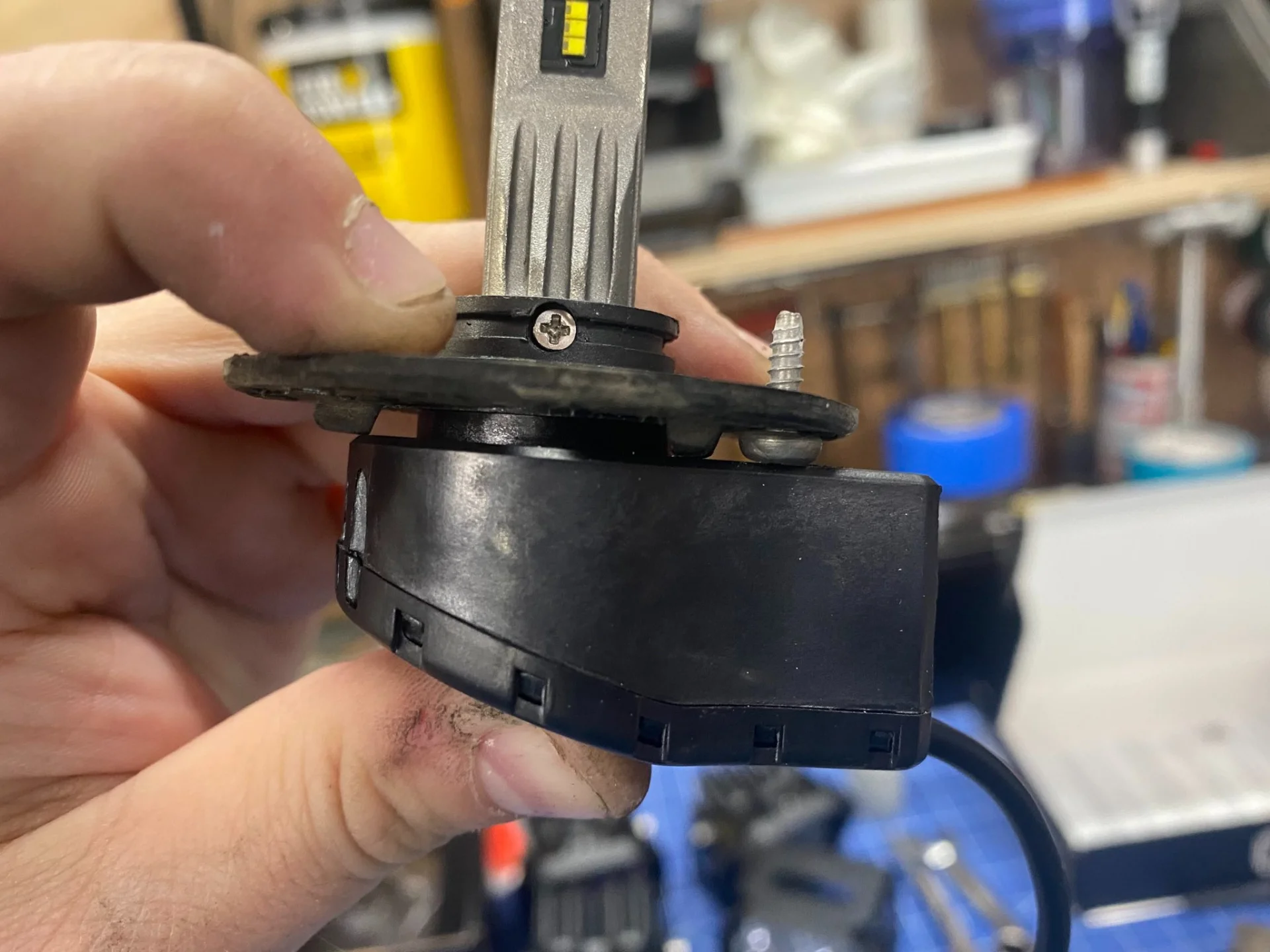

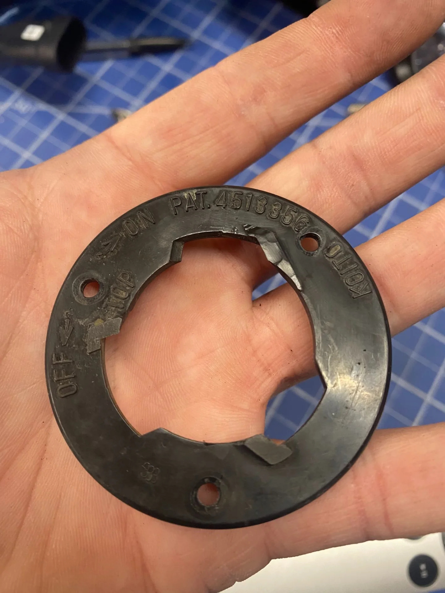

If you remove the ring from the back of the headlights (3 screws each, use a stubby phillips, headlights installed) you can remove the material from the 3 humps on each ring and the SL1's will install :)
The screws seem to be far enough away that the SL1 housing can flex.
Material removed, shoot for removing about half the thickness of the hump:
