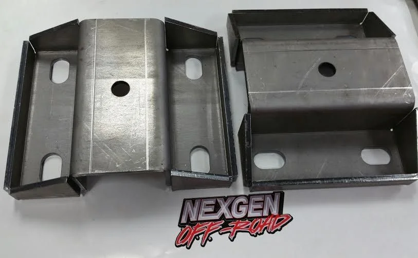

For high clearance spring mounts, if you have access to a welder, you can make your own with flat plate and angle iron. Can't seem to find a picture of what I'm talking about, but picture flat plate on the bottom of the spring with a locating hole, then weld the angle iron to it turned up, so that the nuts on the Ubolts are next to the spring, instead of under them. Sort of like this:
