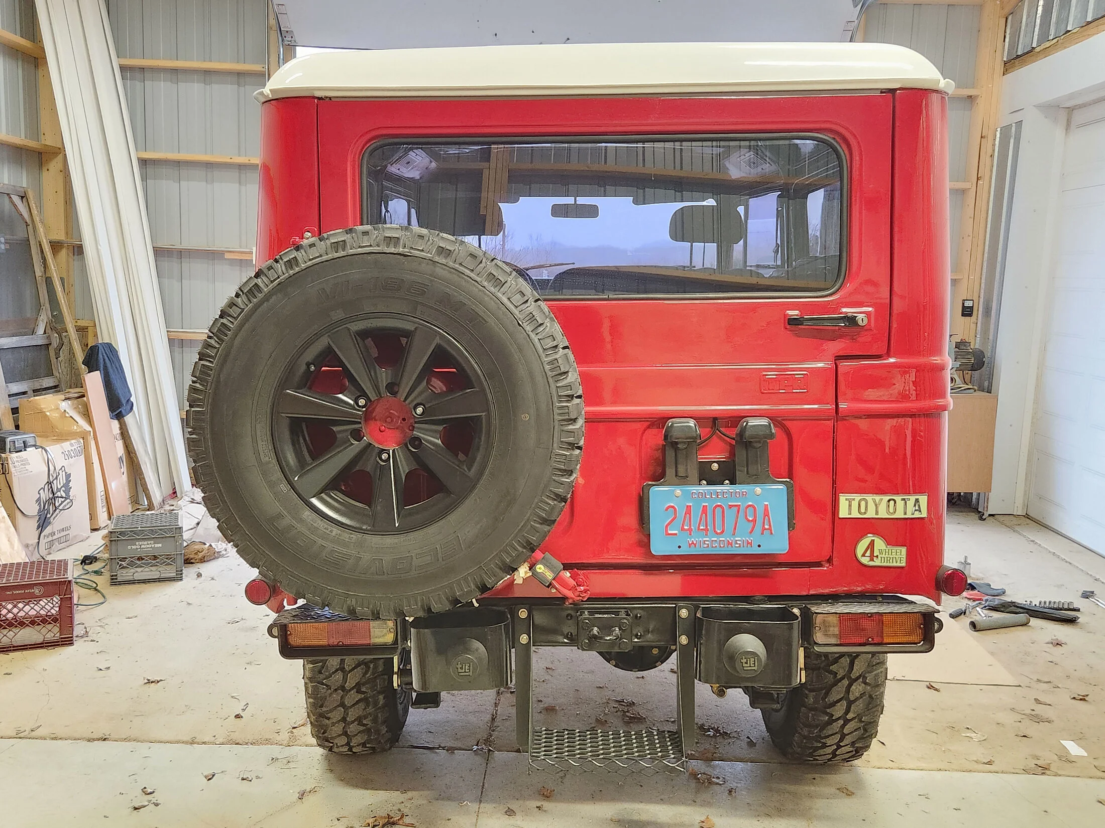

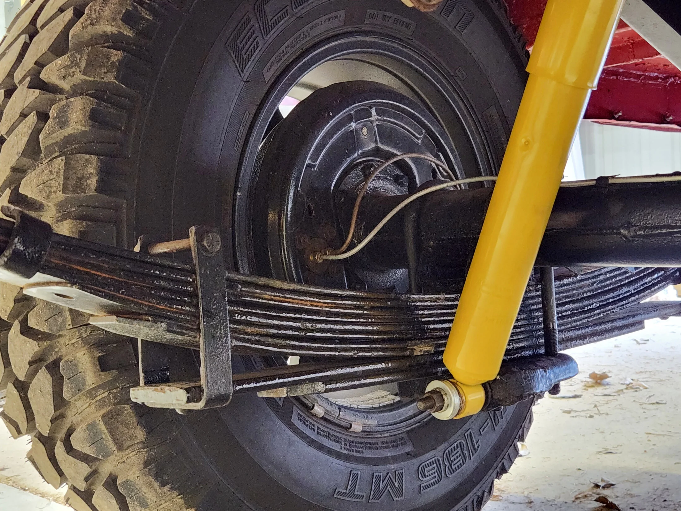

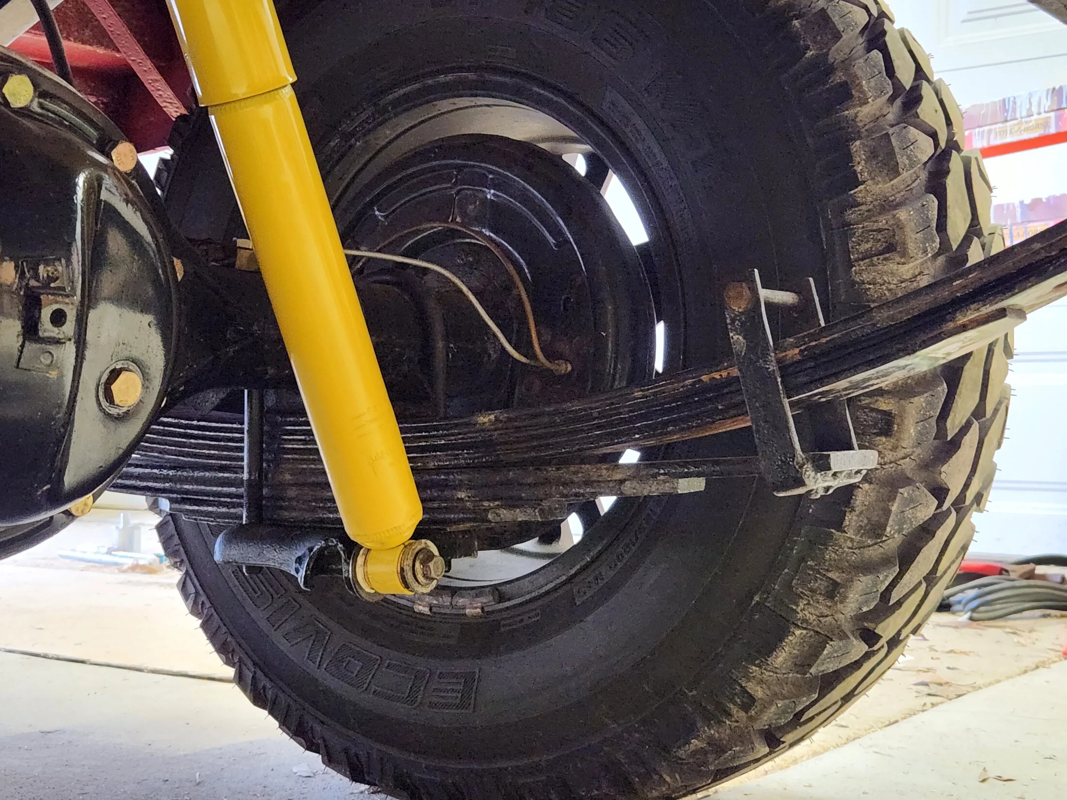

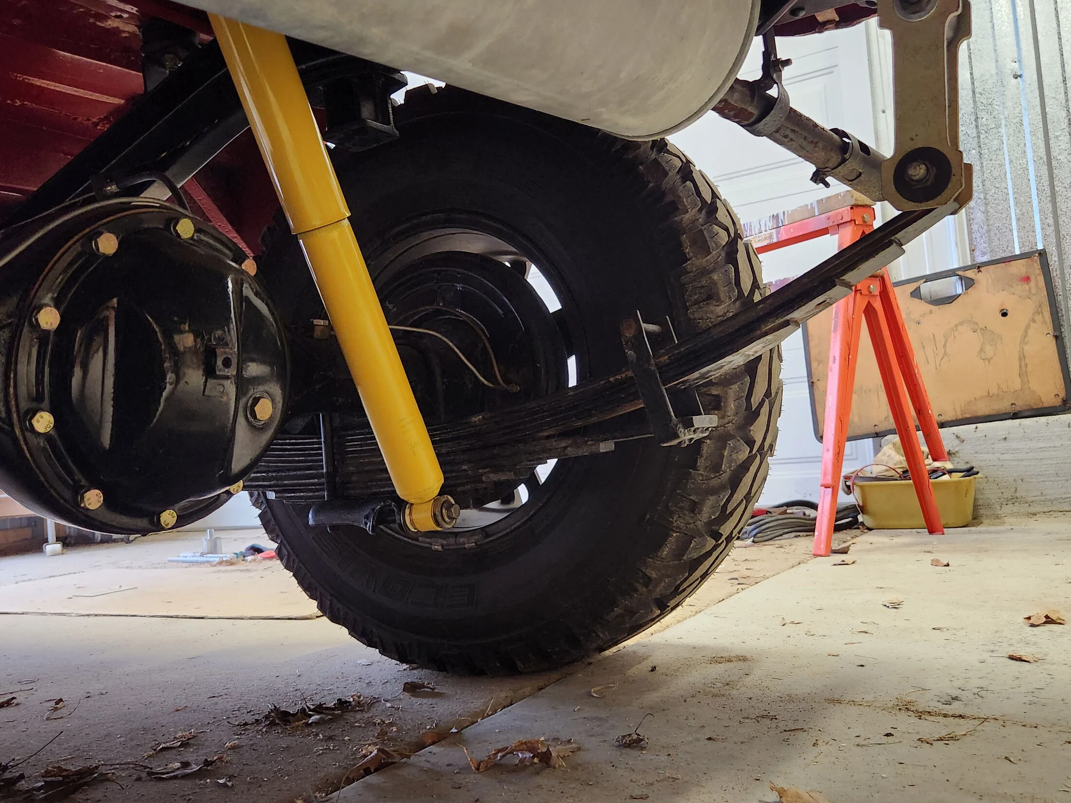

here are some pic. note that the rear right side measures 31" to ground, while the left rear side measures 28" to ground. the space under axle measures about 3" of leafs on each side. I hope that the pic will provide some insite

I have uploaded some pic. can you please check it out, maybe something is wrong or easy to correct. thanks
