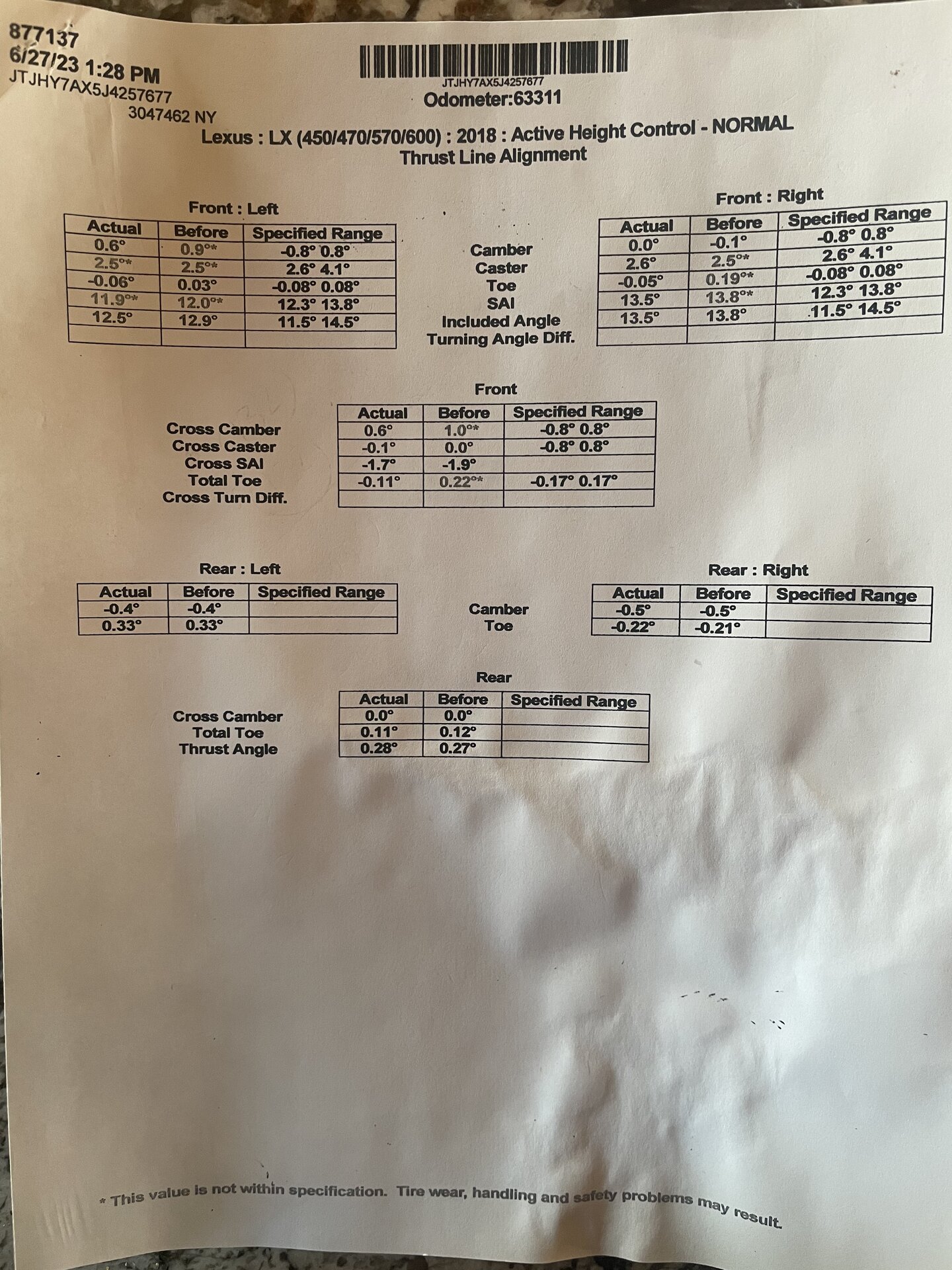

Went for an alignment yesterday and they got the driver side caster to 3.9* but the passenger side LCA cam bolt was frozen and just turning the bushing so they had to take the driver back to match. It has a pretty decent amount of what I would call "bump steer" and did so even when it was completely stock suspension, tires, wheels. My rig did have 3 winters on it in Wisconsin before I got it in 10/21 so thats likely where the seized bolt and corrosion came from. Not really trying to pay a ton to get it perfect, but 2.5* caster kinda sucks.
Anyone else go thru this like @linuxgod ? I might give Slee a call and see what they suggest. Here is what the sheet looked like 3 months ago and now when I went back for better:

Anyone else go thru this like @linuxgod ? I might give Slee a call and see what they suggest. Here is what the sheet looked like 3 months ago and now when I went back for better:View attachment 3442176View attachment 3442177
Cut the cam bolt out and replace it. The replacement bolt is cheap. Figure two hours of labor.
