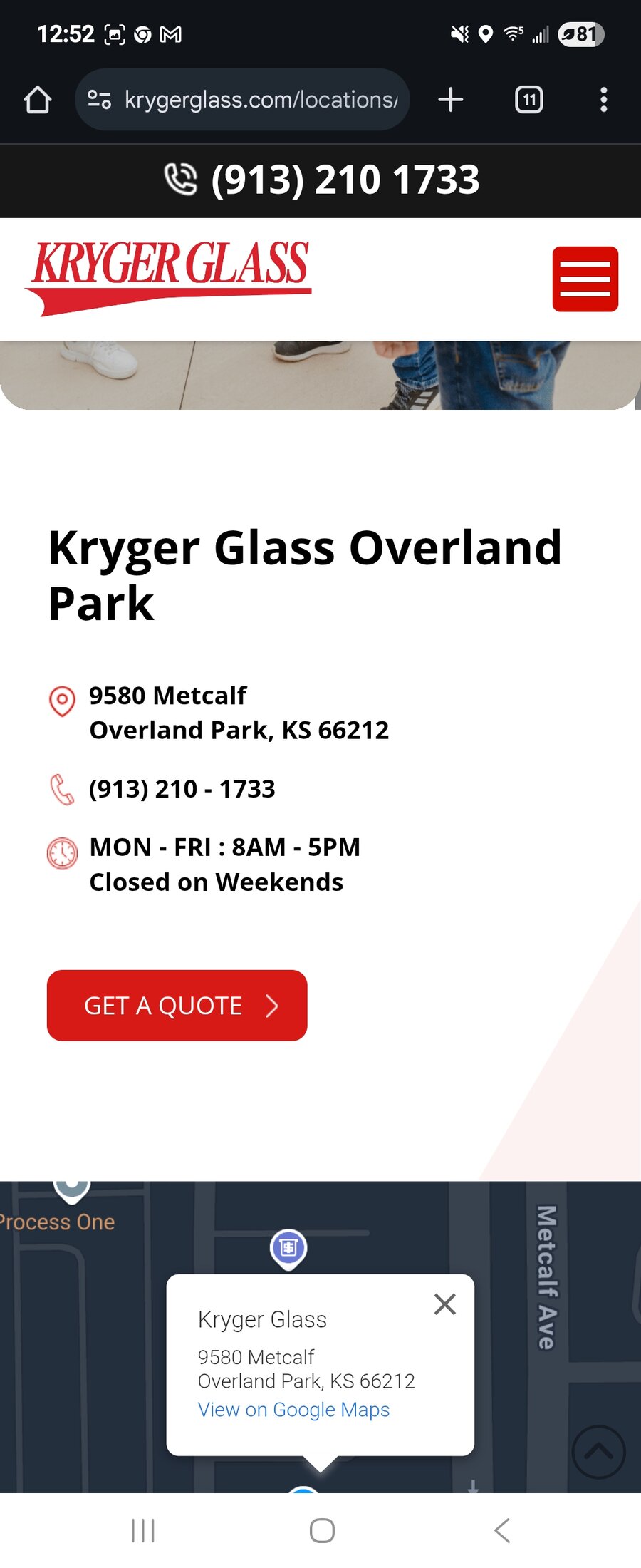

Any recs for proper/knowledgeable 100 series windshield replacement in Kansas City area? Closer to Lenexa the better but happy to travel for the right shop.
I saved this for when I think about replacing my windshield. Double check them though, usually it's one guy with the knowledge and when they leave their experience goes.
I saved this for when I think about replacing my windshield. Double check them though, usually it's one guy with the knowledge and when they leave their experience goes. View attachment 3919361
Talked to Kruger today. Odessey (?) is the manager at the OP location; I played a little dumb and she was able to describe the process and also noted her appreciated for LC owners and the vehicles themselves. Definitely boosted my confidence in going there.
She did recommend bringing new trim pieces as in some cases old ones can get damaged and it’s generally easier for the techs to work with new ones.
Will be scheduling with them asap.
