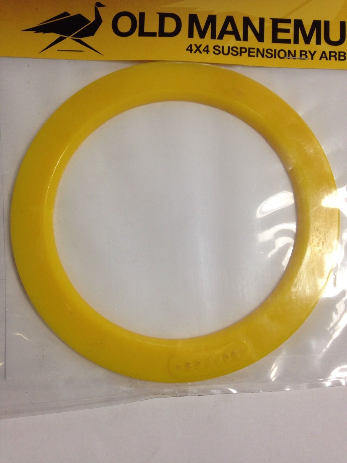

ya it is typical for a Land Cruiser, over time they develop a sag .5" to 1.5" so there is a simple solution . if you have a torsion bar you can adjust that with a main bolt on the side where you have a sag very simple. If you have a coil springs then you need a spacer shim like this one
you measure how much you need to add on the sagging side they usually comes with 5mm, 10mm,15mm,20mm install then on the top of the spring, that is it. just FYI shock have nothing to do with staging it is a coil spring . you can mix then like one side 5mm on the sagging 15mm
