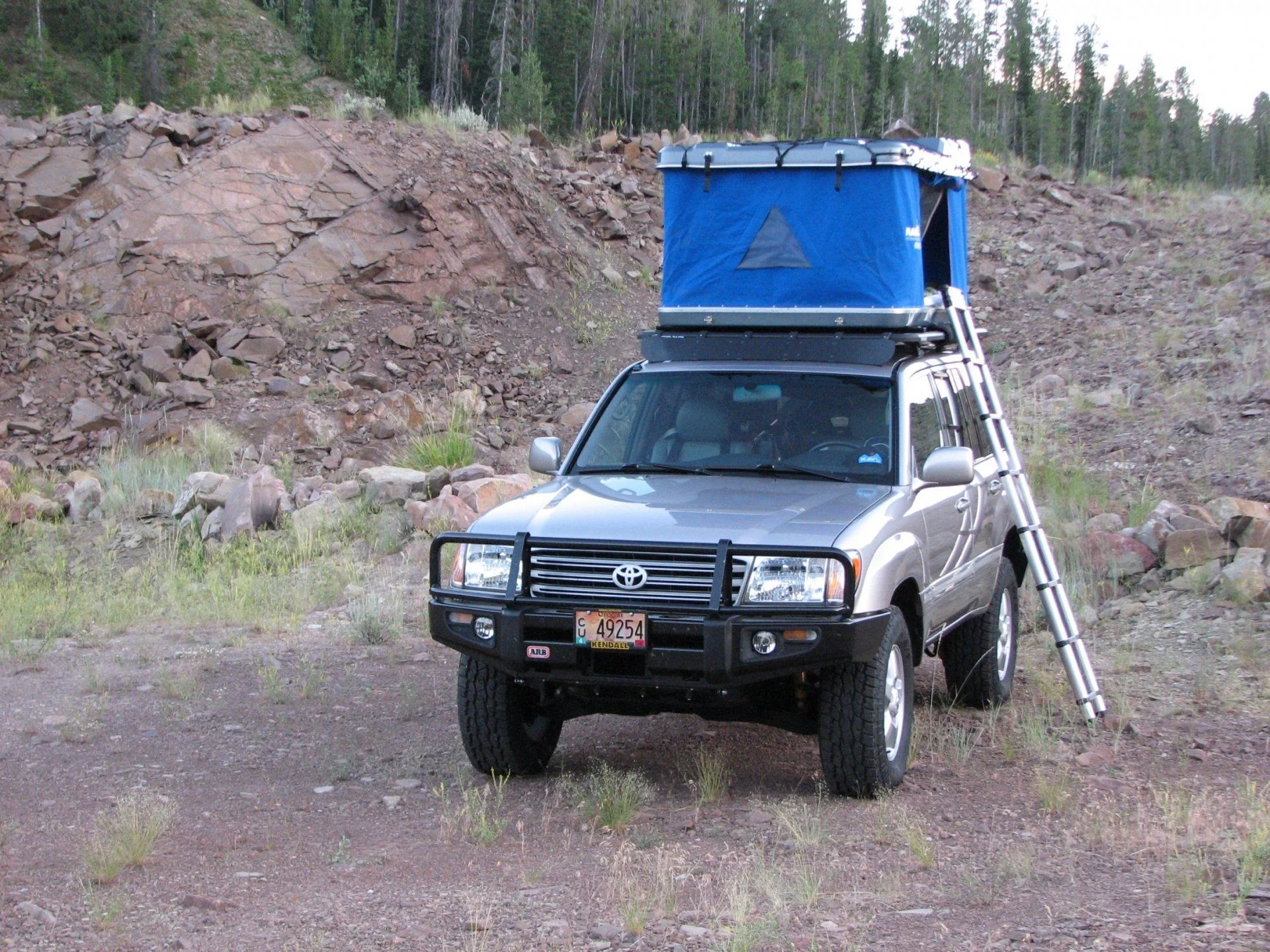

Camping in W Wyoming on my way home after visiting Slee Off-Road for an updoo.
1 1/2 days in their shop installing F/R bumpers and OME 2 1/2" HD suspension kit.
They did an outstanding job and since I was waiting locally went out of their way
to prep everything prior to my arrival so it was done quickly. I was concerned
that drivability would be affected by the HD suspension, but it was fine. Compared to my
previous FJ60 w/OME suspension, the ride was almost luxurious.

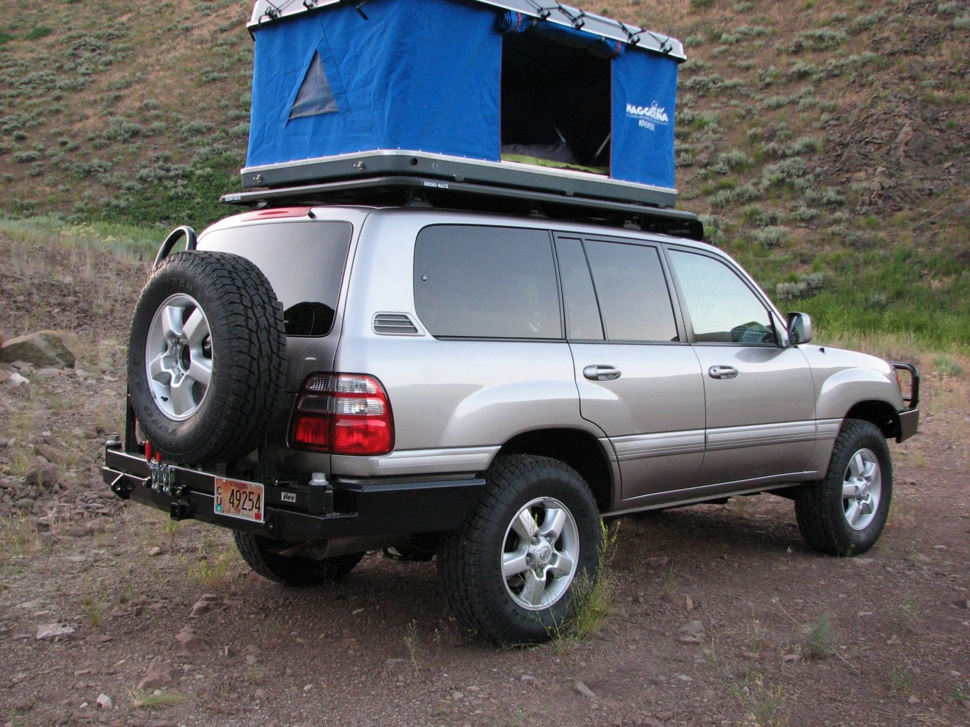

Looks great! I have a silver 06 that I will be putting an ARB front on this weekend! What springs did you end up going with in the rear?
The rear springs are HD OME as part of Slee's 2 1/2" HD kit, including UCAs and their differential drop. They have refined the double swing rear bumper to where the swing outs can be operated with one hand. The fit/finish is 1st class so you get what you pay for. IMHO this is a good
looking and functional setup for a 100 that will not be a rock crawler but more of an all terrain long distance traveller.
