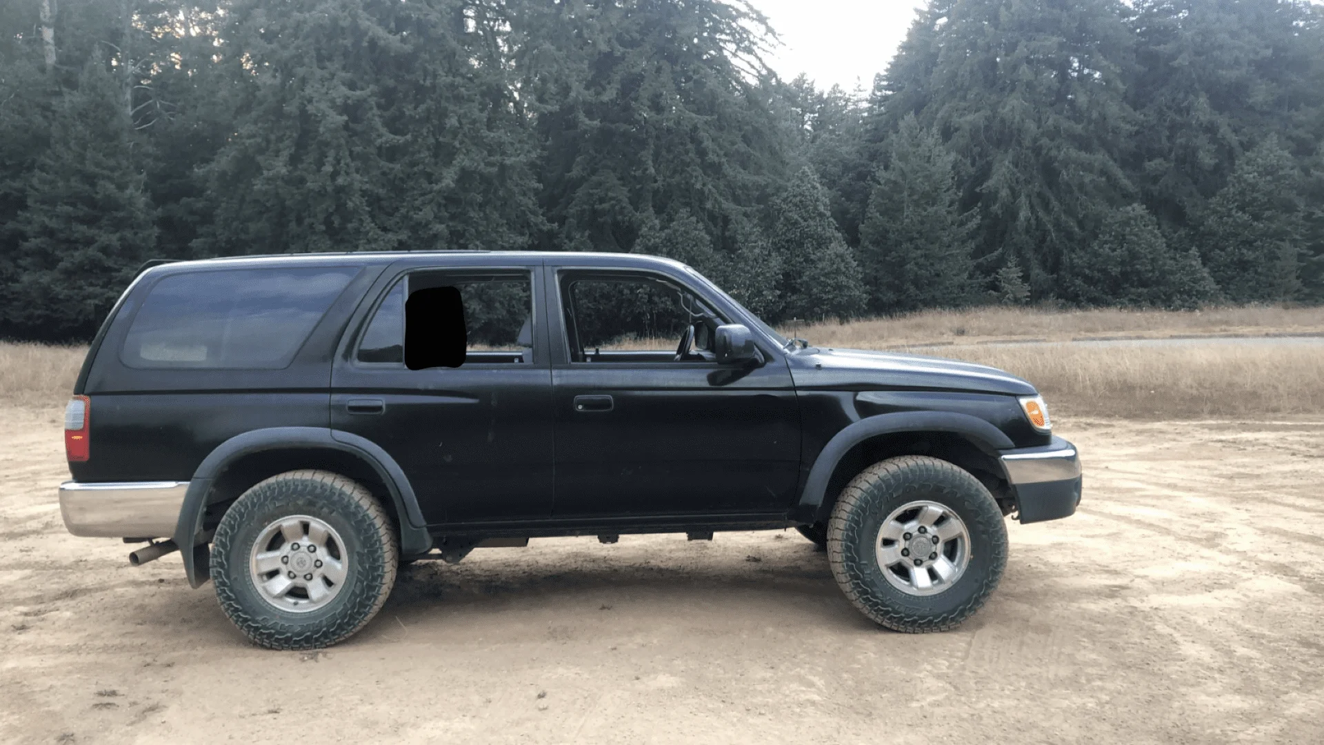

Thank you for the reply and information. Got the Falken Wildpeak A/T3W's on my son's rig and it's looking good!
