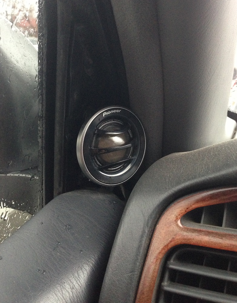

This thing didn't even come close to fitting. I looked briefly at dremeling the wings, but even if everything inside was removed, I don't think it would fit. Anyhow, just a heads up for anyone who wants to try this in the future. They sound good though, even with the stock head unit and amp.
The speakers are Pioneer TS-D1720C.
