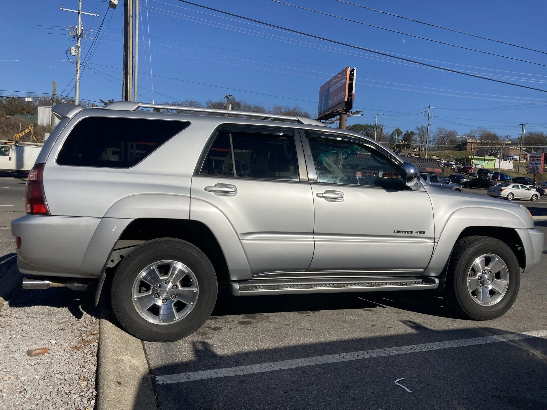

We are excited, we bought our 16-year-old a 2004 Limited 4runner with the V8 and four-wheel-drive. The truck needs new tires. I am going to for now keep the truck mostly stock, or he is rather, but I would like to put a little bit more meat on the bones.
What is a comfortable “next size up” size tire people are running with stock suspension?
