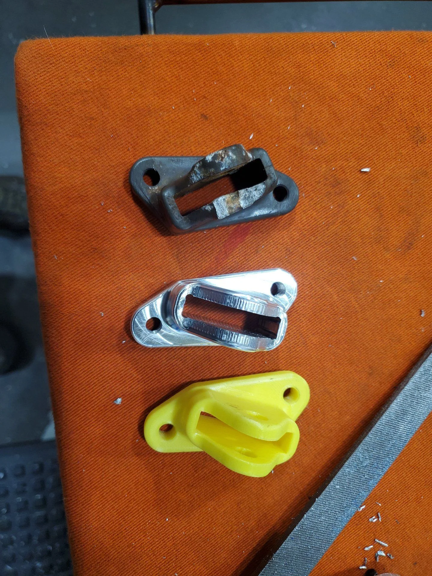

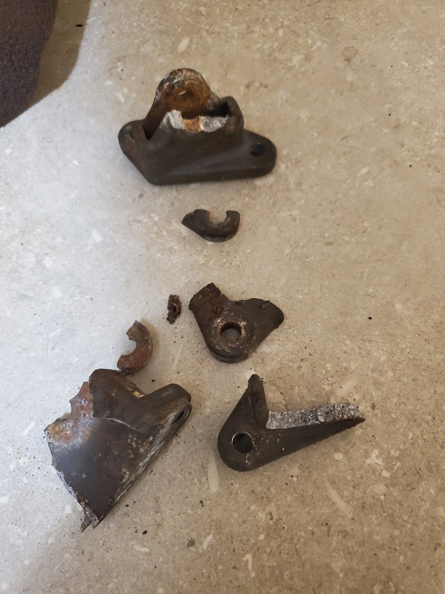

I managed to find and pick up a factory rear axle with the factory locker for my 1990 LJ78.

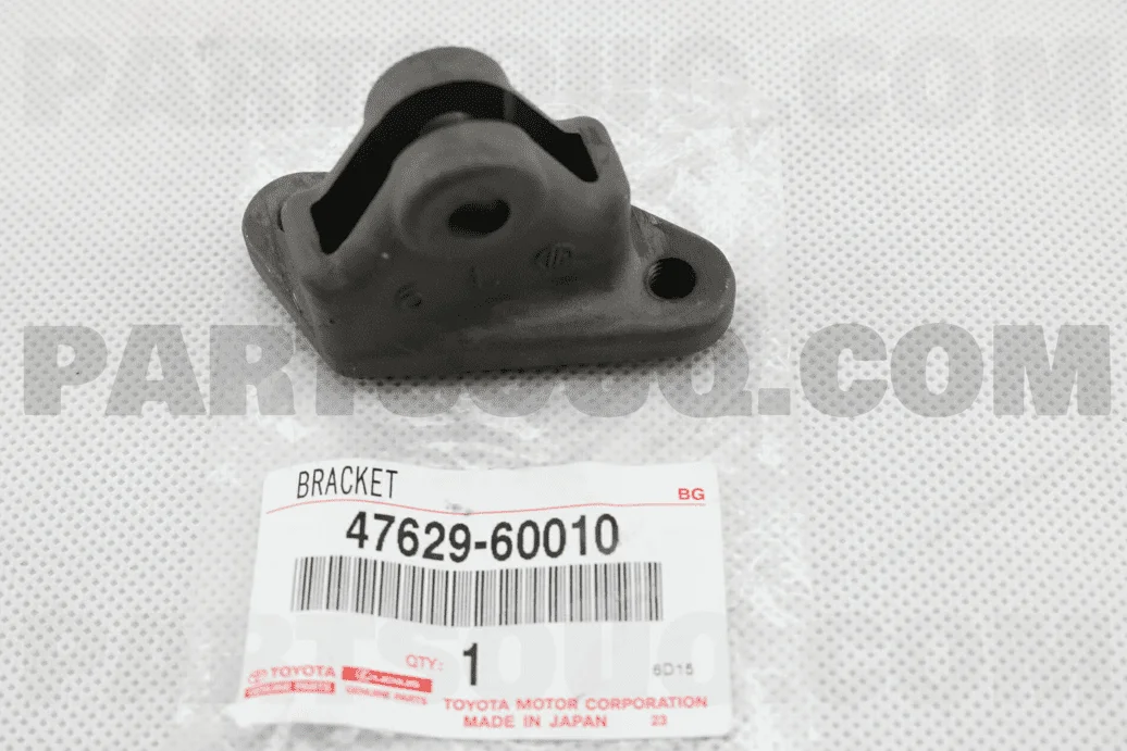

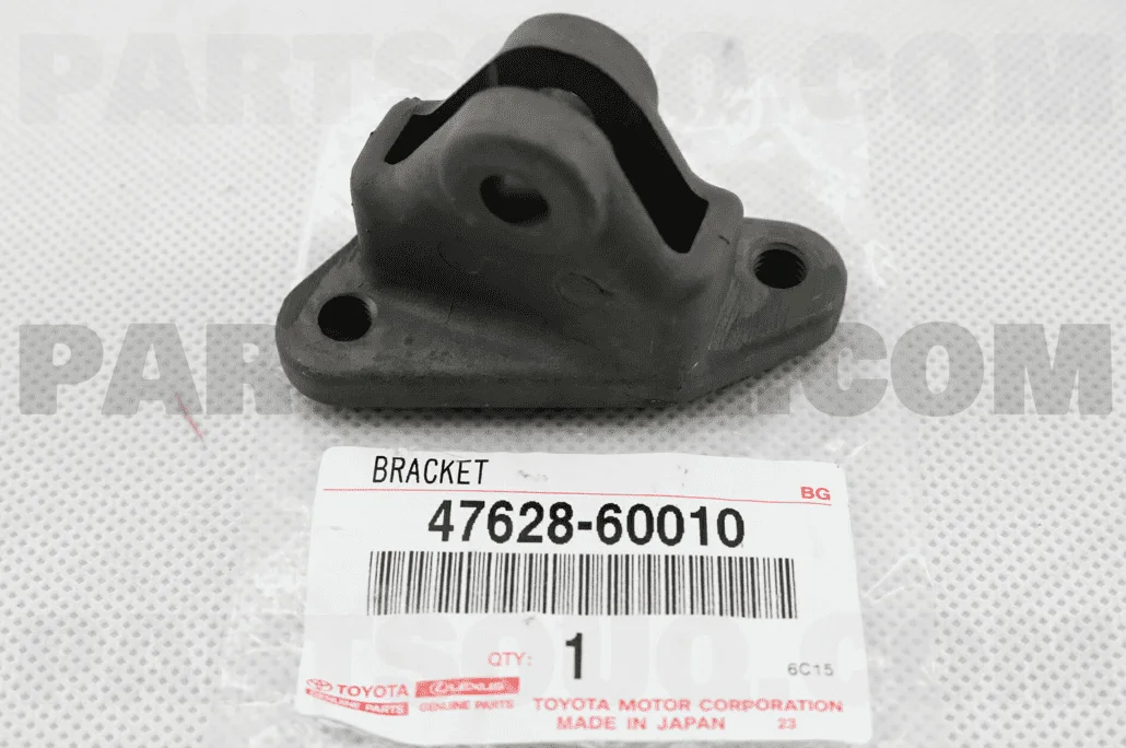

Taking it apart I noticed the brake bell cranks were both broken. I quickly looked up the part number (47629-60010) and (47628-60010) Left and right side. Found a person on EBAY selling them (search the part numbers) but they got back to me saying it was going to be a long time for shipping unless I wanted to pay for very expensive shipping.
That didn't fly with me so I modeled up the brackets and 3d printed them for fitment. They bolted up great and then I made them up at my work on a Saturday.
Made them out of 6061 aluminum. Just wondering if anyone else needs these or if I can get enough interest, I can see if my work would do a run of them and we could sell them.
