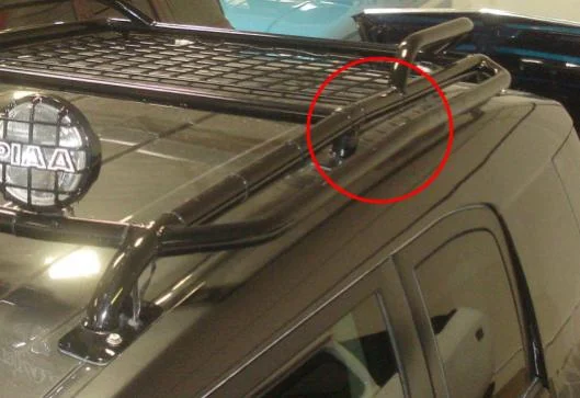

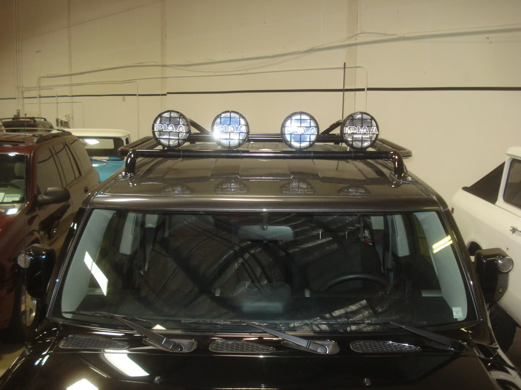

This is a one off at the moment. Take a look see. Again feedback appreciated.
Not bad, but just curious as to why not have the mesh support the entire length?
Pretty good looking. I like that it has similar lines to the OEM roof rack, and the extra rub rail at the roof line. I'd add a center support of that outer rail right where the center roof bracket is too.
The idea is to allow some flex and for the rail to absorb and spread that tension throughout the rack. If you put that brace there and lean it into a tree or whatever it would put more stress on the roof. However point is taken and we could add supports there if thats what the customer wanted.
