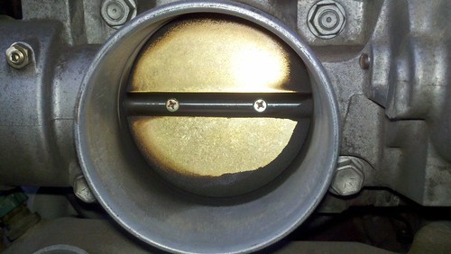

I would start with a new air filter and cleaning of the MAF and TB. Make sure to disconnect the battery and after you are finished, start the truck and let it idle for 15 minutes so that it can baseline itself. Doesn't cost much and if does not fix the issue you didn't really waste any time or money as these are great things to do at any time. If that doesn't fix it, perhaps you are due for some new front O2 sensors.
You haven't disconnected the battery lately have you? If so, the ECU needs to go through a few start cycles before it's happy again.
What pfran said. MAF and TB.
