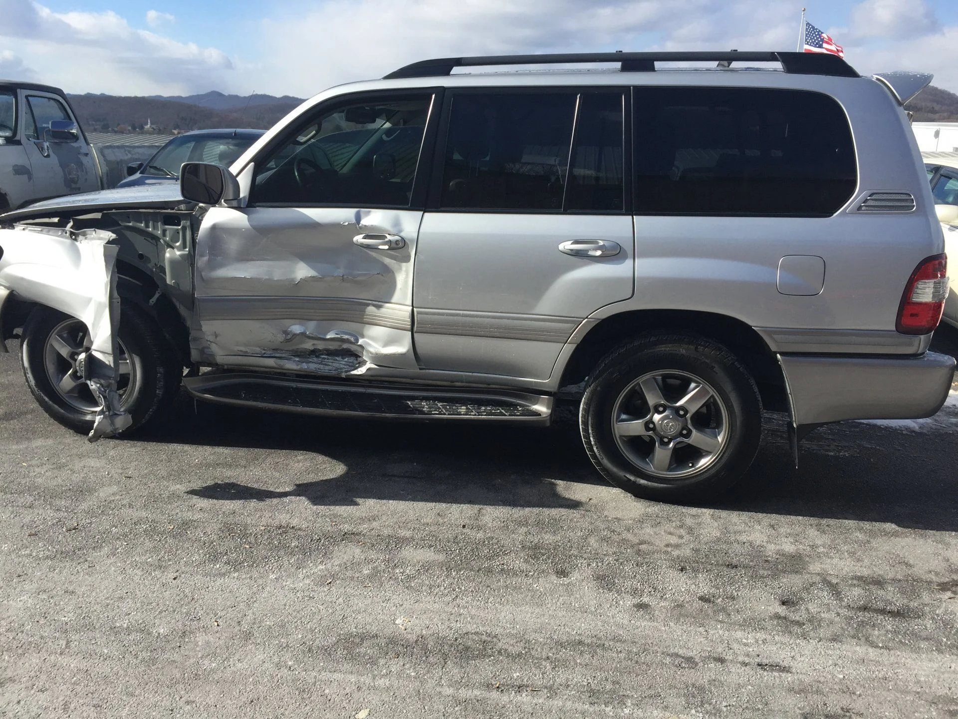

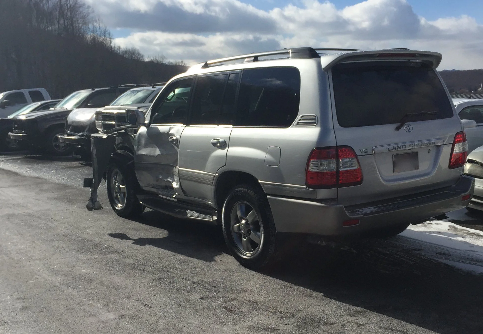

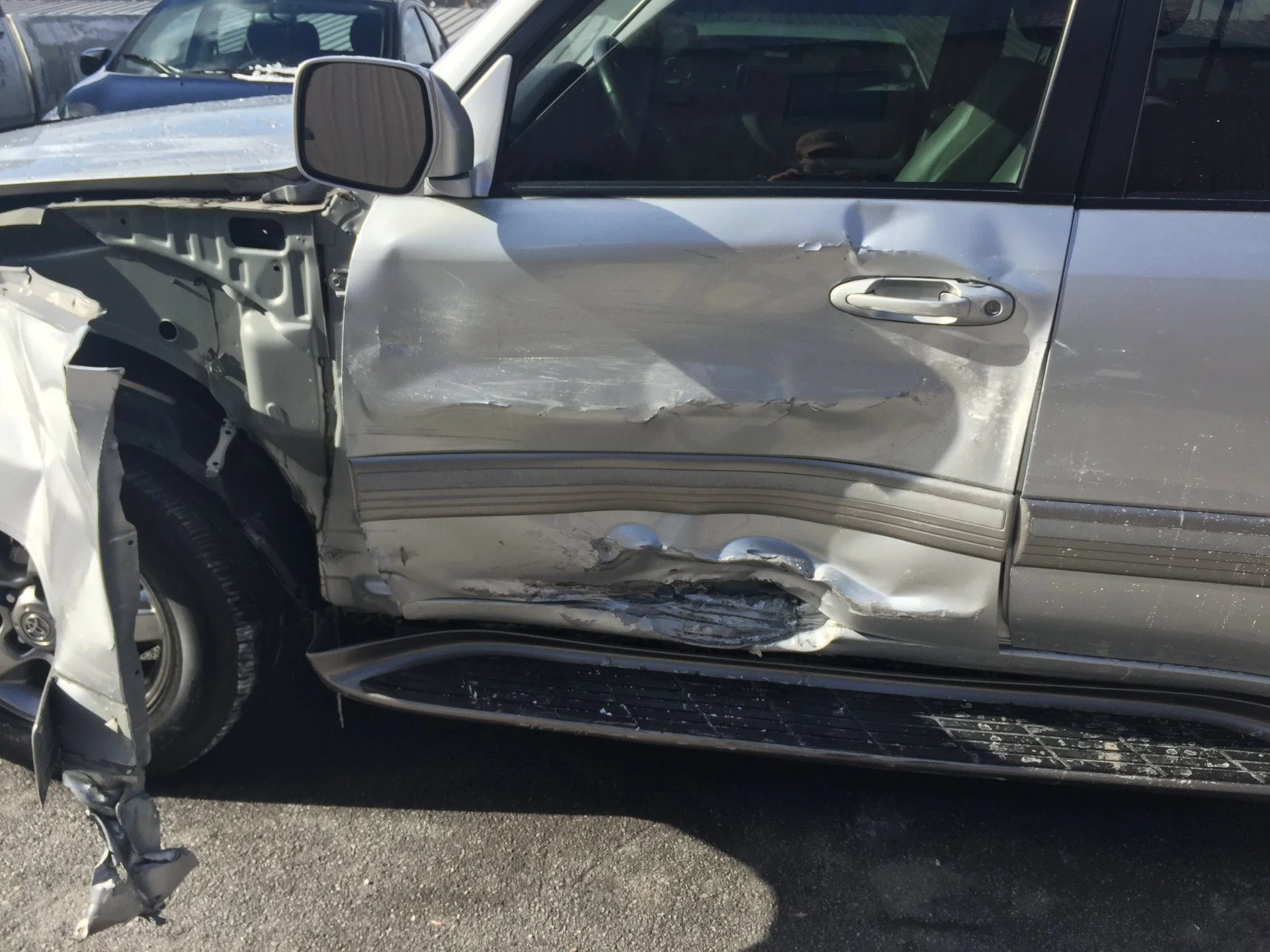

My 2007 Land Cruiser, all orginal with 77,xxx miles, was hit in the driver's side by a H3 Hummer. The repair shop replaced these major parts: driver door, the frame that the driver's door attaches to, front fender, front rim, and carpet. Once I got the L.C., back I was able to drive straight with the steering wheel turned half way around. It pulled to the left hard under acceleration and the steering wheel had vibration. If not accelerating, it had a slight pull to the left. The insurance said to take the L.C. to the Toyota service department. They found and replaced a leaking rack and pinion and did an alignment. The L.C. still pulled to the left under acceleration, but I was no longer able to drive straight with the steering wheel turned half way around (that was fixed!). The Toyota service department then replaced the driver side knuckle and upper control arm and found that the tire that was on the new rim had broken belts. The insurance agreed to replace it and the front passanger tire. (All four tires prior to the accident only had 4,xxx miles.) All four tires were road forced balanced and another alignment was done. Once I got it back, it still had the same pull to the left and vibration in the steering wheel. The insurance got the body shop to recheck and frame specs and it still checked out, no frame damage. Now the body shop thinks a custom alignment would fix it? I do want to have trade it or the insurance total it. Any help would be appreciated.

How fast were the vehicles going?

It was a hard hit, the Hummer was going at least 45-50 mph. The front tow hooks on the Hummer is what did most of the damage, they are like battering rams! One ripped through the drivers door and the other one hit between the rim and tire, breaking part of the rim off. The tire kept pressure and did not go flat.
