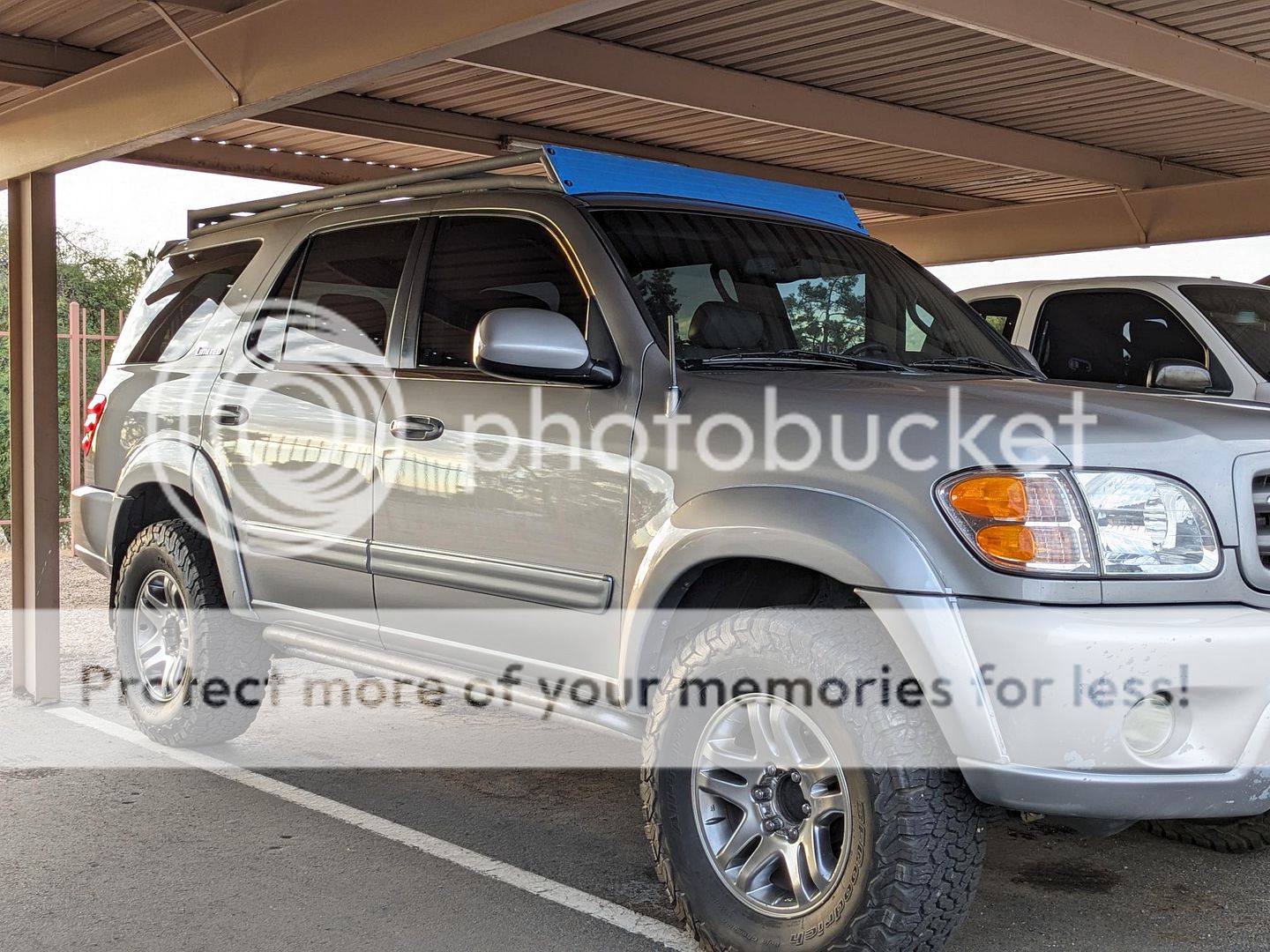

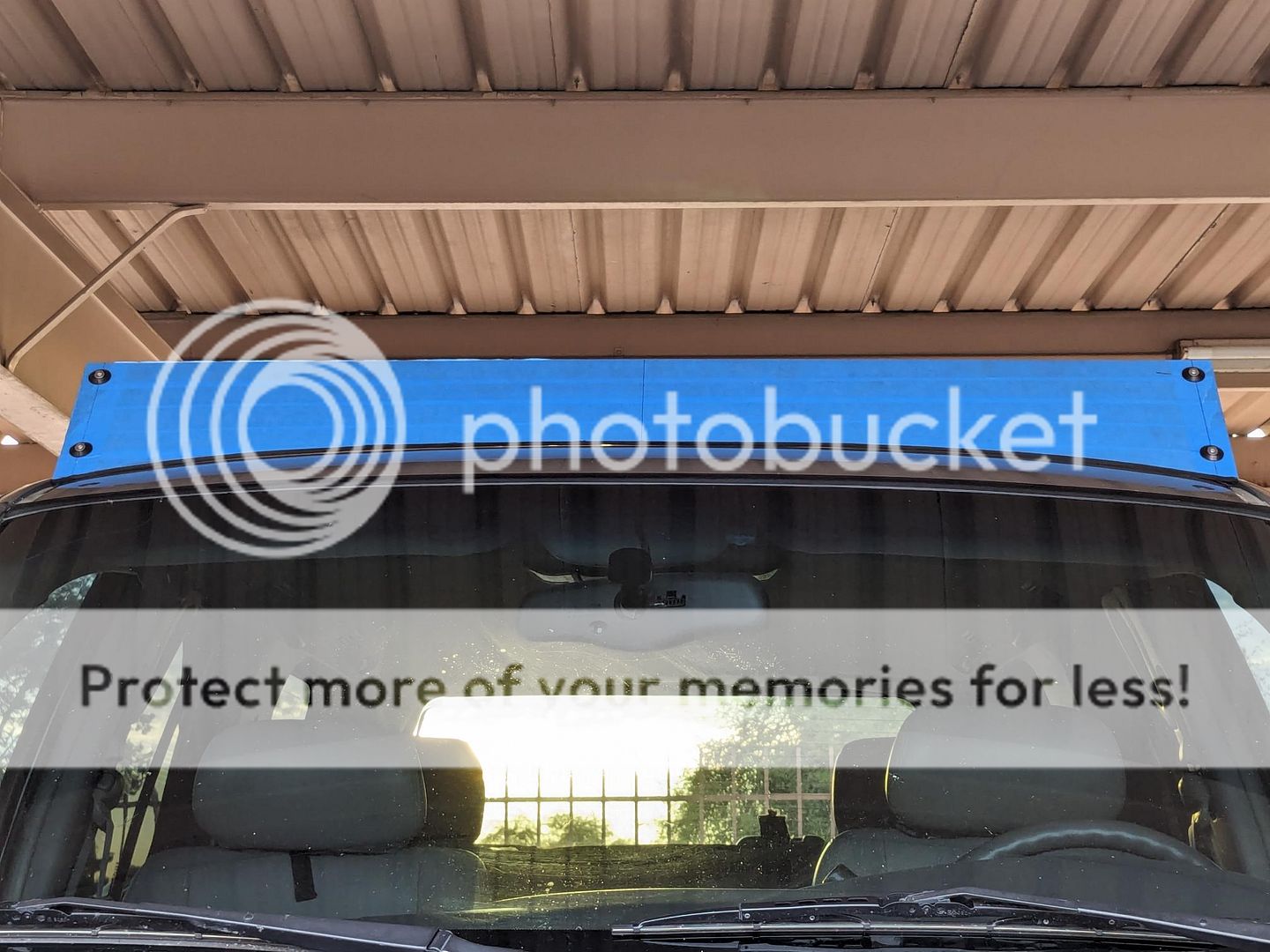

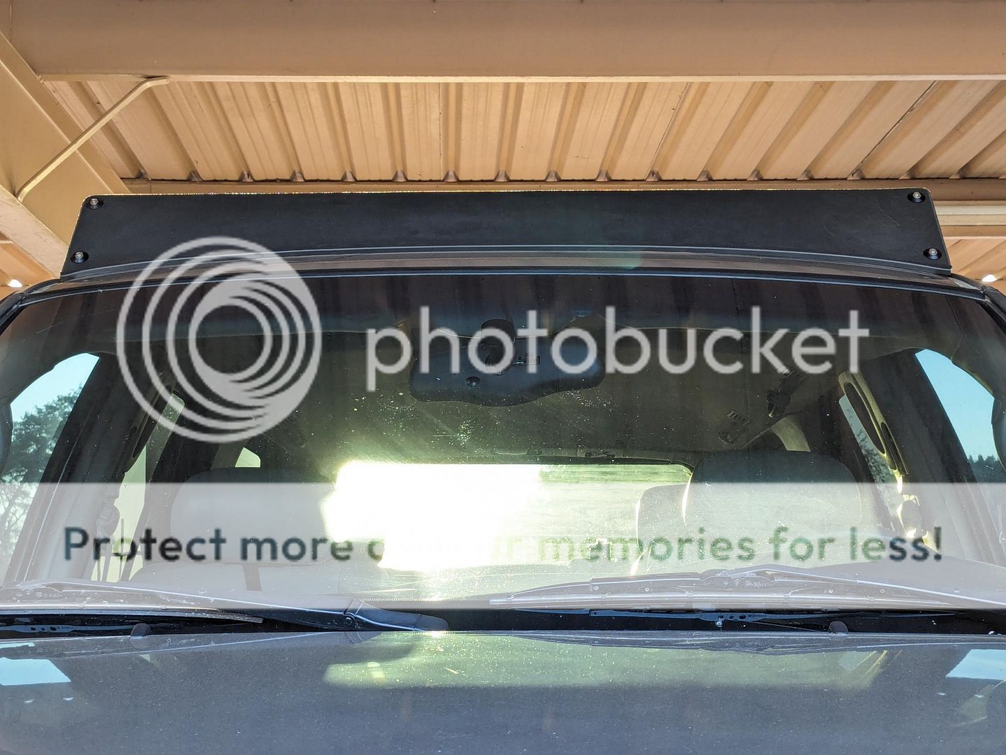

I made the wind valance out of 1/4" King Starboard. It's a plastic material made for boat finishing. Like hatches and dashes and cutting boards. Things like that. It's either HDPE or like HDPE. Unfortunately, it was either buy a whole sheet for $100 or have a custom cut panel made by Boat Outfitters out of FL. It was $52 shipped for a piece of 8"x50" black King Starboard. Kind of a ball kick but WOTEVER.

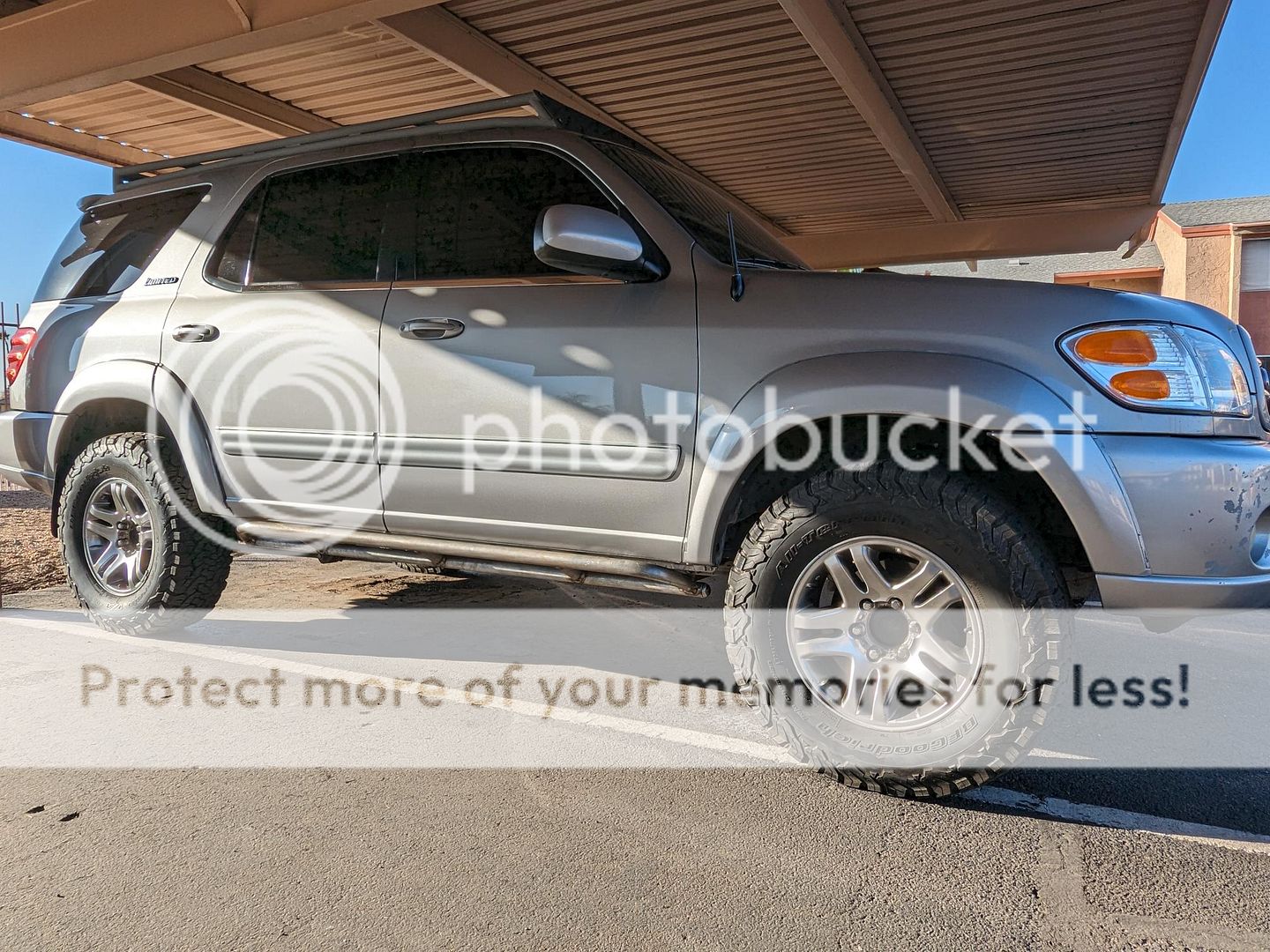

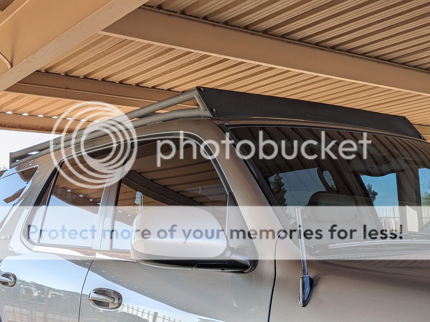

Overall I think I have like $220 into this roof rack. Beats the hell out of spending $1200 for some bro-licious SHERPA BRO. I like the looks of the Sherpa but I didn't want to risk having some Toyota bro play with my butthole while I'm in camp sleeping. Plus, tube work just says off road. Again, I didn't want to risk sending the wrong signals. I like women.

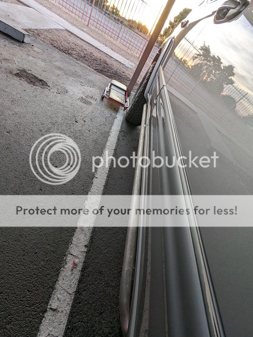

The ASTUTE viewer might have seen the "in progress" rock sliders in the picture above.
After tightening down the allen screws to "really tight" it has bowed out the valance a little bit so you can see light under the center portion but this is actually ok because I have rubber trim coming from Amazon. That will clean that gap up and the rubber trim will protect the paint from any chaffing if there is any.

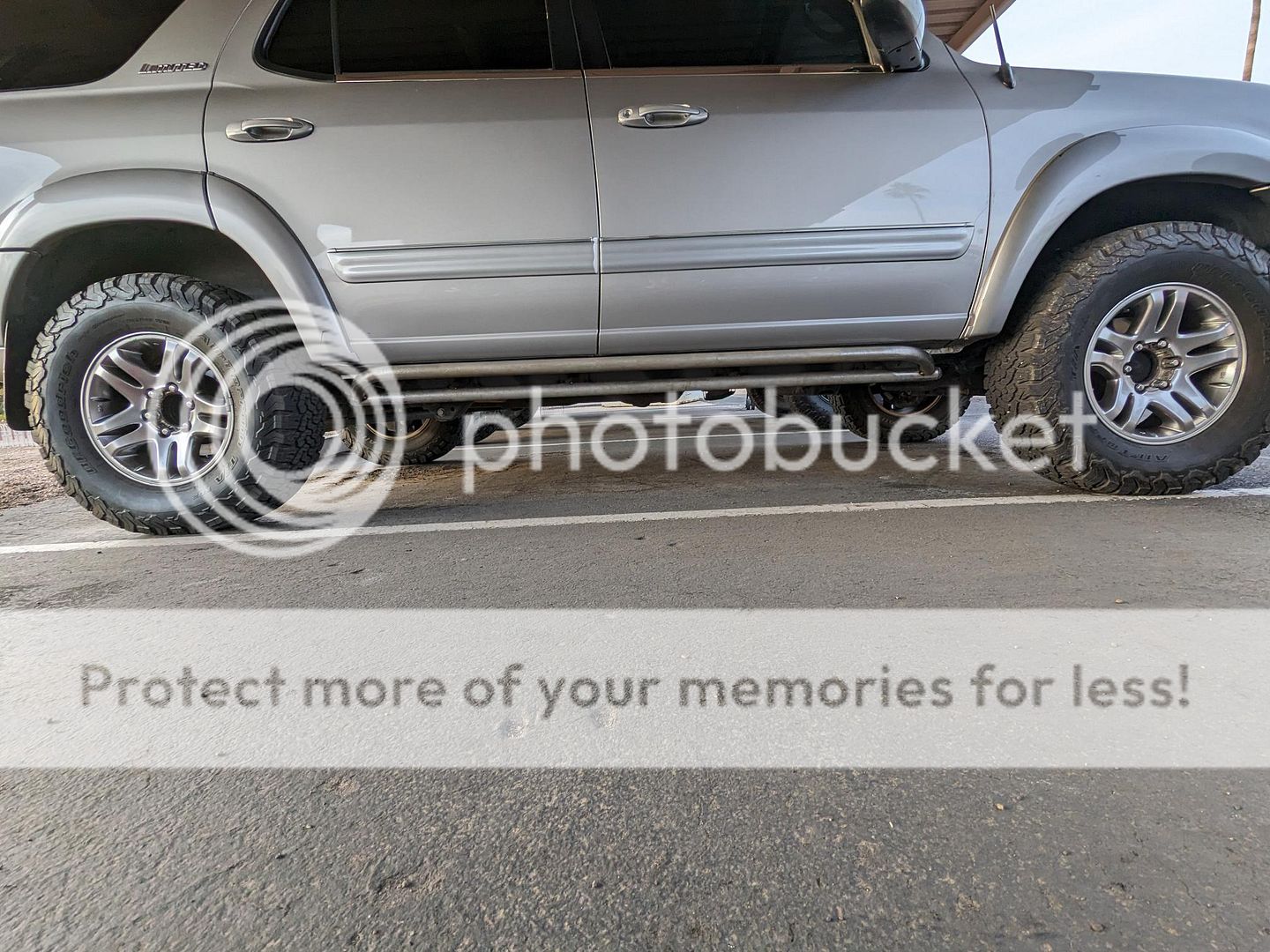

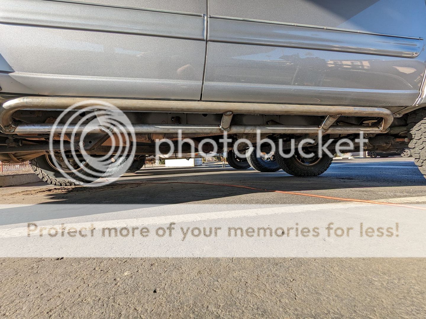

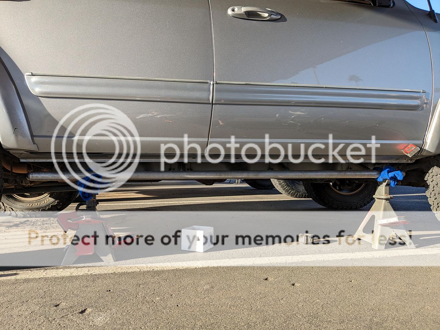

So for the last few days until yesterday I was working on the rock sliders. I'm pretty anal. I have a really specific look that I'm going for. Aesthetics is almost as or more important for me than functionality. For rock sliders at least. Aside from a specific look that I'm going for, I'm handicap and I hate having anything considerable outside of the kick panel because it makes it harder for me to get it in and out of the truck. The factory side steps were a pain in the ass. I'm partially paralyzed below the waist and 100% paralyzed from knee down so when I stand I don't really have much motor skill. It's one other thing that was in the way of lifting my leg up in there plus the truck looks better without the stupid factory side steps anyways. So when it was time to make sliders I knew I didn't want the normal side step style that sticks way out. I also like the style that allows the slider to kick upwards and not just straight out on the outside tube.

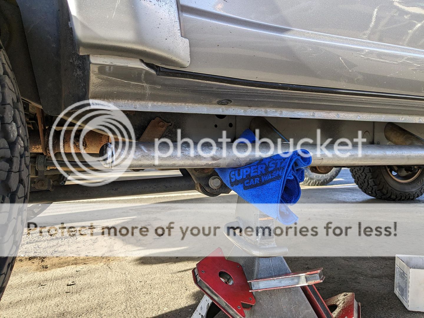

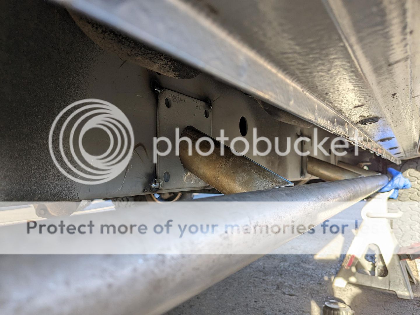

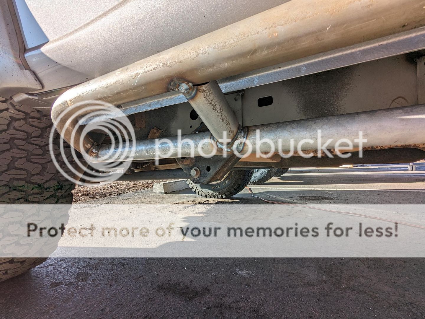

This is what I have settled on. They are weld on sliders because I do it right, not twice. Because I used to do things twice... lol Plus, grade 8 hardware would be an additional $50 with prices where they are right now. I already had 20 feet of 1.75x.120 DOM leftover from my Tacoma roll cage project. I decided to go with DOM because I didn't have any other use for this leftover and because DOM brings all the BOYS to the YARD.
The main tube sits about 1/2 lower than the frame to give the upkick look for the secondary (outside tube). I don't think this should be an issue at all because there are 4 things that are lower than the frame/main tube of the slider. The gas tank. Lower link pivots, T-Case, Trans X member. Regardless, this rig is likely to never see a situation where the slider actually touches a rock... lol I mean maybe. But these will be 100% fine. I know the kick out before the rear tire is needed to pivot the rig around a rock on a tight trail but for right now I want looks over form to some extent.

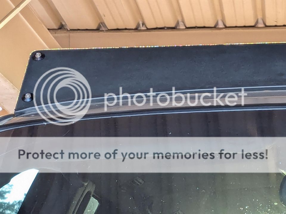

I got the rubber door trim from Amazon today and threw it on real quick. I was also able to get the bow out of the wind valance so now it sits like it should with no gap. The rubber trim makes it look more finished and now there's no gap between the roof and the bottom of the valance. Looks good.
I also got the P Side slider wrapped up. I welded as much as I could with it on the truck. I'll cut the tacks and remove the unit to finish welding the tops of the outside tubes just below the door seals. I also need to completely weld the frame overlay plates. Starting the D side tomorrow. Hoping to get main tube and 4 outriggers cut and notched. Frame needs to be cleaned for the frame overlay plates as well. Trying to wrap these sliders up by early next week. Next up after this is the rear hatch ladder...
This whole build is amazing. Your design, fab and welding on the sliders and rack is top notch. I don't know how you find the time to do so much, but it is inspiring.
I'll certainly be following for updates.

Thank you! I was hoping the roof rack turned out pretty good. I think it has the Prinsu or Sherpa look but with tube. I have the bender, I had some extra tube laying waste for the last two years in the backyard... I figured give this a shot. I've searched the hell out of the internet and don't really see too many, if any tube structure roof racks. Or at least any that look any good. Lot's of the old "tub" style. The sliders I basically copied other designs I've seen on Jeeps and other "custom" off road trucks.

the sliders are a great design. i like how flush they are.
Keep up the good work!
Thank you! I do too. This is not a rock crawling rig so I wanted something that was going to function but also be sleek and look good. I think they came out well. Hopefully will be done tomorrow.

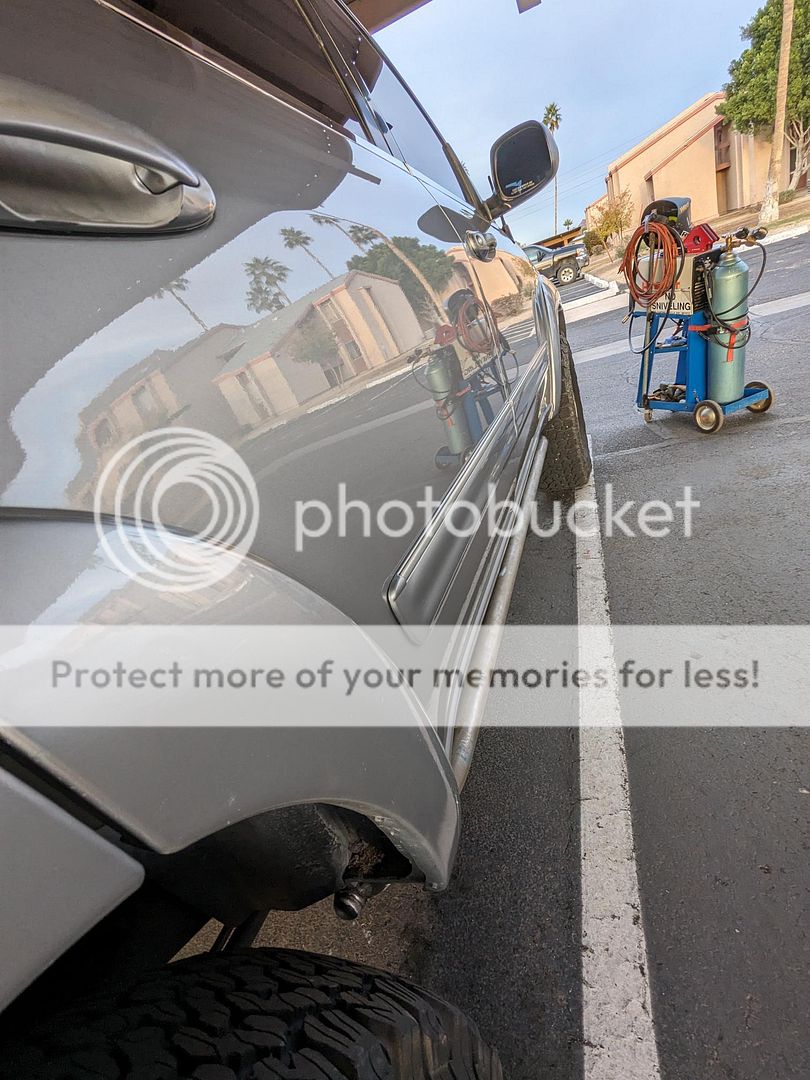

Parking lot fab pro here. If you check out my Dezert Rangers page for my truck, I did a Score legal cage in my Tacoma out there and it took about a year. And yea, all out of the wheelchair. I get around pretty well but the biggest pain in the ass is getting everything out there and then back inside everyday vs. having a garage. When you're done for the evening you shut the garage or shop and go inside. You don't have to clean up and take everything back inside. The prep and take down of the days work takes the most amount of time and energy but it's what I have so I make it work. I'm TYPE A
