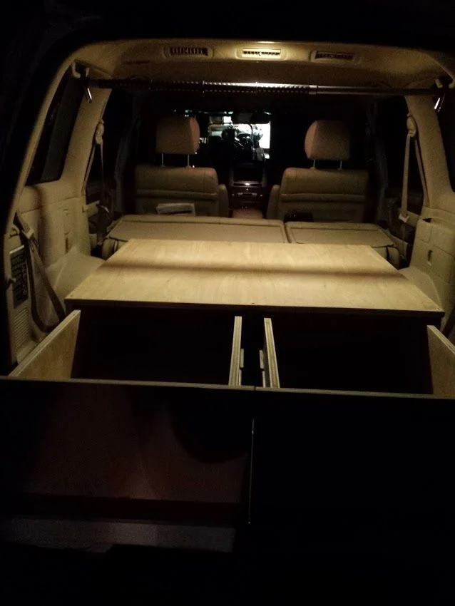

I can tell you that the materials alone for the drawers I built in my 100 were almost half the cost of the kiss. My carpentry skills are lacking and I really need to redo them after they've rattled themselves loose from the weight of the fridge/slide that pulled up the side and I tore off the right drawer face. I'm going to pull it apart, lower the fridge and reassemble with tons of glue and screws.
I would have bought the kiss drawers had they been available two years ago.

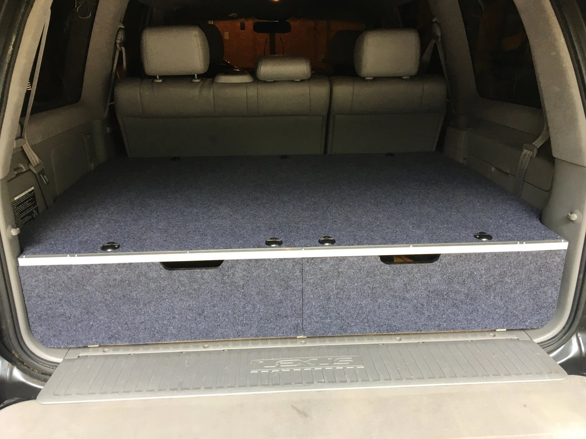

I have the KISS Drawers. Very happy with them. Easy to assemble, easy to customize, don't even know they're back there. No rattles, squeaks, etc. Stained the wood black and covered in speaker carpet to match interior. Used piano hinges for the wings, but in hindsight would use hidden hinges if I were to do it again. The carpet is getting worn around the piano hinges. I might take apart and re-do at some point, but that's pretty low on the list of priorities.
Absolutely. Not something you'd want to do every day, but with the drawers removed it's fairly easy to get the frame in and out. With the wings in the "up" position (if you connect the wings), you still need to tilt the frame a little to get it through the rear opening. They're pretty lightweight due to the extruded aluminum frame. Just unwieldy due to size and shape.
