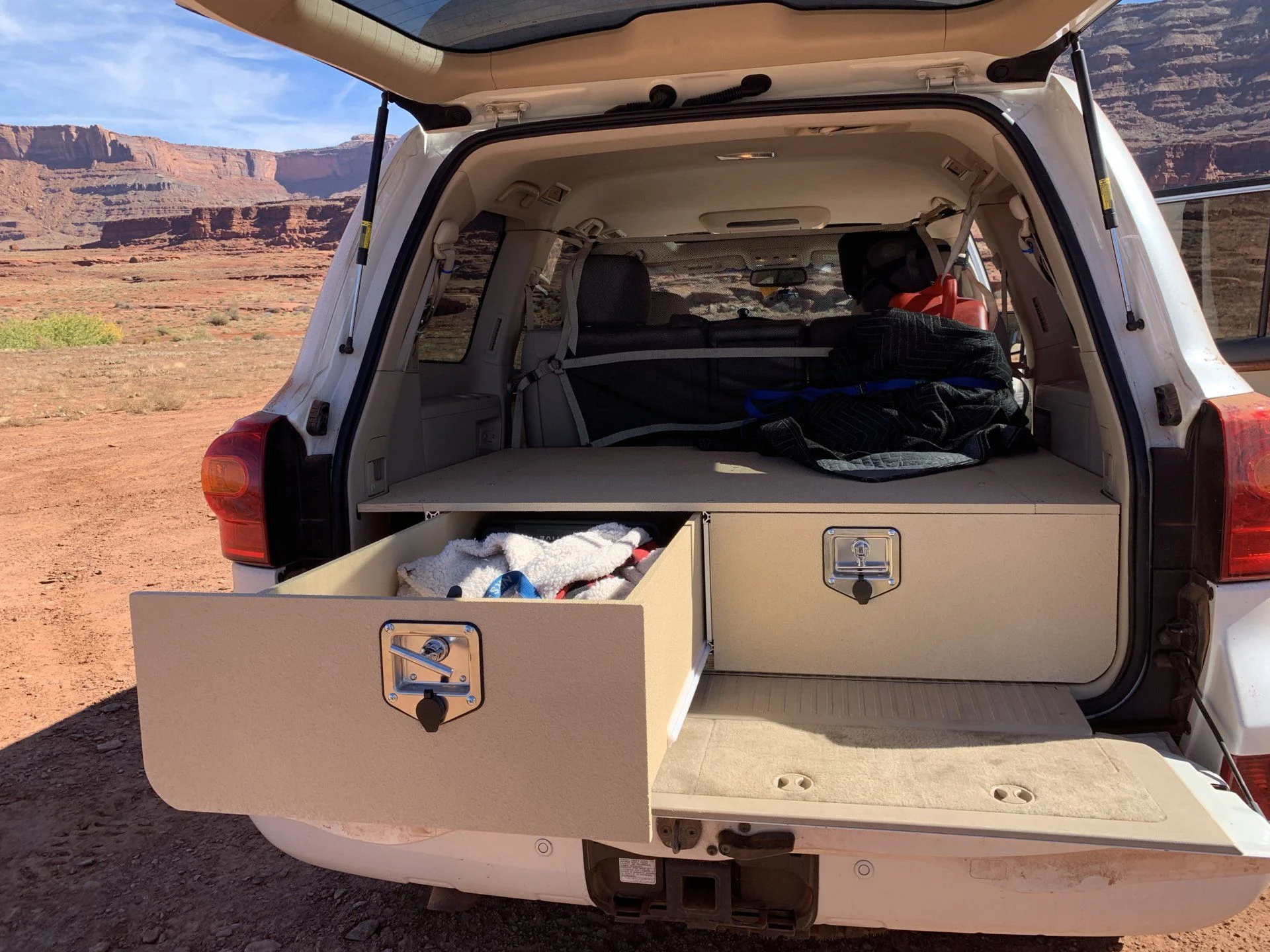

Installed drawers with T-handles and sprayed with U-pol Raptor liner tinted with Monstaliner color pigment.
Still need to add three Macs Versatie tie down tracks and a front chrome 90 trim moulding piece, but they turned out great. Thanks @cruzerDave!

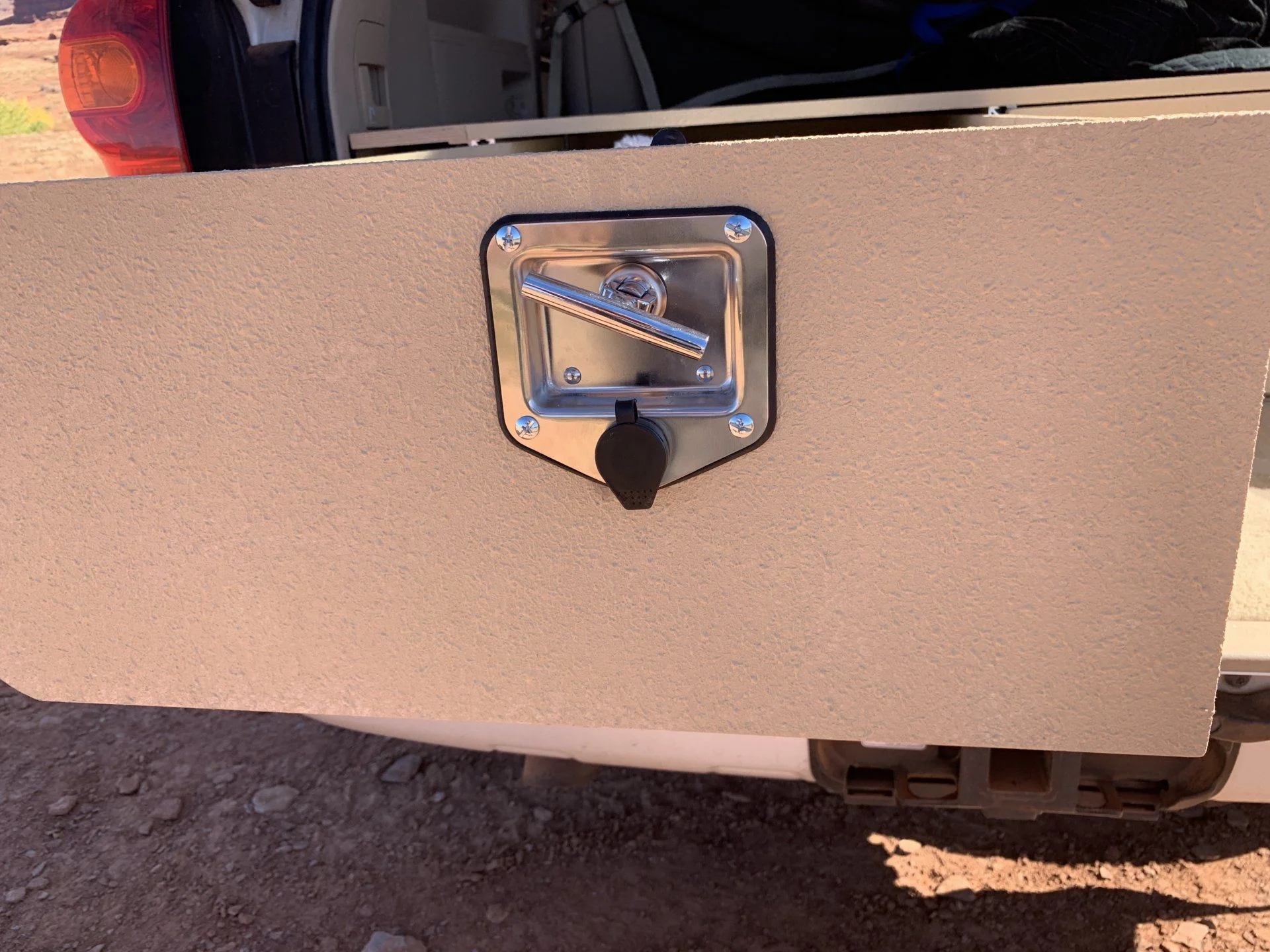

Looks great Jexx, for the T-handle locks, did you notch an opening underneath the drawer tops for the cylinder to slide into?

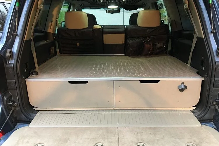

Still no test mule but I want to hash out two things here that anyone interested with a tape measure can do, plus a little community debate...
1) width between fenders. It sounds like current setup is a titch too wide, but can we get a few numbers from a few different years to confirm that they are the same, and what the smallest point between them is?
2) This is where the community debate kicks in - sleeping height. I sized the current setup to be the perfect height for the 100 series, which fold almost flat. The 80 seats keep a healthy angle so you really need either a whole dedicated platform or (the simple way) a foam or air mattress to help level it out. But I have no idea on the 200s- if a few people could take pictures of their seats folded, how high the rear of the seat is and the front, maybe even with a straight edge or t-square to help us all visualize, it would be great.
If we see a slant to the seats the question then becomes how we deal with it - taller drawers (lower headroom when sleeping) vs extra padding on the drawers, sloping up to the top of the seats (a bit of an angle then)?
