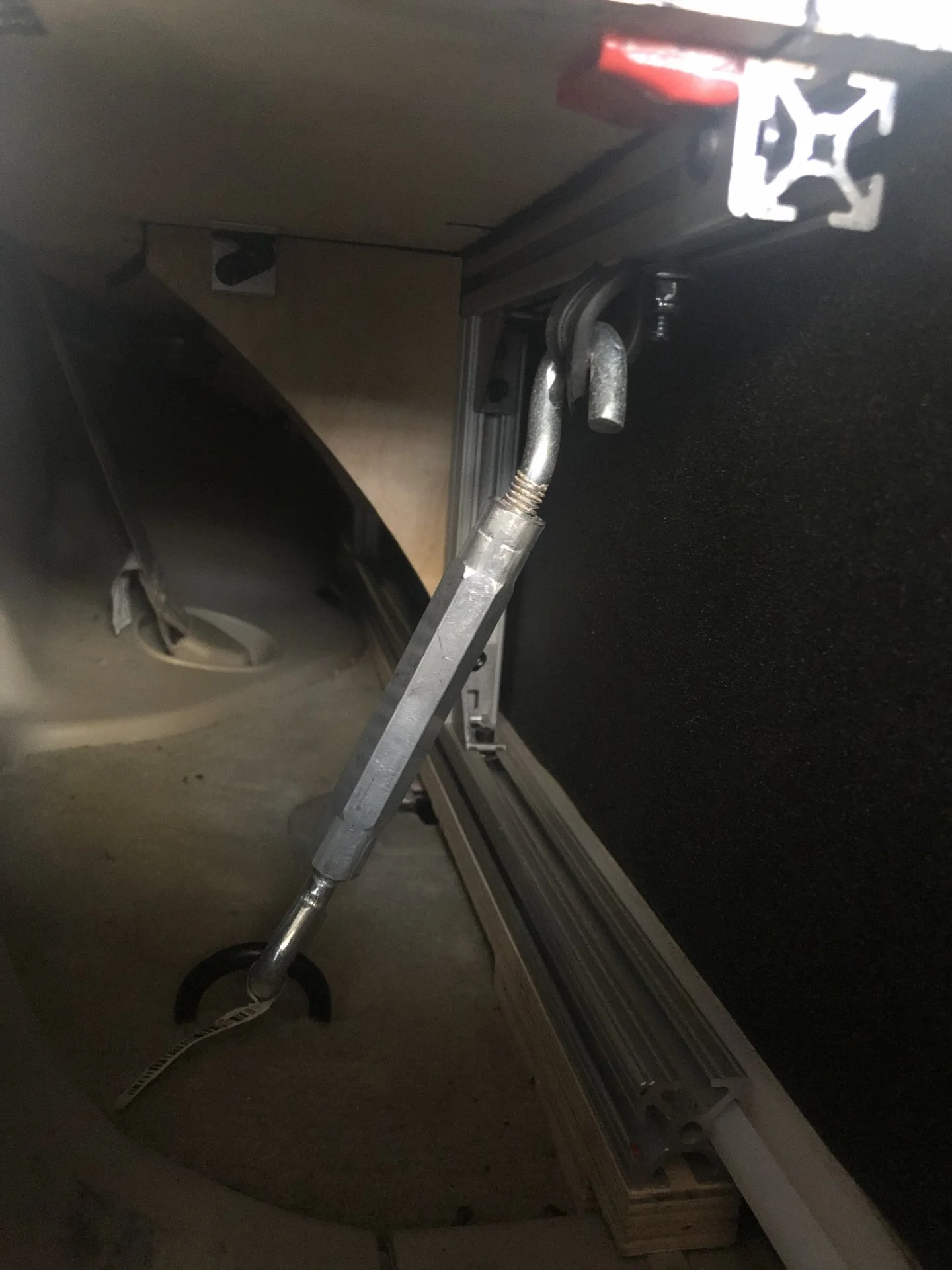

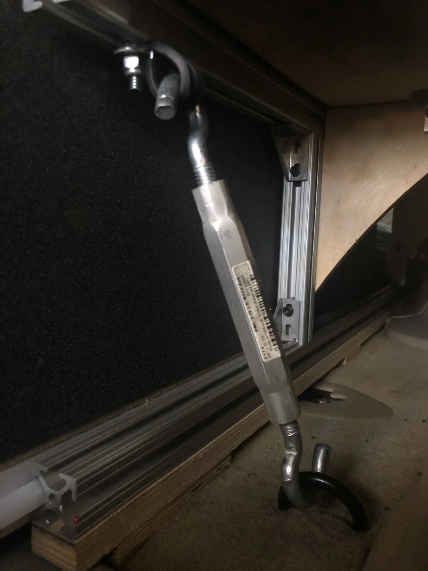

Hi all, doesn’t seem anyone have the instructions for the drawers?
I picked up a set and trying to figure out how to bolt it down.
Thanks!
Thanks!
It took me while to dig this out, but this what I had for mine; don't know if you have the same gen.
Thank you!!
I think mine is a different gen but this will be helpful
He is some other info on mounting that member @4gotalot send me back 5 years ago:
The main problem we need to address is to keep the aluminum tracks strait so the slides make even contact from one end to the other.
If you pull both drawers and look at the frame you will see that there are only four points of contact which are the 3rd row seat anchors that we use U bolts to hold the entire frame down. They are located in the middle of each cross member. Now add weight on top of the platform and you will see the aluminum tracks bowing under the load.
The tension on the U bolts can be over tightened but this is not the main problem. The problem is that there is limited locations in the 200 to keep a square frame square
As a basic description as you look at the frame is that we need three points of support on each track to keep it strait under load. Each support needs to make contact with the metal floor under the carpet and the wood frame. I used a 36" level as a strait edge and only a strait edge to see the aluminum track bowing. The support blocks I installed were only about 1" x 1" and what ever thickness needed per that location. I used a Wonder Bar for more leverage to lift and ck each block as I checked with the strait edge. My tracks were only off by about 1/16 at rest with no load but were worse with a big 100 pound lab laying down on the top of the platform.
Left and right track guides: The aft end closest to the tailgate seem to have good support as it rests on the lip of the plastic trim going from side to side so the aft end is your starting point and no adjust needs to be made there.
There is a location about a 1/4 of the way fwd were there is no carpet and a block can be inserted to support as close to mid way on the track as possible.
The same goes for the the front of the left and right tracks. There should be just enough pressure on each block to keep it in place. I did not use any glue.
The center aluminum track is the only problem because there is carpet under the ply wood frame and I used a stack of door frame shims to distribute the load on the carpet until I remove the frame, cut a hole in the carpet and add a block mid way and at the front of the center track.
I checked the drawers for square and reinstalled the nylon runners about an 1/8"-1/4" back on one side and fwd on the side so the nails had new wood to go into. The thin piece of trim that I installed with counter sunk screws every 4 inches will now hold the load instead of just the nails.
