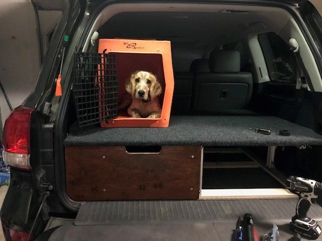

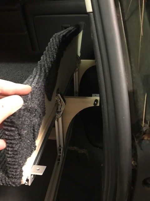

Just finished putting my 200 Drawers together and installing. I used the hinge idea like someone suggested on the 100 thread. The hinges are surface mount spring hinges from Home Depot (Everbilt 90-Degree Surface Mount Hidden Spring Cabinet Hinge (1-Pair)-H01068E-NP-CP - The Home Depot). I used this carpet from Lowes (https://www.lowes.com/pd/Mohawk-Hom...ngular-Door-Mat-Actual-72-in-x-96-in/50339644). I had to remove the cargo hooks and trim from the sides for the wings to fit (my amateur carpet job left a fairly large corner). . Still varnishing the drawer fronts so I have not installed both yet. Very impressed so far.
@sdscolumbia Nice install. For the hinges, looks like you're using those for the side panels, correct? Wondering if we could apply a similar idea to the sleep platform insert (except put it at the very front instead of in the middle)..
Good idea -- I believe that would work as long as you are not relying on the hinges for the support (the insert should rest on the seat backs for support). I may try carpeting the insert and cutting notches in the carpet overlap on the bottom to install the hinges. They should be able to stand straight up when the seats are reclined.
That was exactly my thought. Putting mine together next day or so and will try as well.

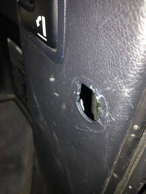

QWuick public service annc - I did not ship plugs for the oem cargo hook holes as I was still trying to find a good, flush one. I may have it, and as soon as I can sync schedules with @Bendcruiser to test will know if the search is over or not. Once I have one I mail to everyone though.
