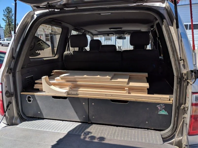

Sorry for the delay in posting this, I've both family AND friends in town (tis the tourist season here)... I test-fit proto1 in @Bendcruiser's rig on Tuesday (again a HUGE thank you!) and as expected lots and lots of stuff great, but couple things need tweaking:
I am updating the model, making new cut files, and off to CNC by end of weekend. As soon as I have the tweaks tested we are GO for production.

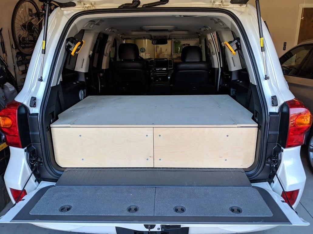

On the sizing front, I settled on 40" deep as the 'standard' configuration, like @tbisaacs, ARB, and others, BUT that was a big gap to close for sleeping SO I am also including a KISS solution: 5" spacer that you can install at the campsite to give you a better night's rest (you can see it in the middle):
There will still be a small gap to bridge between the platform and the folded seats, just like on 80s and 100s, but an air mattress or even a rolled up towel will fill that in no problem. This way you will have maximum (practical with drawers installed anyway) 2nd row seat positioning and reclining, yet the ability to sleep on the drawers. With the drawers at 40" deep (no spacer), 2nd row slid forward, you can recline waaaaay back, with the seats slid back (toward the drawers), recline about halfway. With the spacer in there and the seats slid forward, you can recline a couple clicks, about the angle my FJ62 rear seat was at, so still usable. If anyone wants a different spacer width, like 2 or 3", well as I like to say: "the KISS Drawers are the starting point for your custom drawers" ;)

I test-fit proto2 into @Bendcruiser 's rig today (thank you again, you have been a HUGE help!) and found only a couple 0.10" tweaks I want to make, which means I will be updating files and sending to CNC next week.
(wings not bolted down, ignore the fitment there)

What are the final measurements?
Height, Avg Widith, Avg Length.
Overall height is 12.0", width is 3/16 - 1/4 off the side plastic (57.75" at widest), depth is 40.0" in standard config, with 45" in sleeping mode.

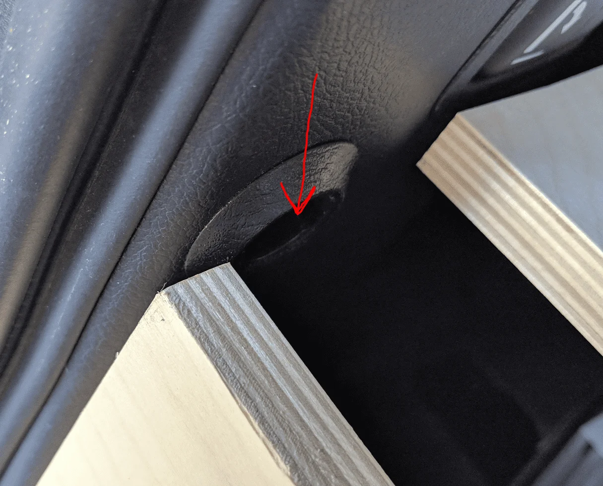

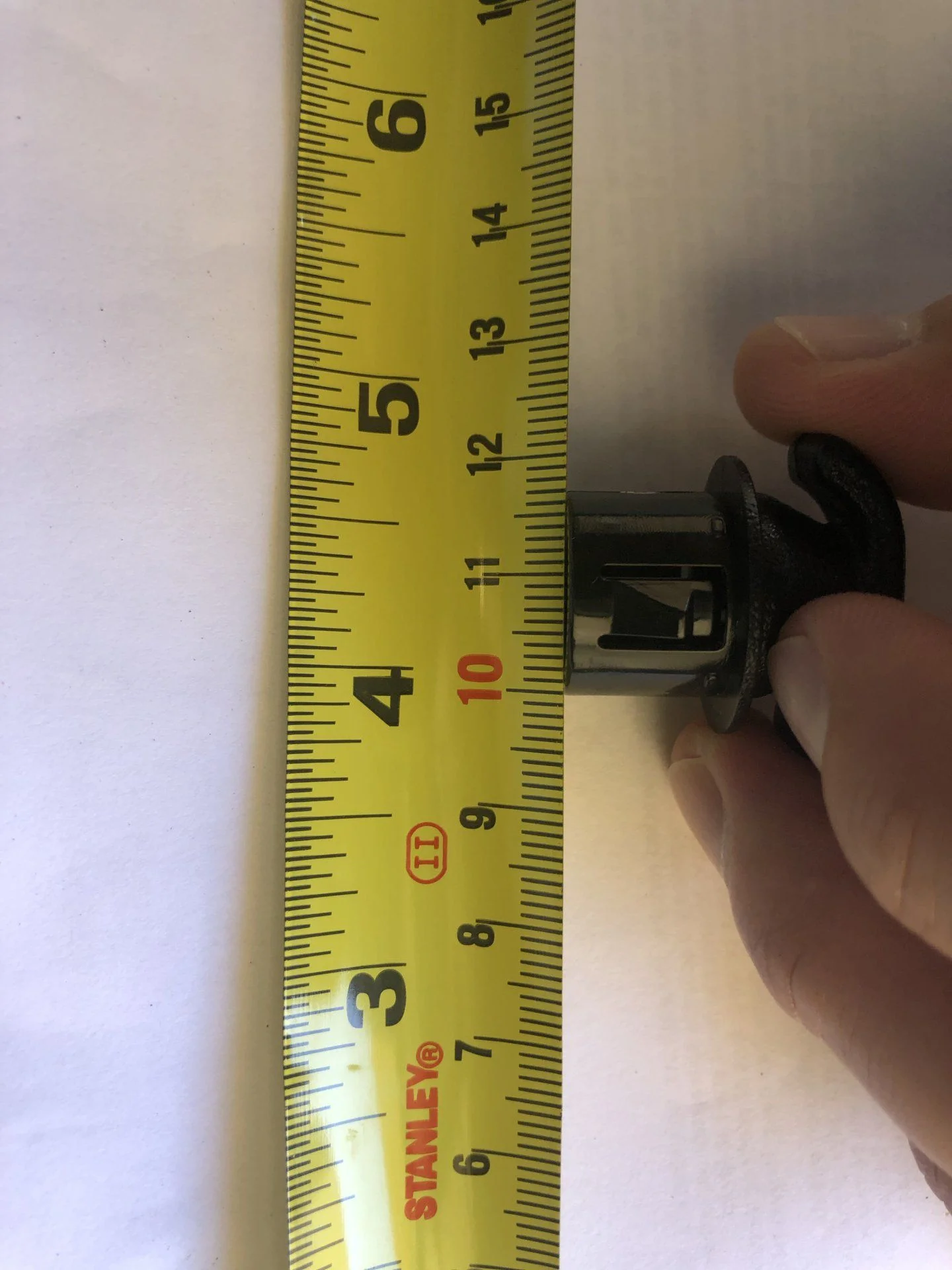

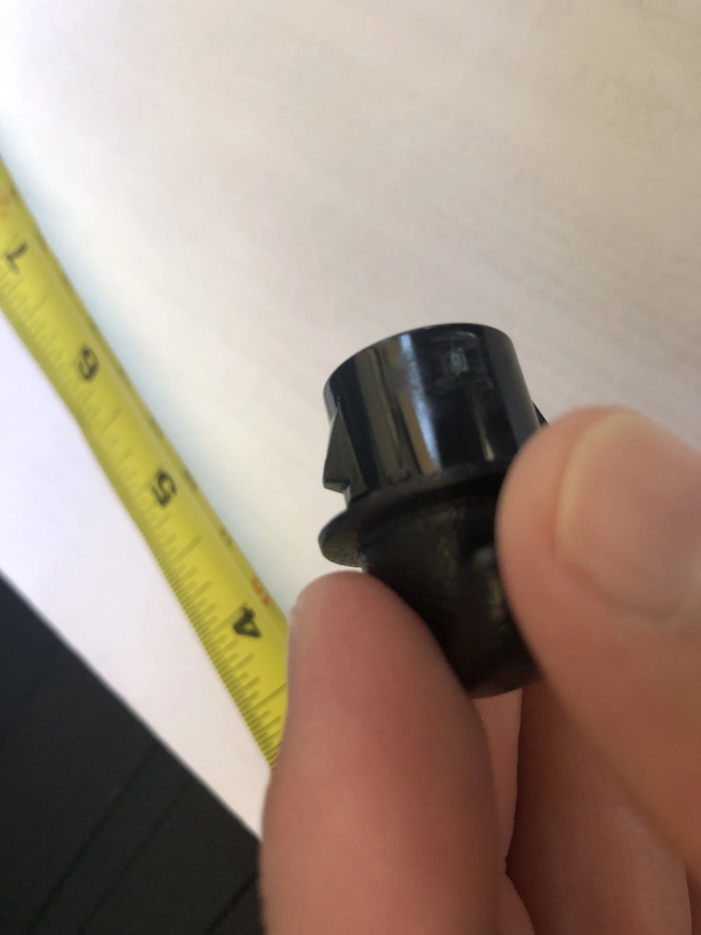

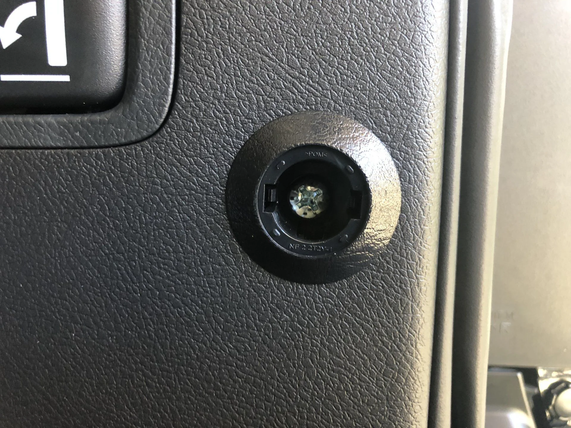

If anyone has a moment, can you please remove the plastic grommet at the rear, the one used for hanging cargo nets for those folks without awesome drawer systems?
As I wait for the plywood I thought I would source a nice cover/plug so when you remove the part it doesn't leave an annoying hole.
I just need to know the opening diameter.
Thanks!
