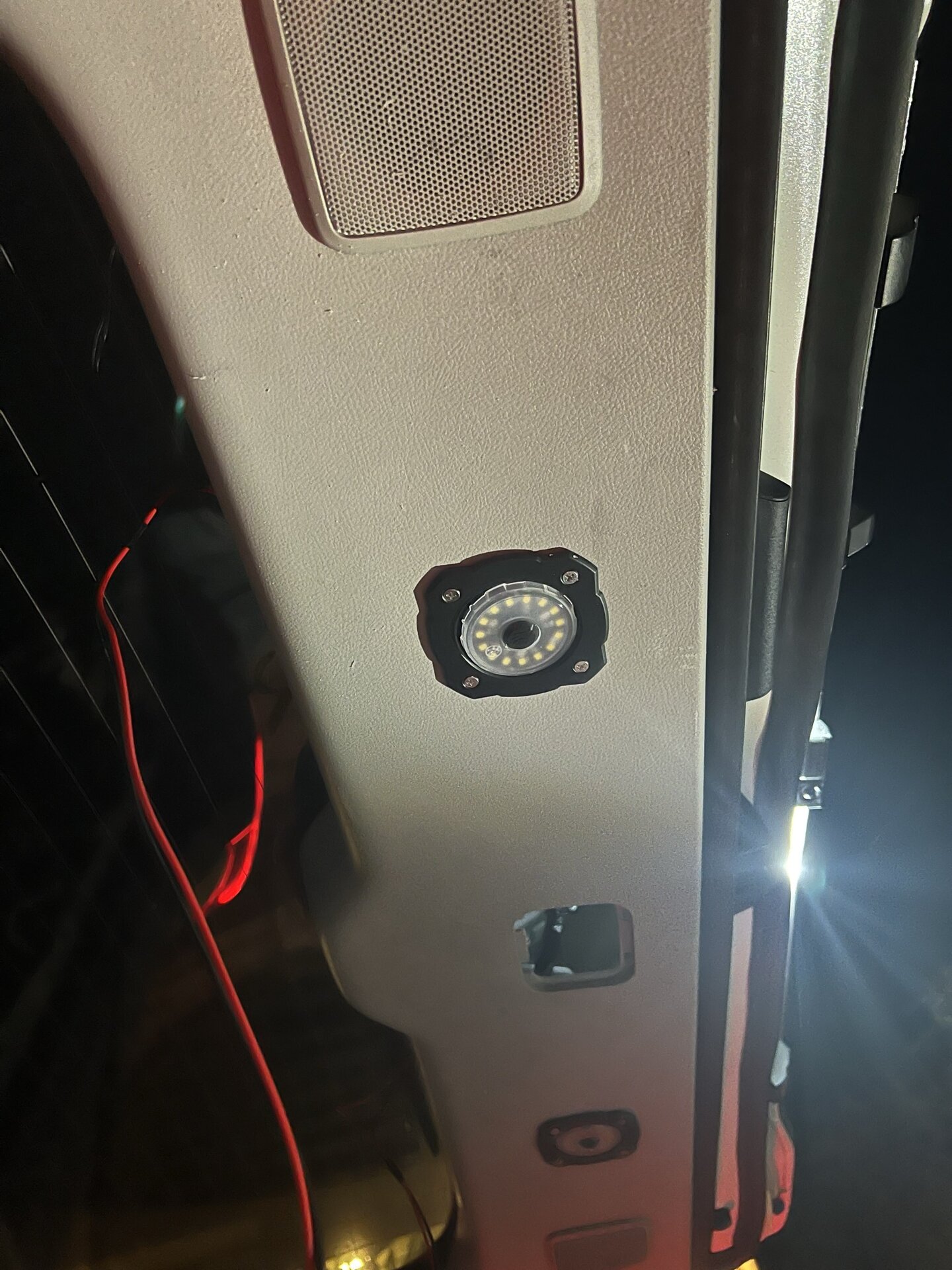

Nice. I have a set waiting for install. Was gonna play around with placement fore aft center lateral. Any observations.
Check out what else I have planned.
Just need to plumb the power to rear from yet to be installed aux batt

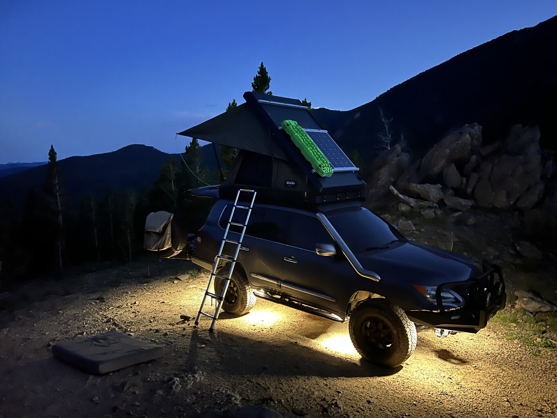

I like what you did with the cyclones! I’ll have to add a couple more under the hood now! I’ve got 8 of them as rock lights.

Those look great flush mounted in the lift gate. In regards to placement I preferred them further outboard after trying them both more towards the center. The nice thing about these being radial in design is that they throw the light evenly in all directions which makes them more usable regardless of their location.
