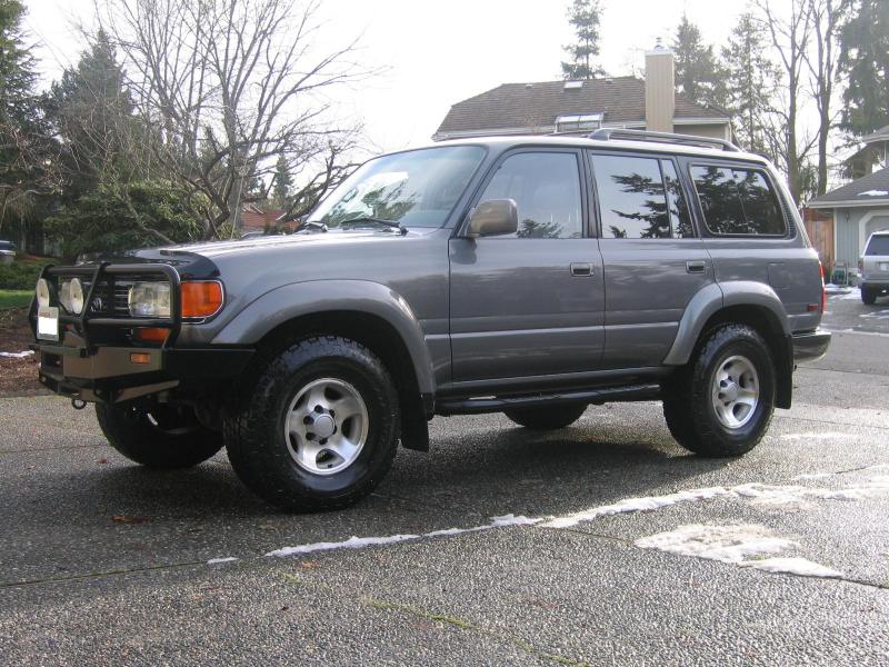

Here's some pics when I had the 861/862's and new Nitto 285's:

Oh and if you're looking for more pics with the OME low lift springs, Ashooter has posted up his rig and he is running these springs with Toyo M/T 255/85 R 16's which looks awesome
Thanks for all the responses guys. I'm really looking forward to the new setup and I'll post some before and afters. My springs still haven't shipped but I have to assume it will be today. I'll have to see if I can track down Ashooter's rig.
