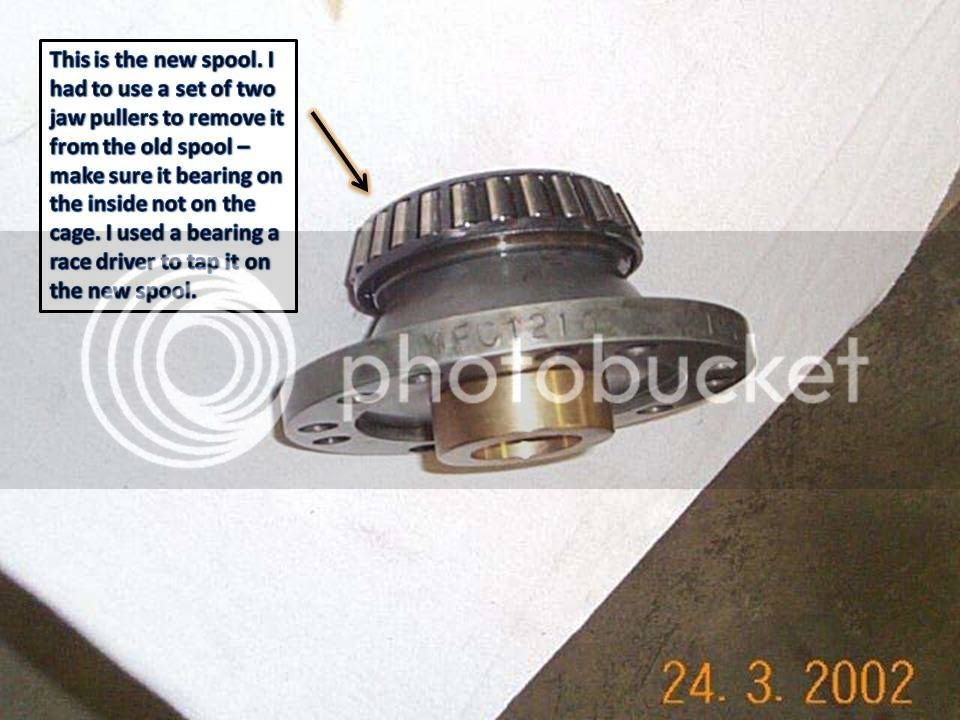

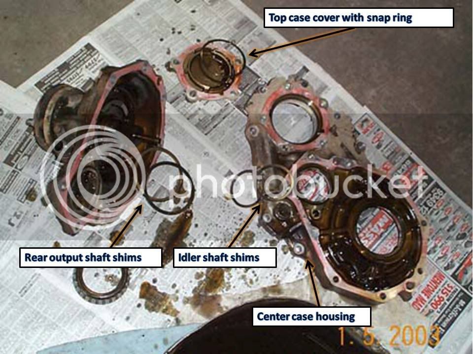

A couple of notes for those looking to do this change: you will need some type of puller to change the bearing from the old spool to the new spool. The shims that adjust the pre-load for the idler shaft and output shaft are harder to install with the case in than if the case was out and with the front side down.

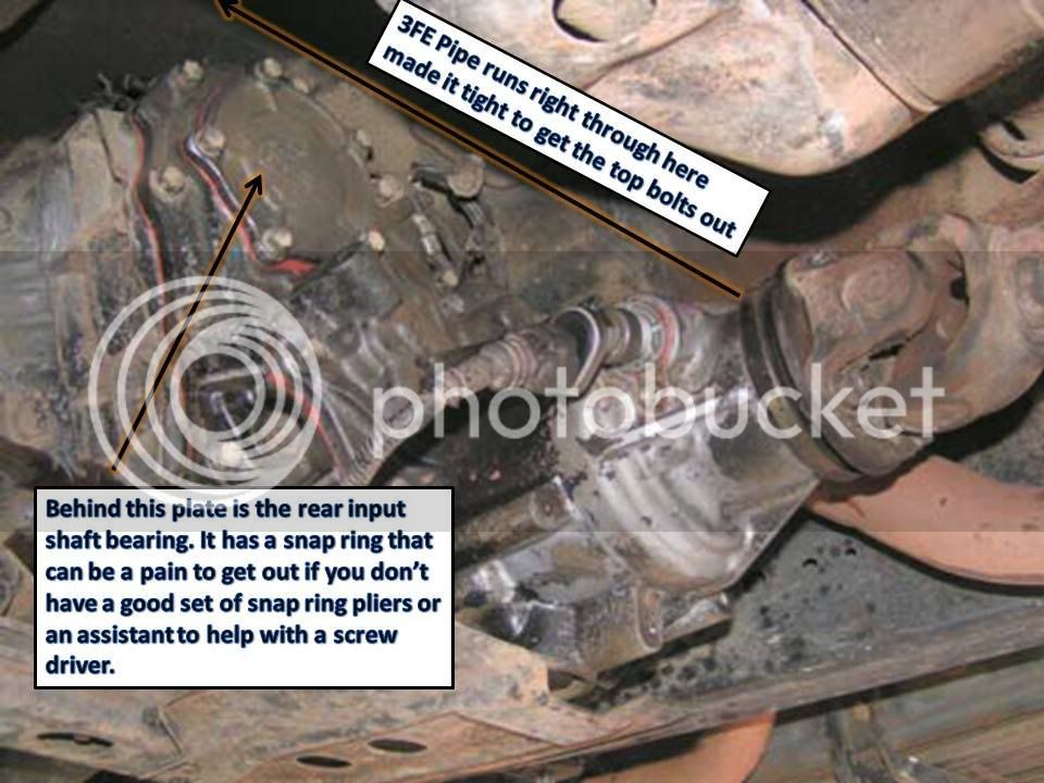

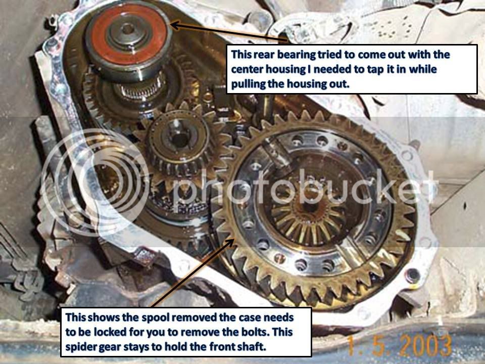

No Pics from my job. I will try to post up some from the instruction sheet.
The hubs come with the kit, or you can buy them separately. They are AVM hubs. You use ring spacers to get the correct width on the outer axle shaft. If you have a 91 to 93 you have shorter birfs and you don't have to use the rings, if you have 94 and newer or after market birfs (usually) you need to use the rings. I talked to Slee and they said they have not had any issue with the rings or with spinning these hubs while wheeling.
This case is really easy to work with. Its just a little tight getting your hands and tools in there. The hardest part was getting the snap ring off the rear input shaft bearing. With a lift you will be on easy street.

Some pics from the instructions with added notes:
