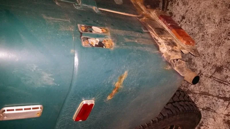

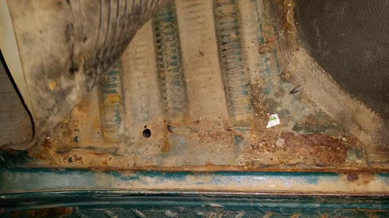

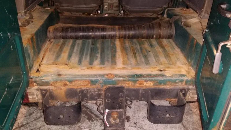

This rig is Canadian and very very original. It is rusty as hell but the frame bones are good. Ambo doors original 5 speed and 4 cylinder diesel with power steering and original dash. Nope not for sale. I'm gonna build this one.
I have no idea what the BORAT I am doing yet.
The rust can apparently be fixed with high quality patch panels according to PO. I think the Canadians put a lot of fiberglass around the doors and rear panels. What are some of the challenges I face...
I paid 13k for this rig and I need some people to share their experiences.
I looked at that truck yesterday on eBay and thought there's no way someone would pay $13,600 I believe for that. To be honest you are into some serious rust on that truck. Anything can be fixed but how much are you willing to spend
Congrats on your new project. 84 is a great year to be working on, it's an add value for sure.
Do some research, you will see a ton of build up threads dealing with similar issues. I would wait and make a list before ordering panels. Maybe a new tub would be cheaper?
Great site there and there prices seem pretty good, I would make a list like Ambrew said and get a complete tub and paint it beige. Make sure you tag and bag every part you take off.
