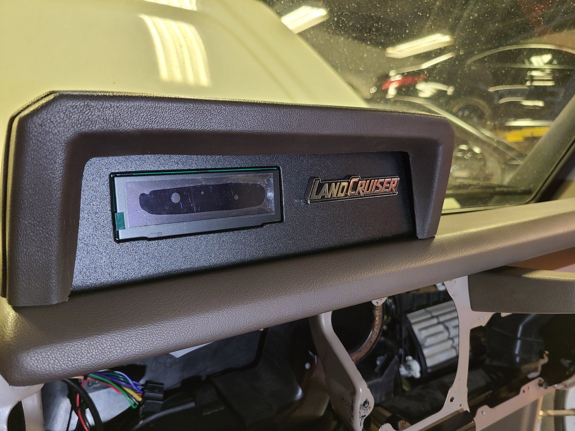

Was able to sneak my gauge pod face in at the powdercoaters....they were doing a batch of textured black.
Got it back, mounted the screen and one (1) piece of flair :)
I'm not a huge fan of badges and logos.....not sure if this will make it to the finals but it's kind of cool looking.
We'll paint the circuit board black around the screen so it won't be visible. Seems like my cutout for the gauge wasn't as precise as I thought...
I love so much of what you do, and that gauge pod looks awesome ... but that screen just looks like a stuck on monitor. Sorry man, know the screen real estate is useful :confused:
Trust me, I'm not a fan of these in newer cars and I'm not a fan in this truck but I think it will be useful.....I spend too much time squinting at the standard size ones now days. Not a fan of the gauge pod either.....the truck had such a clean dash before.
I think when it's all together and operational, it will look a little better.....hopefully just fades into the dash.
When it’s all said and done, it only needs to please 1 person. :)
I'm a very difficult person to please so there's a good chance it will all come out :)

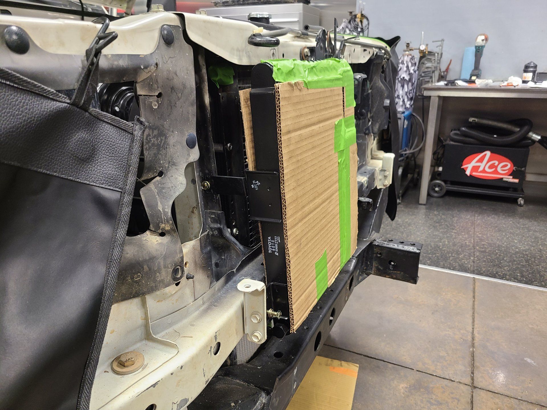

Solid day today on the truck......we concentrated on our front end stuff as we had a few changes that needed to be addressed, specifically the condenser and the trans cooler.
I contacted the guys at Wholesale Automatic Transmission about cooling requirements for the A442 and what they recommend since they put autos in VDJs....and they of course don't have a cooler in the radiator since they were manuals.
They recommended this trans cooler from a HDJ100.
Had to make a few brackets for it but it seems to fit nice.....
Slipped the condenser in...mounted it a little differently. Looks like one line will need to be changed. I ended up NOT using an OEM one as this one has worked well. One day if I redo the AC, I'll pop an OEM one in.
Since we're using the 1FZ radiator and a 1HZ shroud to fit the 1HDT motor, some of our mounts didn't line up. Fabbed up a couple little brackets to hold the shroud on. LOTS of brackets today.

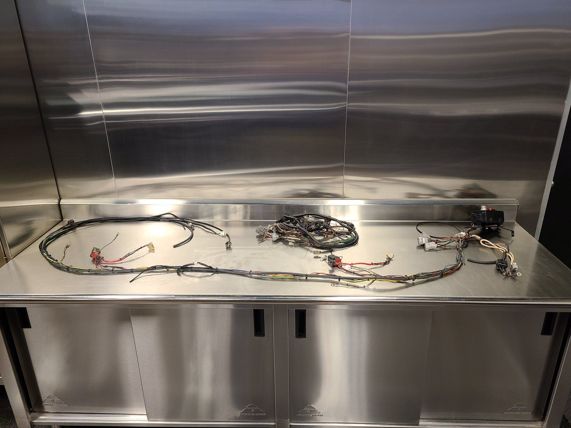

Wiring. More wiring and more wiring however the end is near.....we are installing tomorrow.
This is the body harness for the front of the truck. Lots going on here and quite a bit getting changed. Biggest change was wiring for the alternator as it moves from drivers side of the 1FZ to the passenger side of the 1HDT.
Engine harness still needing a little work but not much....
