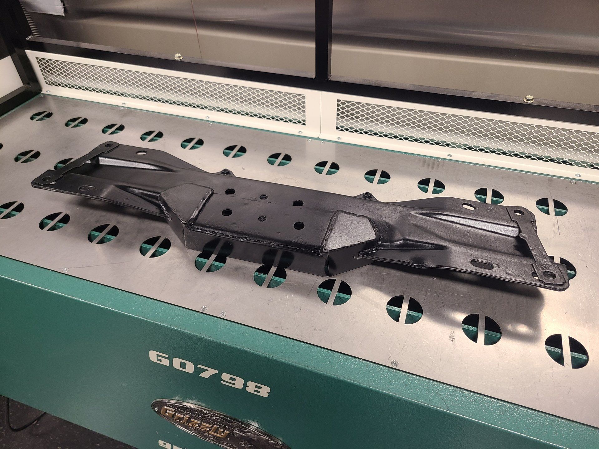

Made some headway on a few other things here and there....forgot to take pics. Mainly the fuel filter mount and the trans cross member. Finished that up and painted it....install tomorrow.

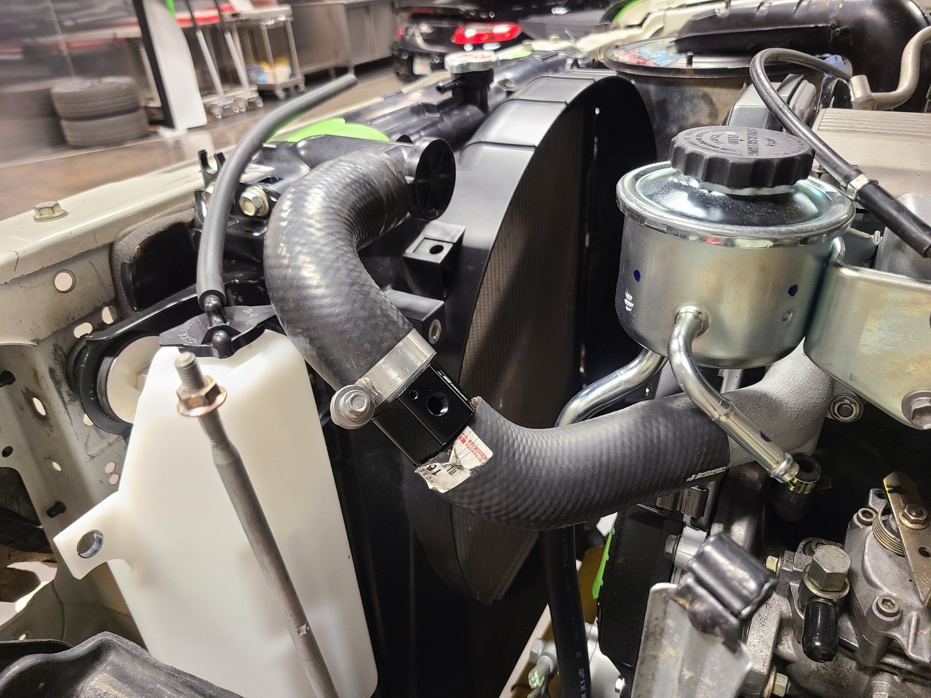

Water temp sensor for the gauge is going to go in this aluminum adapter. Never used one before....a little weary of it but It seems like a good idea(which I'm sure I will regret at some point). We are using the 1FZ radiator since I have it and it's brand new.....required a funky hose setup....part 1FZ.....part 1HZ. Shroud is a 1HZ which of course will need some modifications since it bolts up differently to the 1FZ radiator. The coolant overflow bottle made it in....that was my project which took just about 4 hours too long.....distraction central in the shop today.....mostly being ADD.

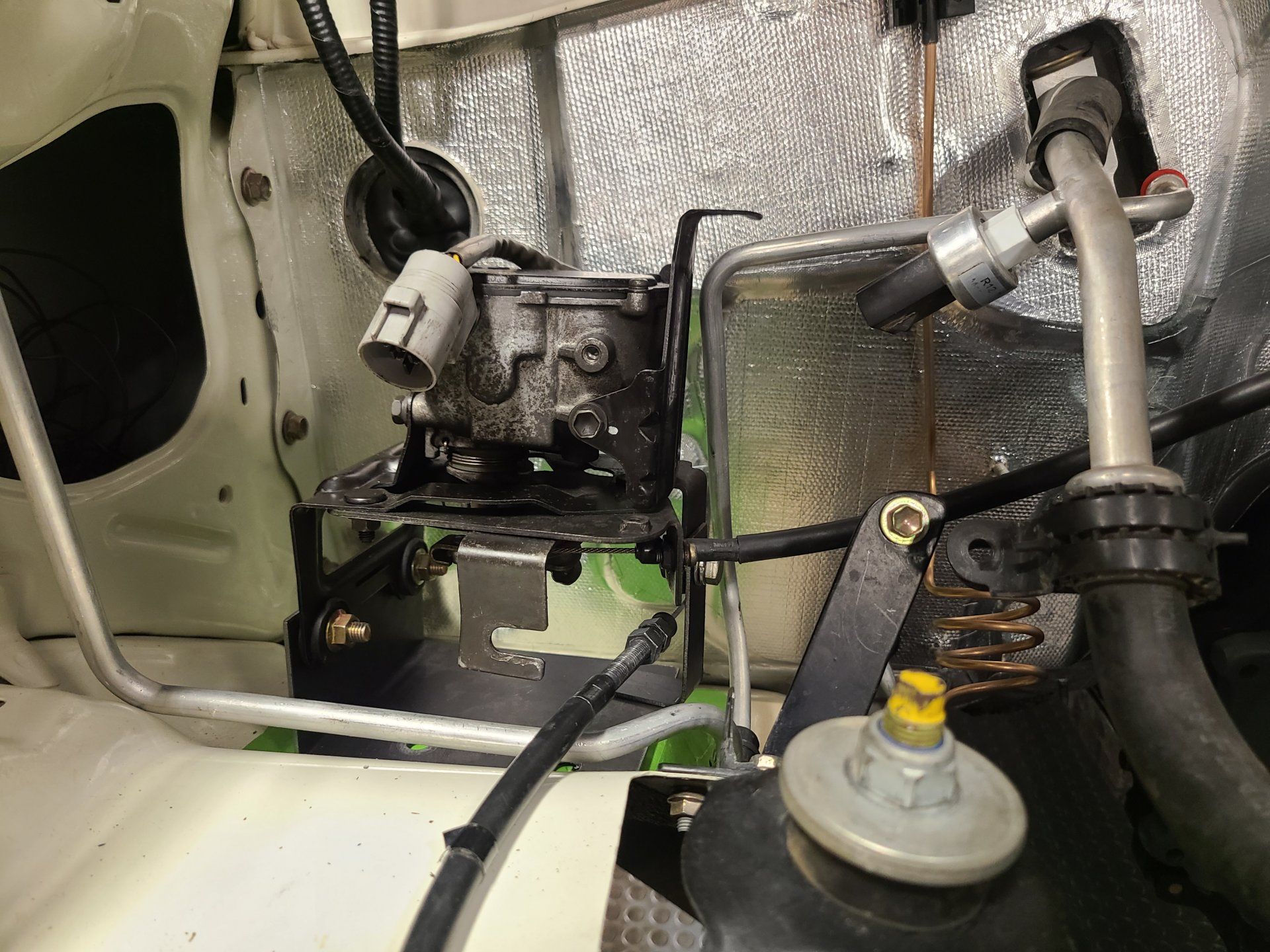

This is where the cruise control mechanism fits.....the 1FZ accelerator cable will reach over to it(the 1FZ cruise control was mounted here)....then the HDJ81s throttle cable from the cruise to the motor fits just fine. The only unfortunate part of this system is that it sucks up the space where I kind of hoped to put a second battery for the future winch......I'm sure all of this will come out at some point.

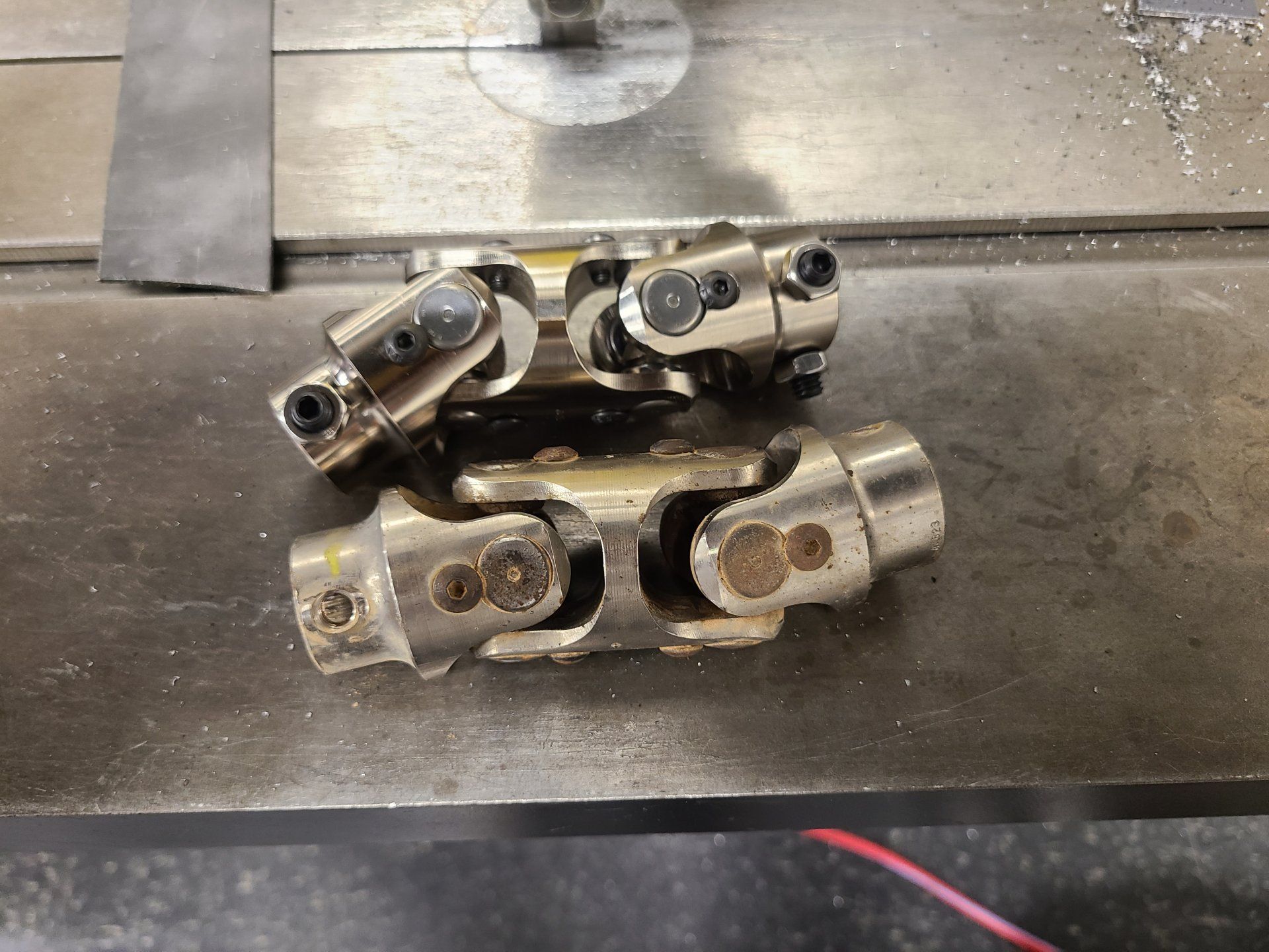

I wanted to install a new one of these steering joints while we had things apart....I felt a little play in the one that was on the truck. I doubt they were designed to be used in an off road environment. Would be cool to put a boot over it somehow.
Transmission cross member done and on.....pretty stout.....maybe too stout.

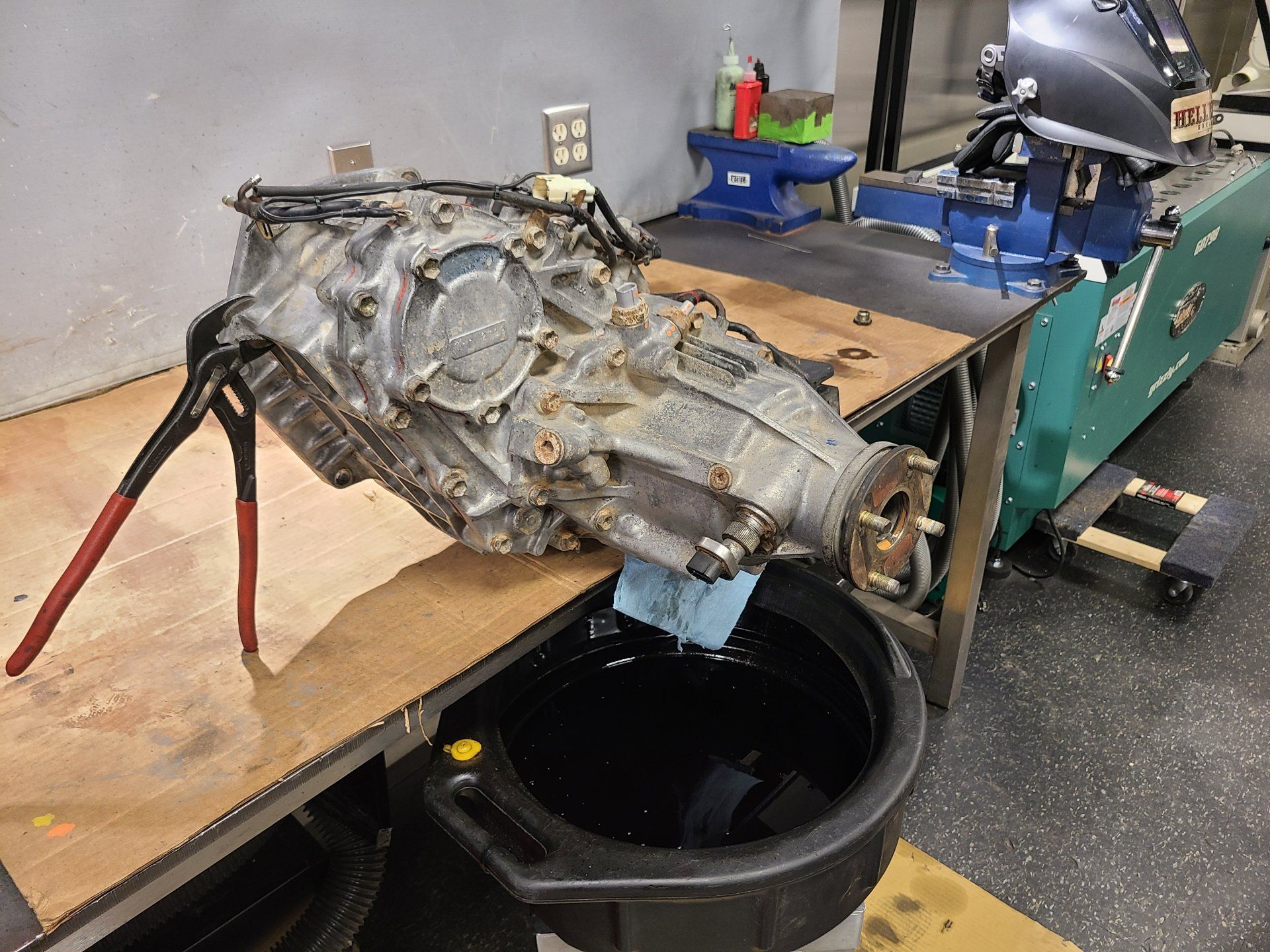

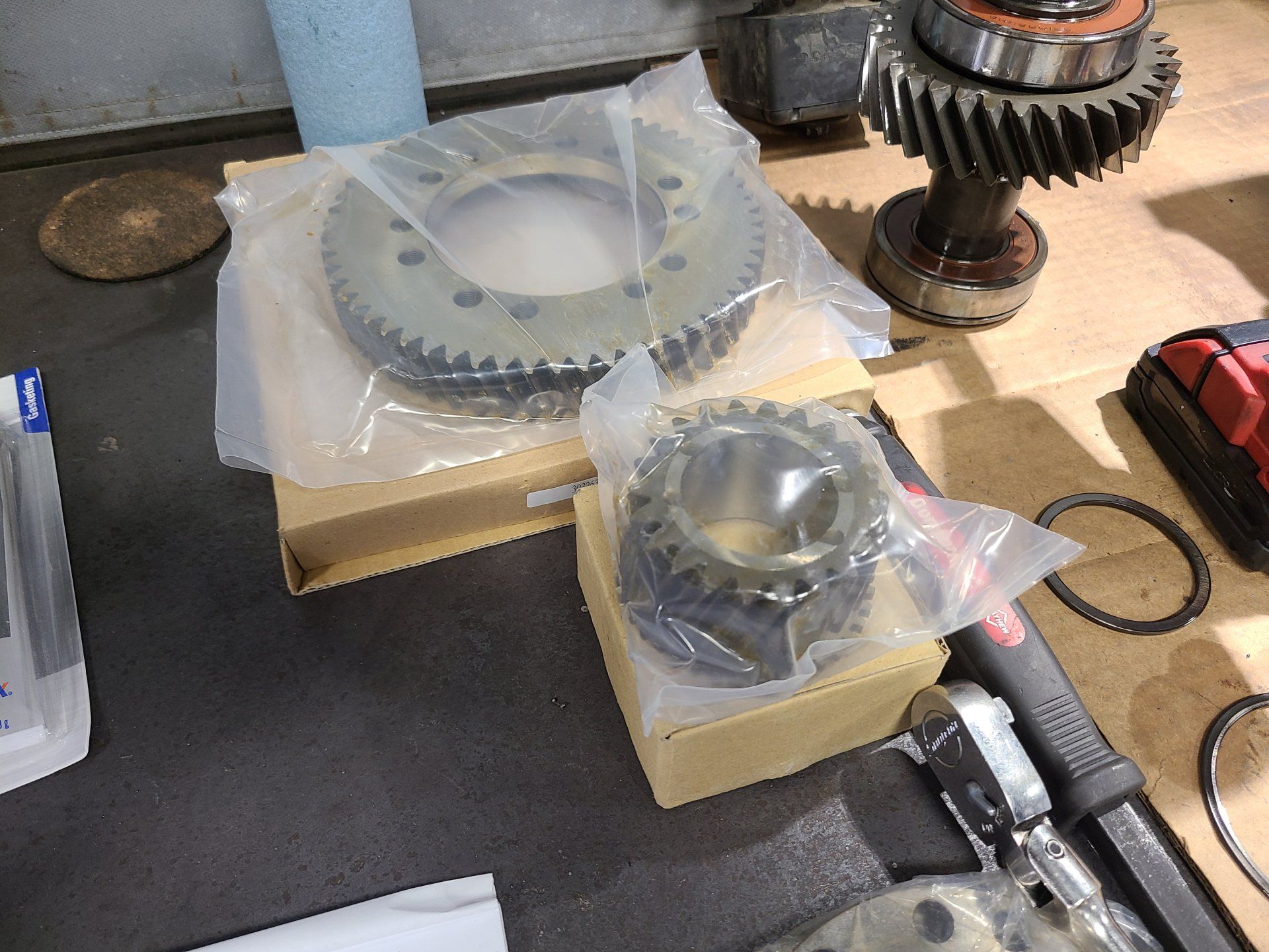

And while we were on the truck......this was going on the bench behind us. Marlin Crawler part-time kit and Trail Gear low range gears installed. We're using the 1FZ's A343 HF2AV transfer instead of the one that came with the A442 which was a HF2A...
Transfer will go in tomorrow so we can measure driveshaft lengths and getting those modified so they're ready to go.

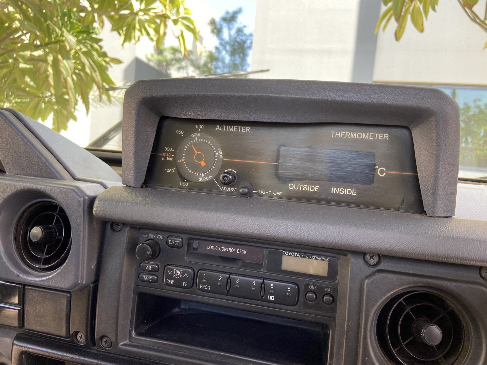

And finally.....we welded this back together and cleaned it up so it's ready for powder coat. It looks horrible in these pics....the corners are weird, the top is crooked, the pod looks to be sagging a bit. When it's black(textured black) and mounted, it will look great. I hope.
Never realized how much this thing was sagging in the center. Bummer.
Please let me know when you figure out how to correct that sag.
I thought mine was bad!
I was actually going to see if my fiberglass guy could make a glass version of these with a face so people could mount whatever they wanted in them. Seems like a good idea....
Is there a metal structure under the cover?
Oh well. Nothing to glue or screw to.
Unfortunately nothing there. I think the glues end up deteriorating and then the foam separates from the plastic. Headliners do this in the fancy cars we work on...older ones at least. These poor pods take a beating from the sun so it's no surprise they're a little warped.
