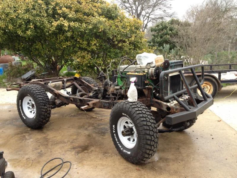

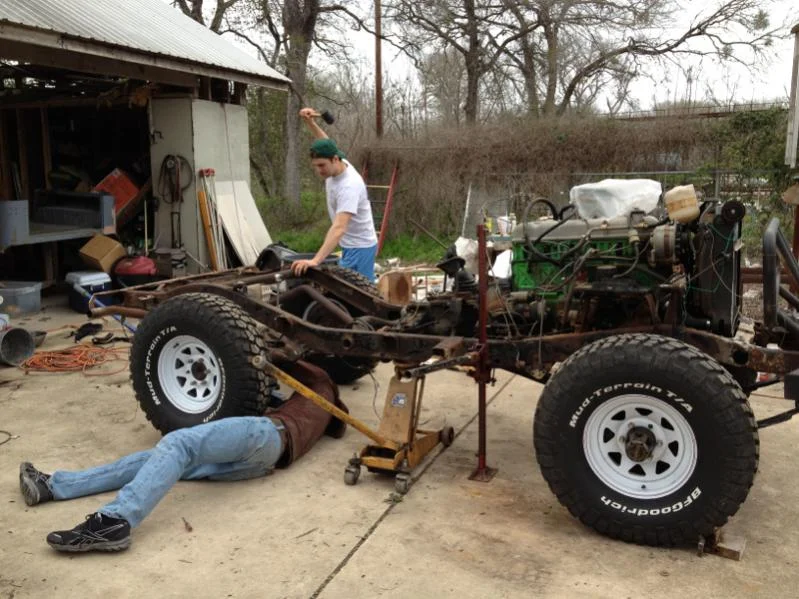

Yesterday was a a good day with plenty of help. We removed the body and placed it on yet another big cart with casters that my dad happened to have. It came off easily with three people. I am not embarrasses to say that we had to flip the lift. We had our the fronts on the rears thanks to poor instructions. I also re-installed the leveling blocks that the truck had before. The truck now sits level.
I have a few small projects for the middle of this week: gauge restoration, steering wheel and column cleanup, and install the new fuel pump and spacer. My current one was leaking like a garden hose spigot while still averaging 10 mpg. So, I've got high hopes!
I am now waiting on my chassis paint, and will start prepping the frame. The picture below is before the springs were flipped. I also picked up this high lift which was my great-grandfather's, my grandfather's, and now mine!
My much appreciated help...

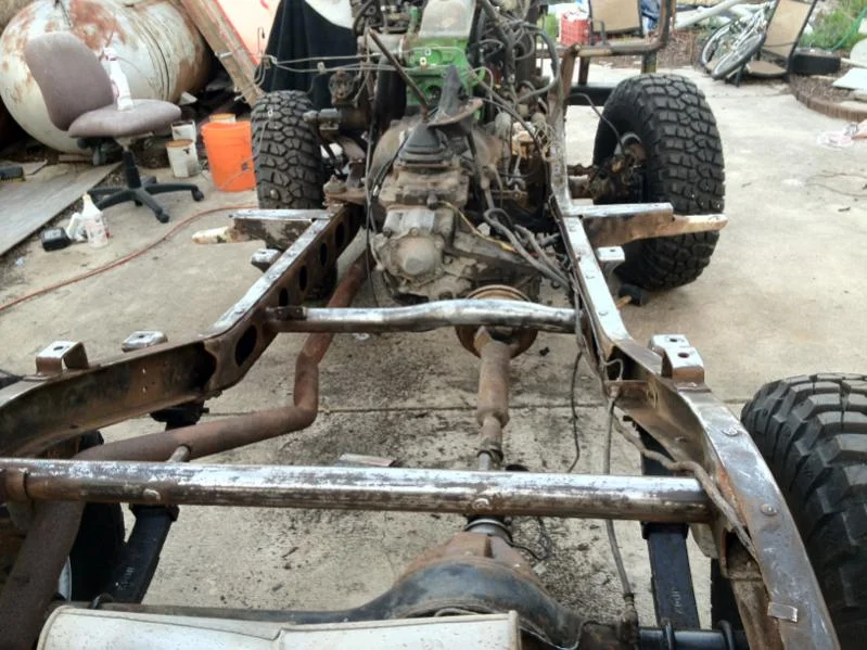

I spent a few hours wire wheeling and sanding with the 36 grit. I've heard so many negatives and positives about the various products out there, and at this point, I just want it black! I Have a little more sanding and prep to do before hit the frame with solvent and the pressure washer one last time.
I am still undecided on the paint of choice for the frame, but it will most likely be Rustoleum primer and satin black. Maybe I will have pictures of a black frame by next week.

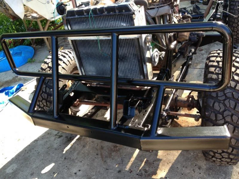

Spent a fair amount of time last night wire wheeling and grinding. It got pretty difficult as is got dark, but, I was able to clean up the welds on the custom bumper.

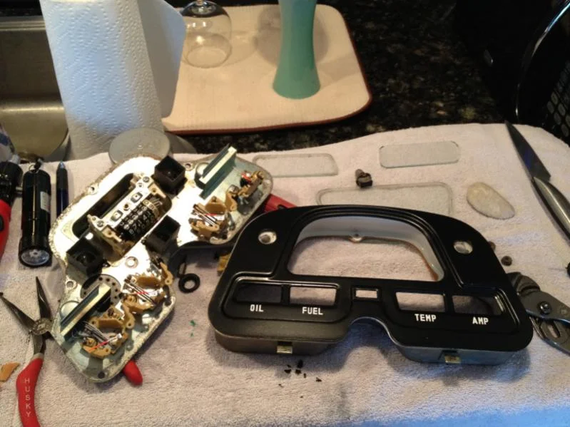

Did you use a kit on your gauges? Or did you make this yourself? What black paint did you use? Did you like the result?
I used Biscuit's kit for 33s
It is great, because it includes so much. (needle paint, sand paper, gauge letters with alignment guides that make application easy, screws to reattach the Faces after you remove the aluminum rivets. and detailed 6-8 page colored instructions!) In fact, it's an unbelievable deal.
https://forum.ih8mud.com/merchandis...peedometer-upgrade-non-stock-tires-diffs.html
You will need a little file to remove the rivets and other tools you have around the garage.
Paint is rustoleum matte black performance wheel paint. And Duplicolor "light tarnished silver metallic" BGM0530
I had to try a few different colors before I got it close enough.

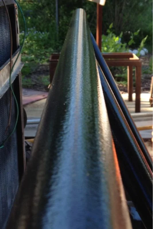

Despite the early morning fog and slight mist on Saturday morning I Sybila waited out until the sun texted driving out that I painted the entire frame with the product that was recommended to me by the new body man that I met. He was kind enough to offer help, so, we'll do a lot of the work on my truck together. As it turns out my new neighbor is a 30 year seasoned body and paint guy!
This is a two-part low gloss enamel ( the color I chose) has optional Hardner that you can purchase. They carry this at tractor supply and possibly Lowe's.
I played around a bit with textures on an old rusted flatbed until I got exactly what I wanted.
Seeing the dry frame after a two week cure was great. I am very happy with the color, coverage and finish.
