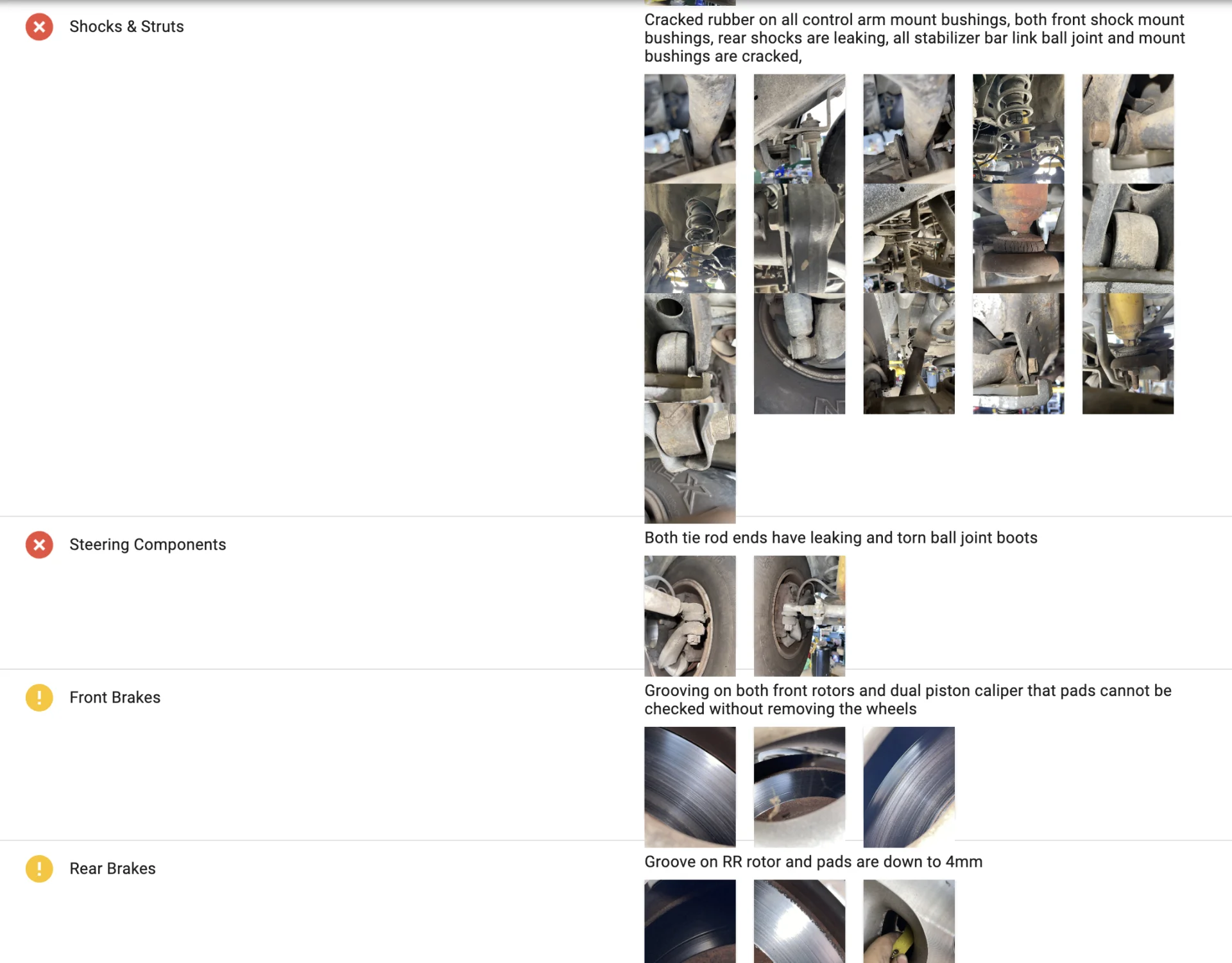

  • New control arm bushings are completely doable on your own. Either get a 20 ton press from Harbor Freight or take the bushings and arms somewhere to have the new ones installed. Tie rods are not hard. Get a simple screw-type tie rod removal tool or a pickle fork. I like the screw-type because it doesn't tear up the seal if you need to take it apart later. If you can purchase the tie rod links (the tube between them) I'd do that.
  • Shocks/springs: More than likely the springs are starting to sag. Mine sat lower than stock by the time I put the lift on. Not sure what your plans are for the truck but even going with stock height and load spring from OME/Dobinson/Ironman/etc you're going to see a nice improvement in ride and handling.
  • Seriously consider sending the steering gear off to RedHead or West Texas offroad (I think that's the name) to be rebuilt. More than likely you've got a worn sector shaft so it drifts all over highway right? You can rebuild the power steering pump or get a new one from Toyota. I like to keep my old stuff as a spare. Again it can all be done by you so long as you invest in a decent set of tools.

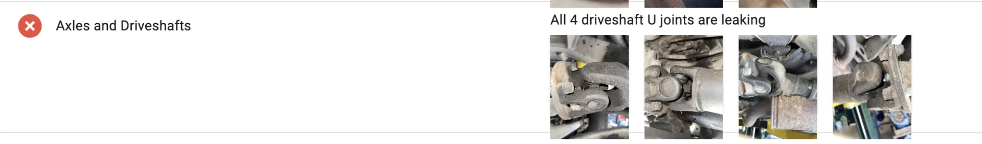

  • U-joints just pull the shafts and take them somewhere to press in new ones. Maybe the same place that presses in the new control arm bushings.

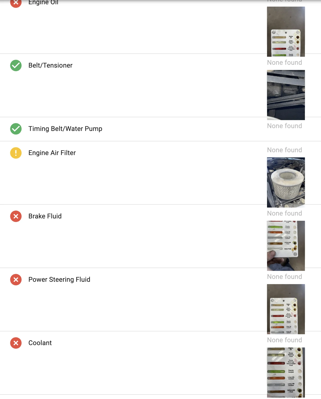

The fluid looks like sewer water: really nasty and brownish. To be honest I had no idea it was supposed to look pink, and I haven't topped it off yet, though I think the shop might have when I had it in for am inspection. the level looks about full when I check it.

The color is probably due to a mix of fluids in the system. Somebody probably put power steering fluid into the reservoir instead of ATF. Flush it out and replace with ATF. You can even use a vacuum pump to suck it out of the reservoir if you don't want to try to drain it.
That seems like an easy mistake to make: putting power steering fluid in the reservoir. In fact I had no idea you were supposed to put AT fluid in there.

The floating steering should be a priority. At the very least, do some investigation and research to understand the cause, and assess what is URGENT, deal with that first.
Same with brakes. If it's stopping OK at speed, grooved rotors, and low pads are important, but maybe not the most urgent. Same with dirty brake fluid, and dirty coolant.

Best bang for buck, check front wheel bearings and knuckle stud nuts ASAP.
Lay under the truck, and have someone rock the steering wheel back and forth, look for excessive movement at tie rod ends in particular. Then panhard rod bushes, wheel bearings, knuckles etc
2. Is a complete bushing overhaul doable as DIY? What about springs, shocks, and tie rods? I've never worked on suspensions before and don't have any specialized tools. Any part of that which would be best left to professionals?
Yes, it's doable at home, but you typically need a shop press and some pucks to press old bushings out, and new ones in.
Alternative, remove arms, rods etc and take to a shop to have them swap out bushings.
Get under the truck with a pry bar, and wiggle control arms at the bushing. If cracks visible open up when prying at the links, it's definitely time to replace them. If they aren't visible crumbling, deal with the ride and focus on immediate problems.
Springs and shocks are doable at home. About the only thing a highlight jack is useful for.
Springs are likely low on the priority here, shocks higher priority.

6. Is it worth flushing the coolant and replacing with Green? Looks to be orange universal stuff, but I don't want to risk mixing colors. My temps range from 190.4-194f on the highway, and creep towards 200f idling in traffic. The most I saw was 205f going up a steep country road.

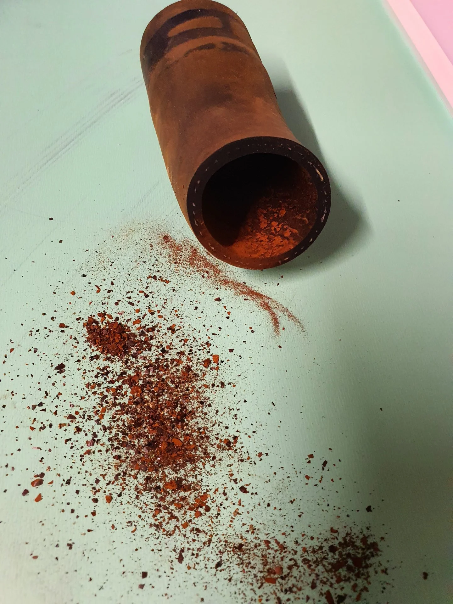

make sure you flush thoroughly before adding any coolant. Particularly if it's not ovious what's in there.
This is what was found in an engine of mine after mixing coolants
