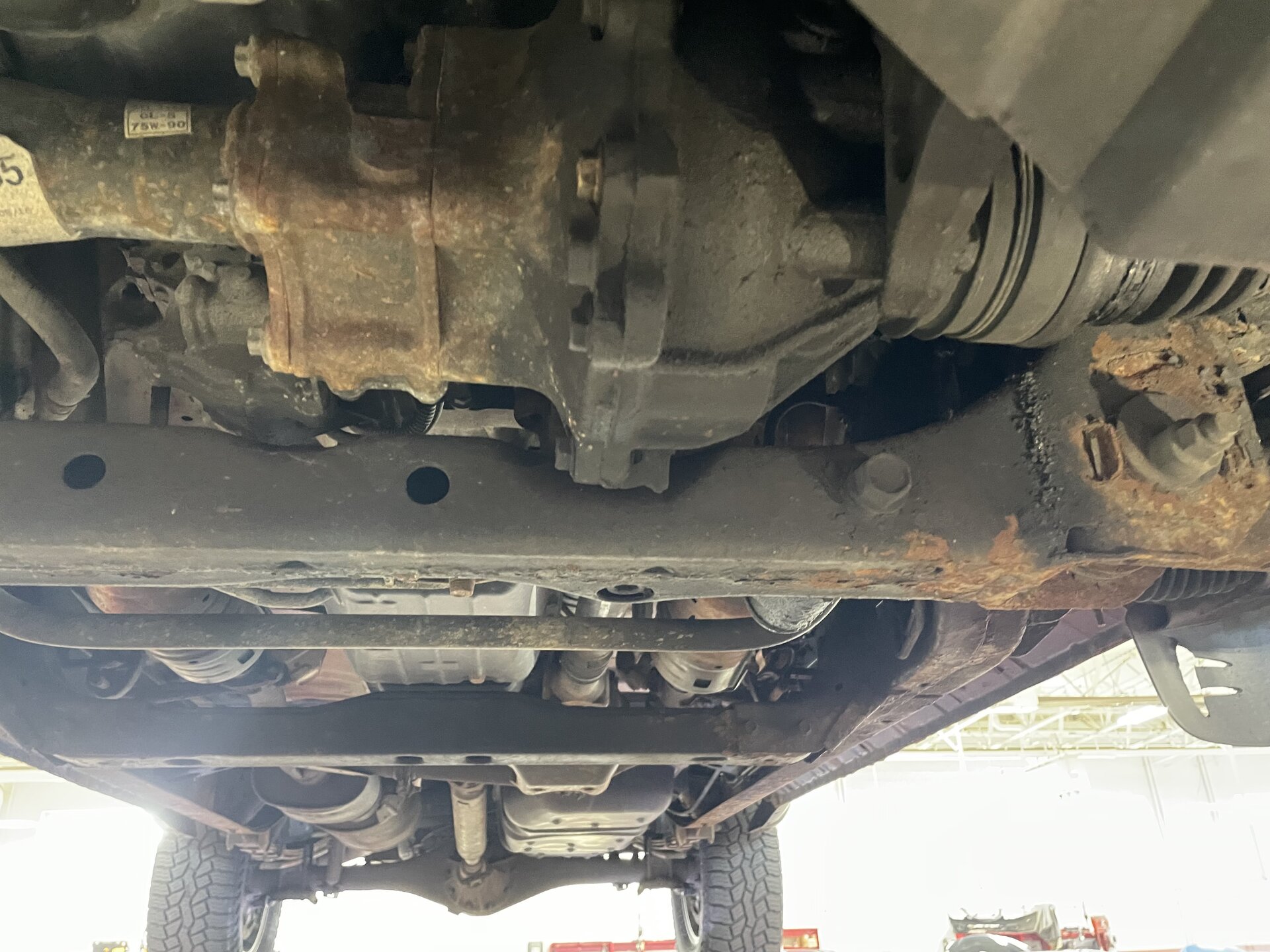

Is this bad rust on a first gen underside? (1 Viewer)

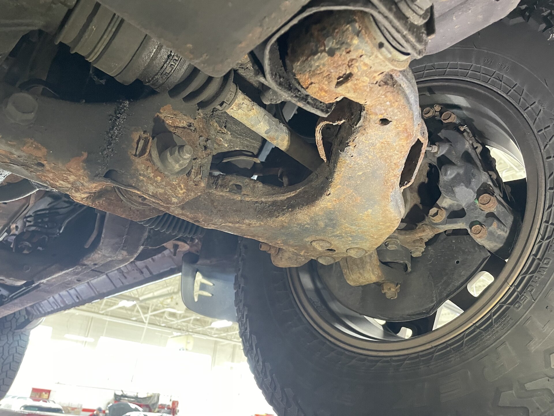

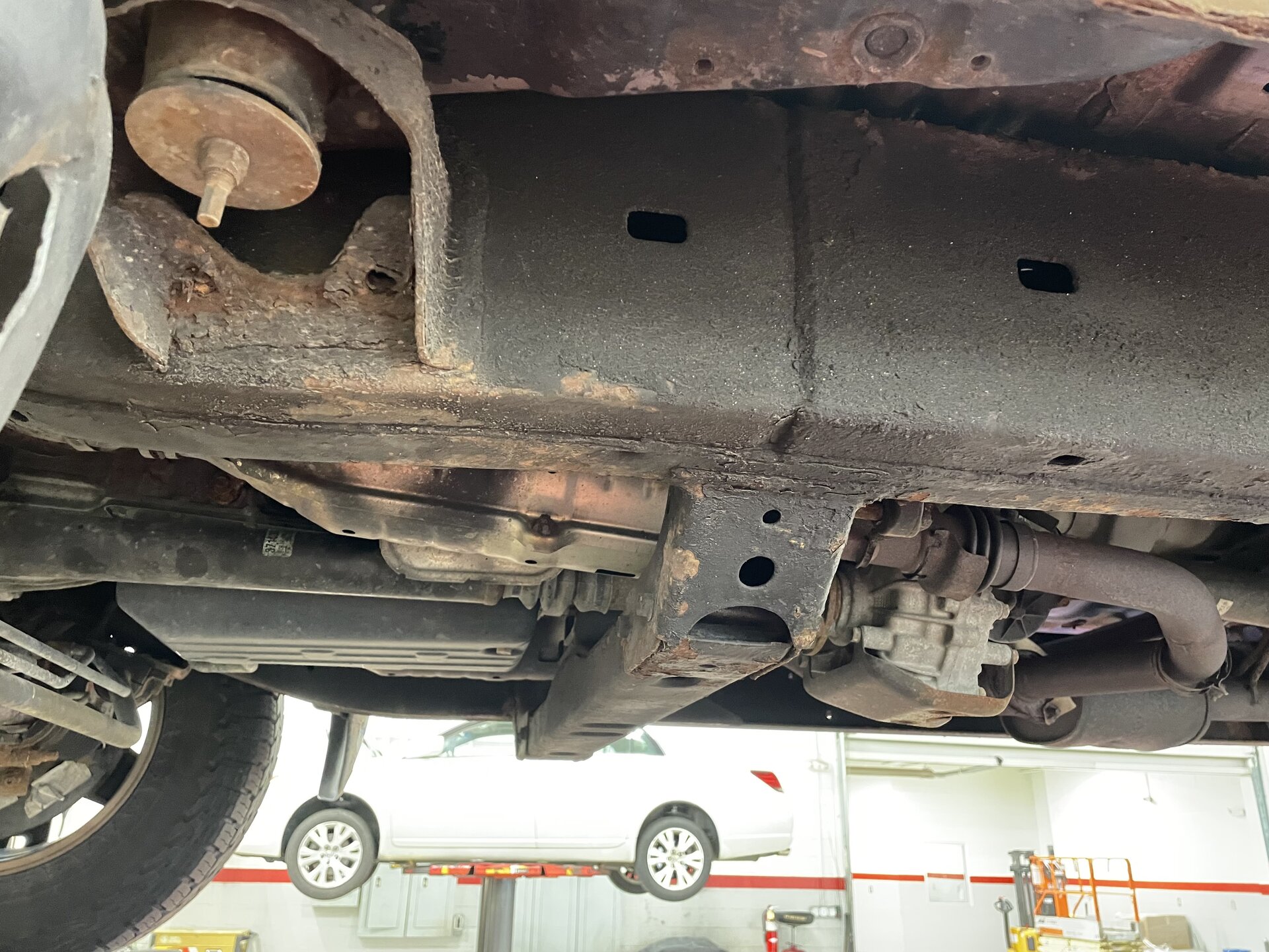

What does it look like on the boxed parts up by the cats?
Body mounts don't look awesome, and cancer is definitely starting but does not look to be past the point of no return.
If your truck, I'd get it back on a lift and blast about a gallon of woolwax onto everything but the exhaust, brakes, and cv boots.
I was looking at buying it but backed out. Looked a little too bad for my tastes And had some other expenses dropped in my lap. Thanks for the reply.
Looks like a lot of rust to me. Sounds like you decided to pass. I wouldn't touch it unless it was REALLY cheap. The sill plate rust is enough to scare me away.
