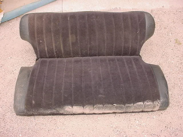

Had to dig these out today to send some pics to SOR.
Is this a rear LV seat? How does it fasten?
When I got my rig this seat was laying in the back sideways. I'm assuming it is, but I don't know, never seen one before?
Thanks, Matt

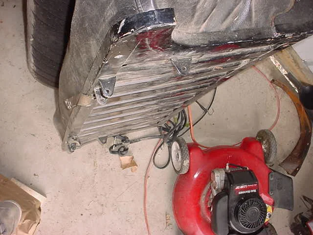

Looks right from the bottom!
looks like a LV seat, but not sure what the 2nd set of mounts are for on yours. Also it looks like your seat has a strap on it......
also your seat bottom had the wide bottom, can see on mine its not curved(for the fenderwells)

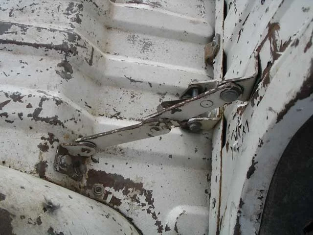

Pimp, I got one up on you!!! I'm so happy :D The second set of mounts are a restraint mechanism (keeps the seat from going too far forward). I've got the same on my '67.
hmmmm, both my 64's are the same......
I don't see how those work?

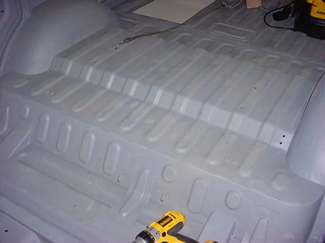

Mine's a '67 and I think Matt's is too. Those extra mounts connect to what looks like a tailgate support and is also fastened to the floor. When the seat is fully folded up the supports are fully extended. When the seat is in the normal seating position the support is retracted underneath the seat. I think the holes in the sloped part of the floor in the picture of Matt's 'Cruiser is where those supports mount to.
thought his was a 65, but regardless. I think I get how they work. But I don't see the bottom seat mounts on the tub and those 2 brackets on the sloped part of the tub are just on one side, they look more like seat belt mounts.......but I dunno

63/64 had the no wing bottoms. Should also have the pop up cowl vent. Per Rick D. the later 64 seats were too wide and would hit the inside door handles when folded up. 65 to 66 were similar but per Gene aka LCJ, the heights of the seatbacks varied even in the same years.

Here is a pic of Goodnight's LV seat:
Looks like I have that seat and I have the holes in the floor for those brackets.
Now, does anyone have any brackets, arms and mounting hardware I can borrow for a week so I can copy them?

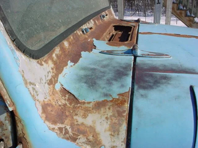

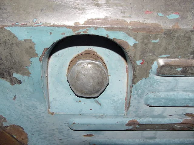

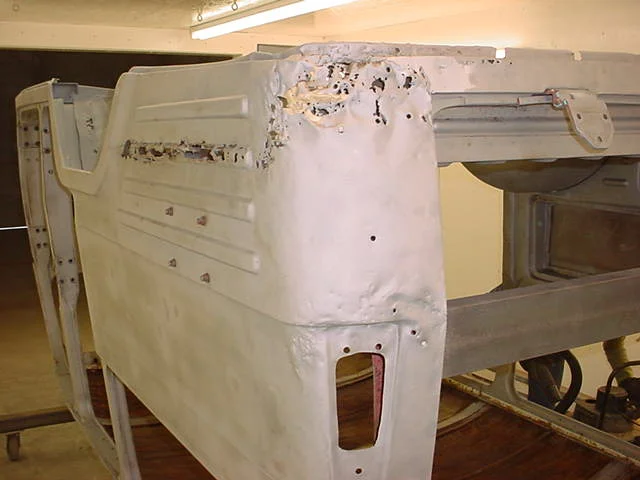

all 66 had the brackets....later 65 probably did. You have the 3" brow, no gas filler cover, the holes for the little reflectors, and the metal "land cruiser" tailgate emblem. It isn't a 64 because you have the grill style cowl vent, refector holes, and emblem. It isn't a 66 because no fuel fill door.
Later 65 build

that seat came from a 45lv of the guys on pirate was parting out(groundup?) IIRC it was a 67? so it might be a bit different than the 65? I know for sure there are different seat shapes for the bottoms and the later ones have thefolding brackets to keep them from going to far forward....
