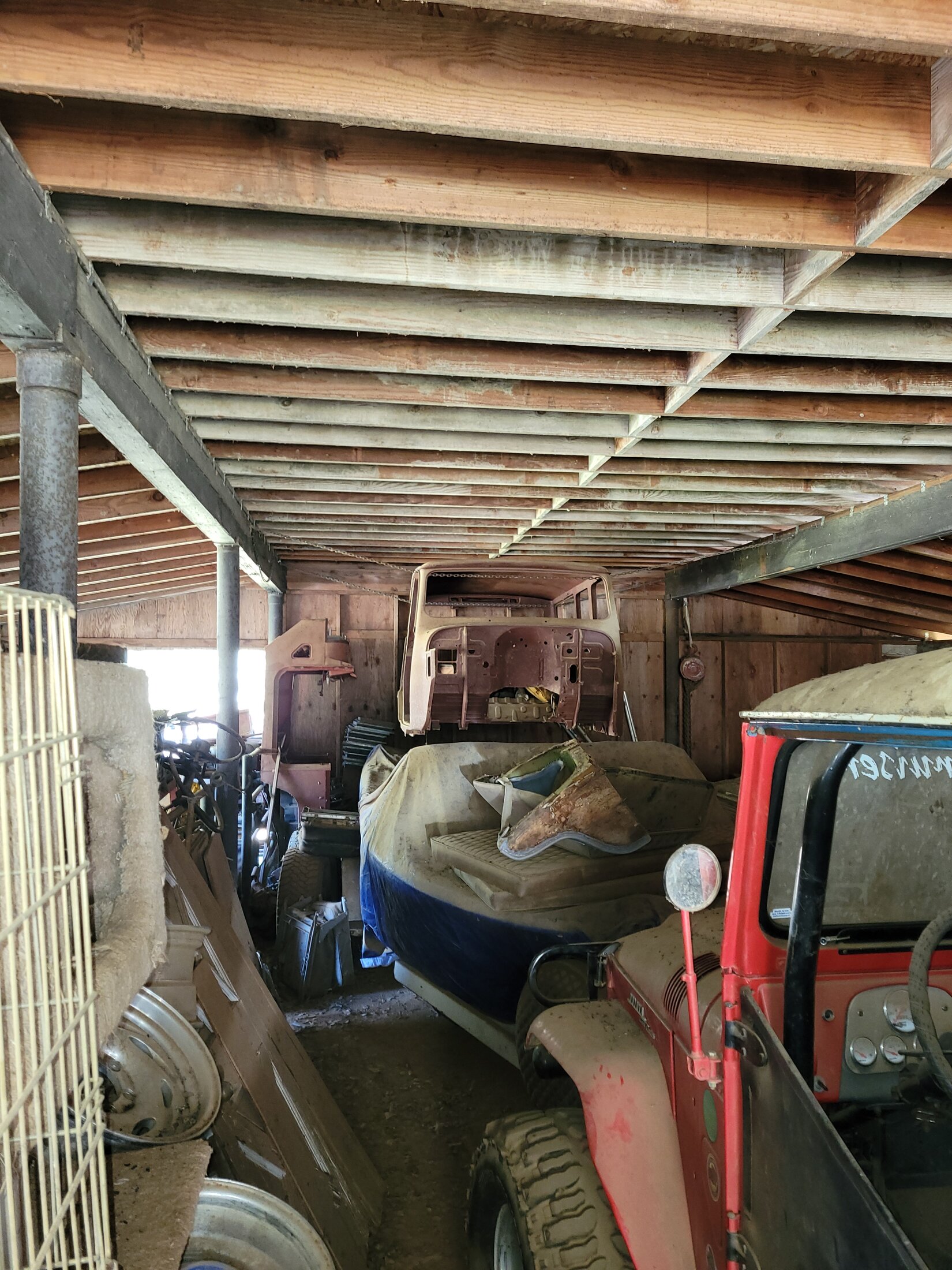

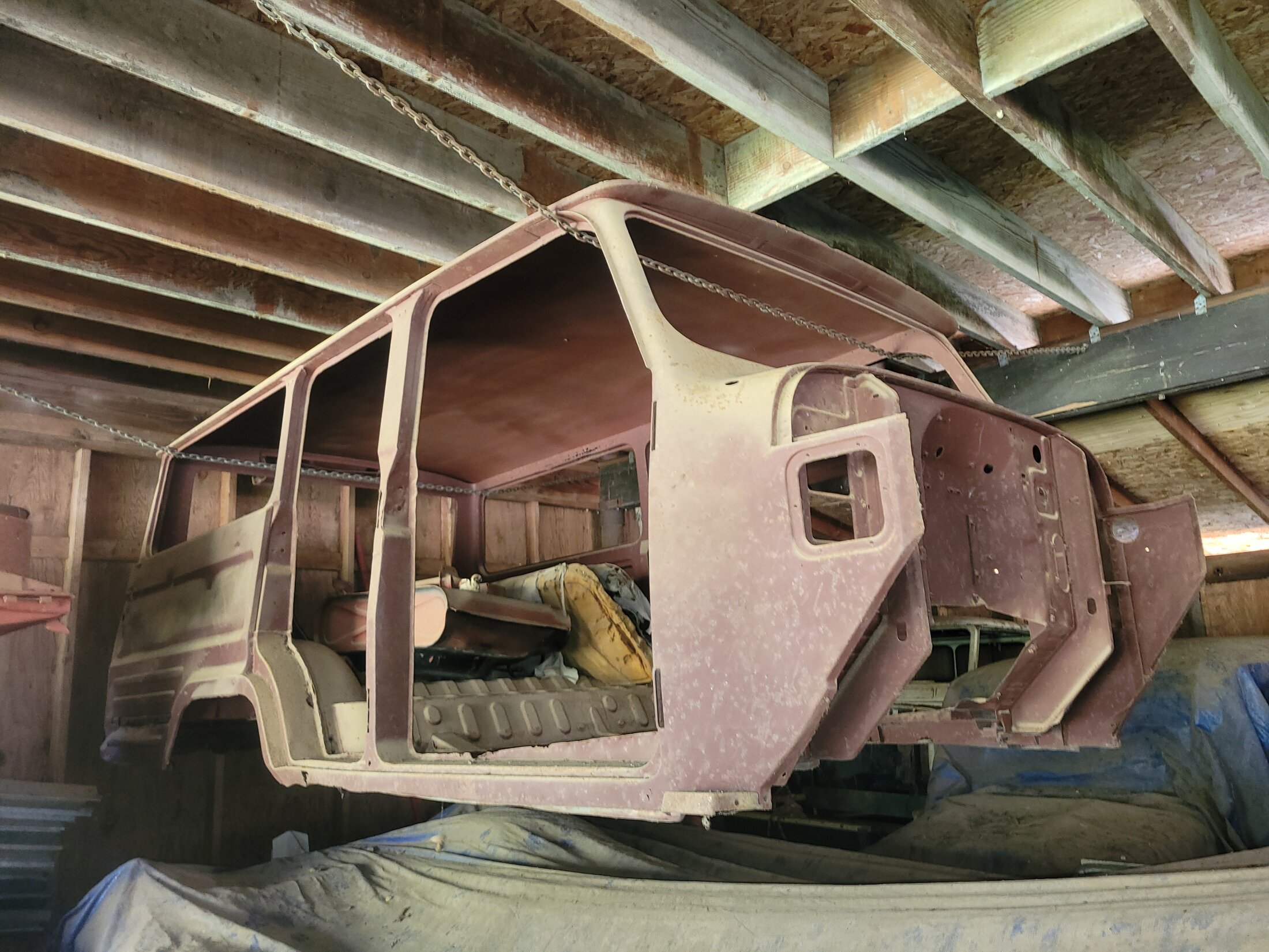

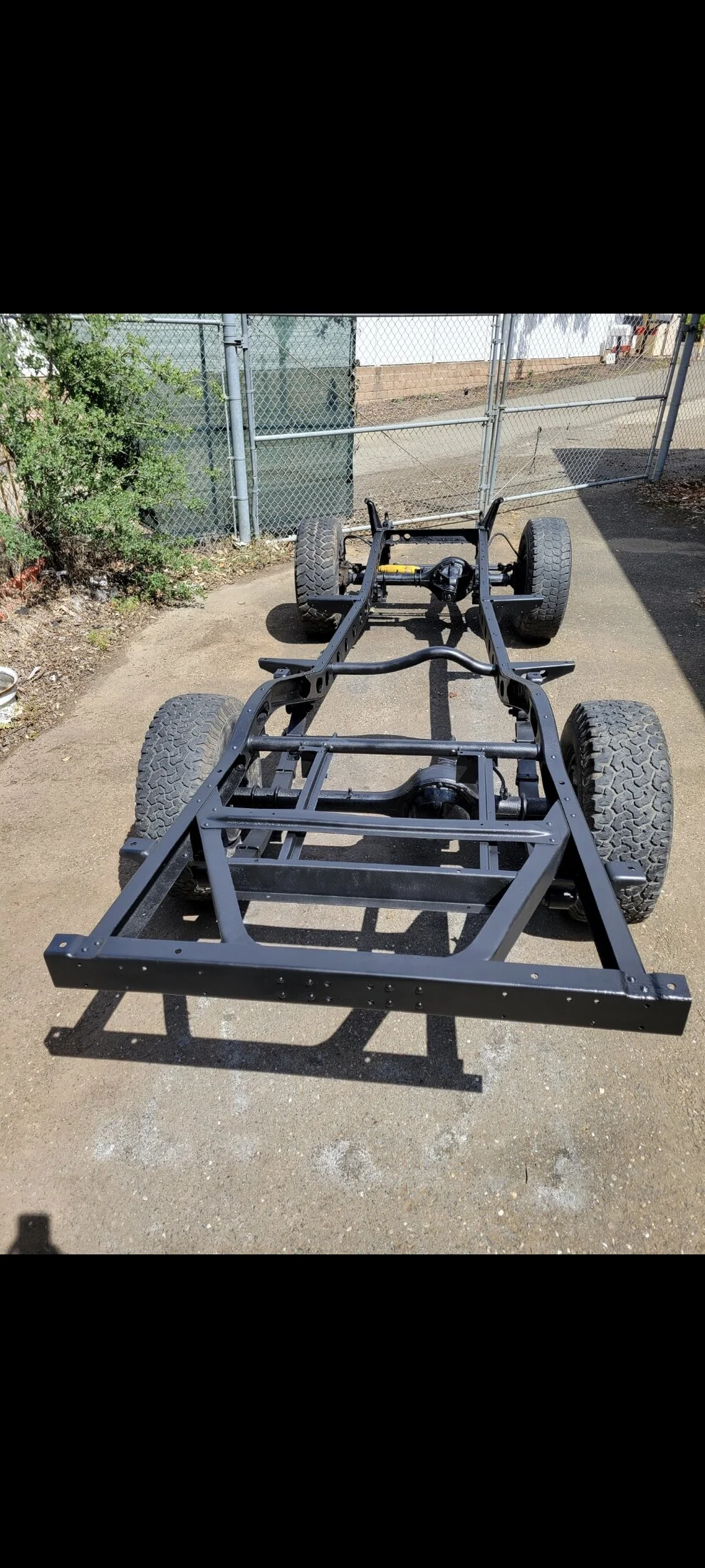

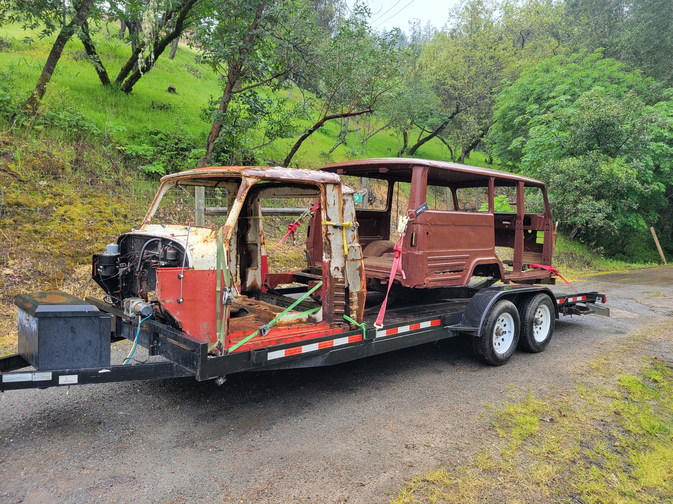

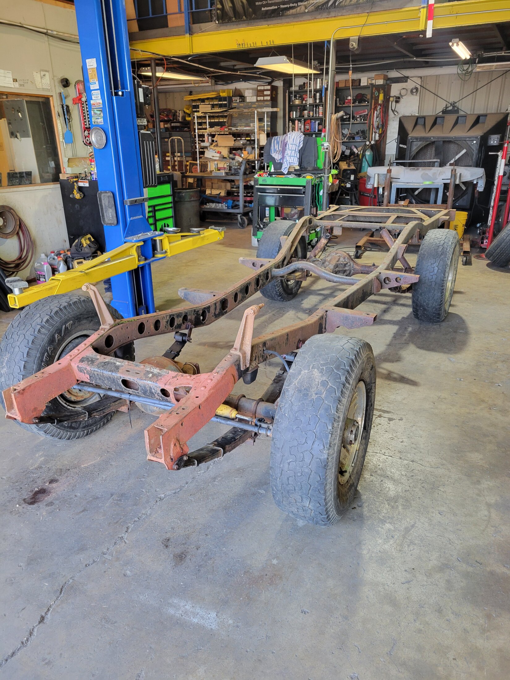

So, I thought it was time to post a build thread from the "LV parts wanted" thread. I've been working at getting this thing pieced together, collecting parts from all over the world, local, and from the LV network. Last March I acquired this LV from a Cruiser guru, talked him into selling his last LV at a swap meet, and the rest is history. After releasing it from the rafters in his barn, and carefully loading it on the the trailer with his tractor, the LV made it back home. I knew it was going to be a project and so then the LV part search began. I've been able to source most critical LV specific goodies, searching high and low. Fast forward, the body is now on the chassis and the front floor pan is next that I got from the good donor. I'll keep updating as I go....Going to be a project, but I've been told, they all are. Thanks to all involved....

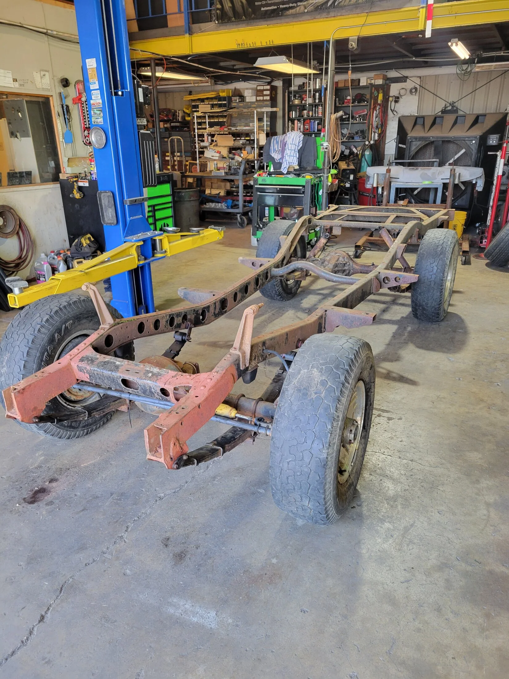

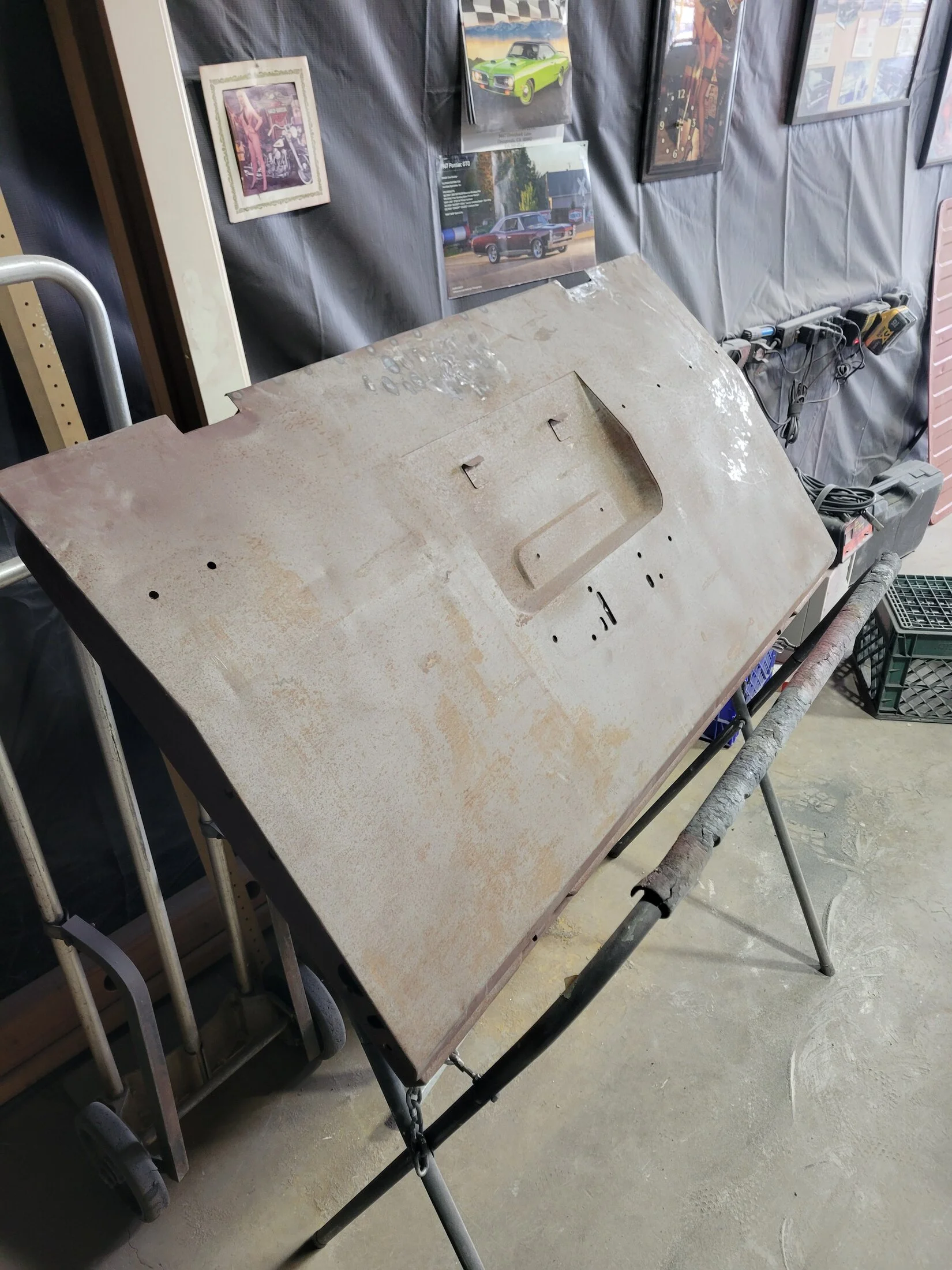

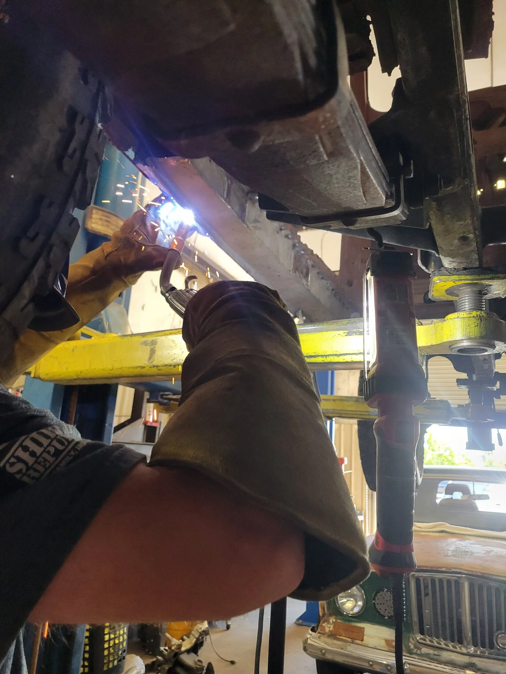

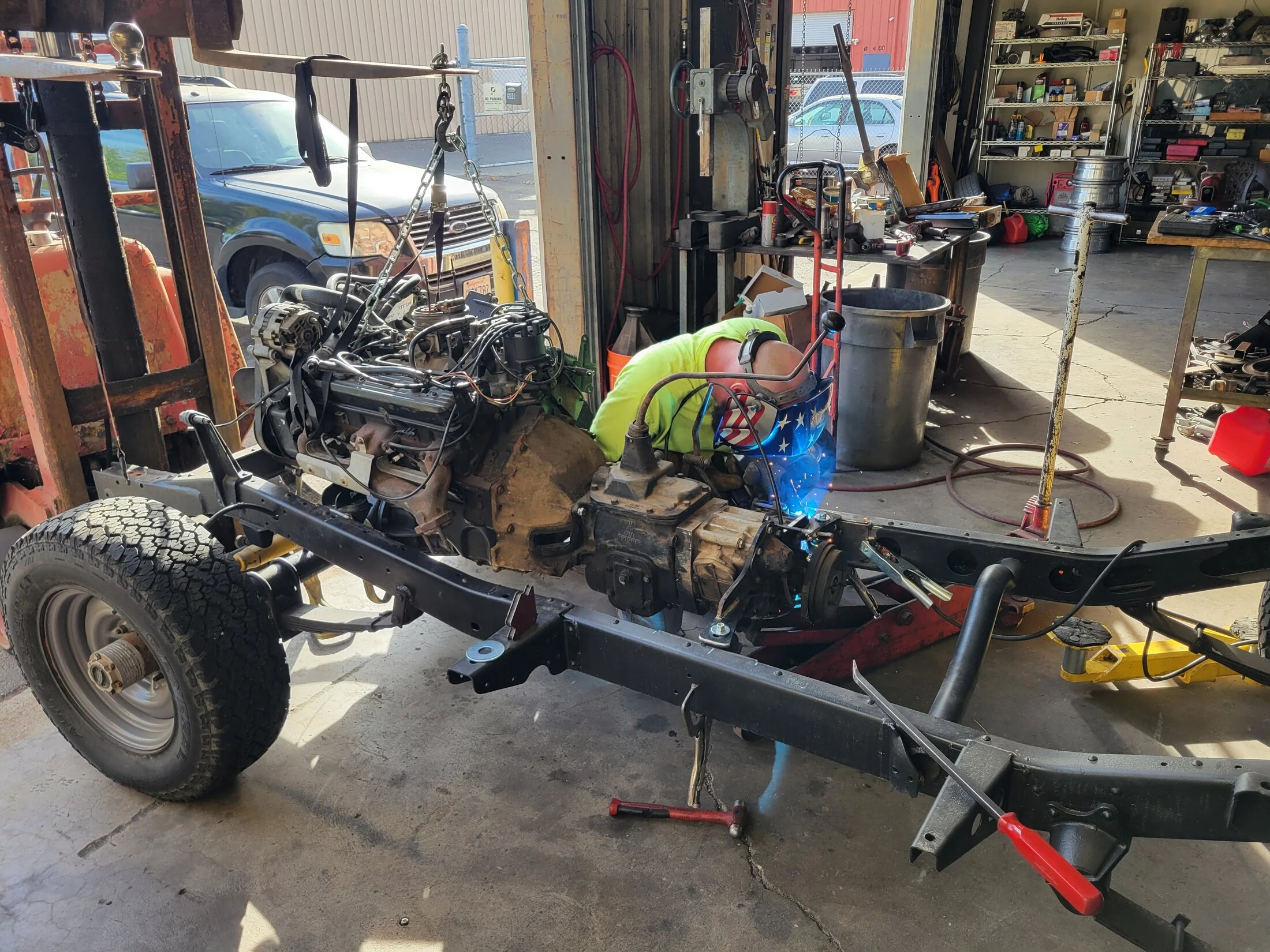

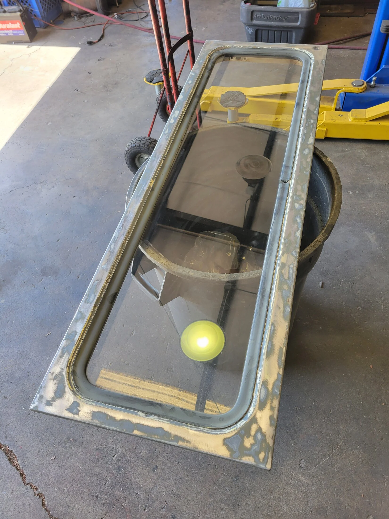

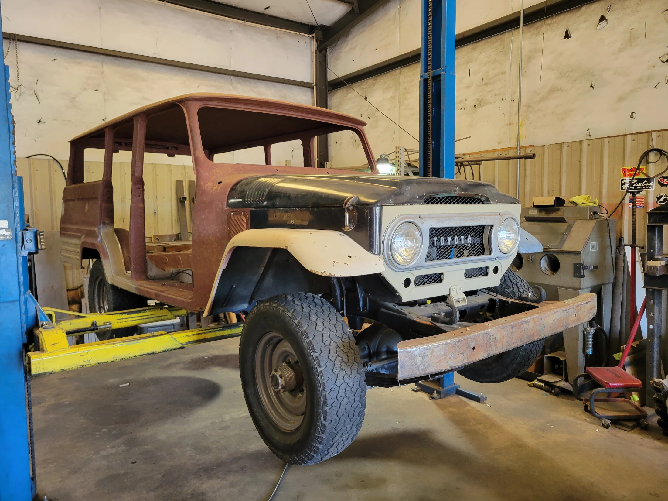

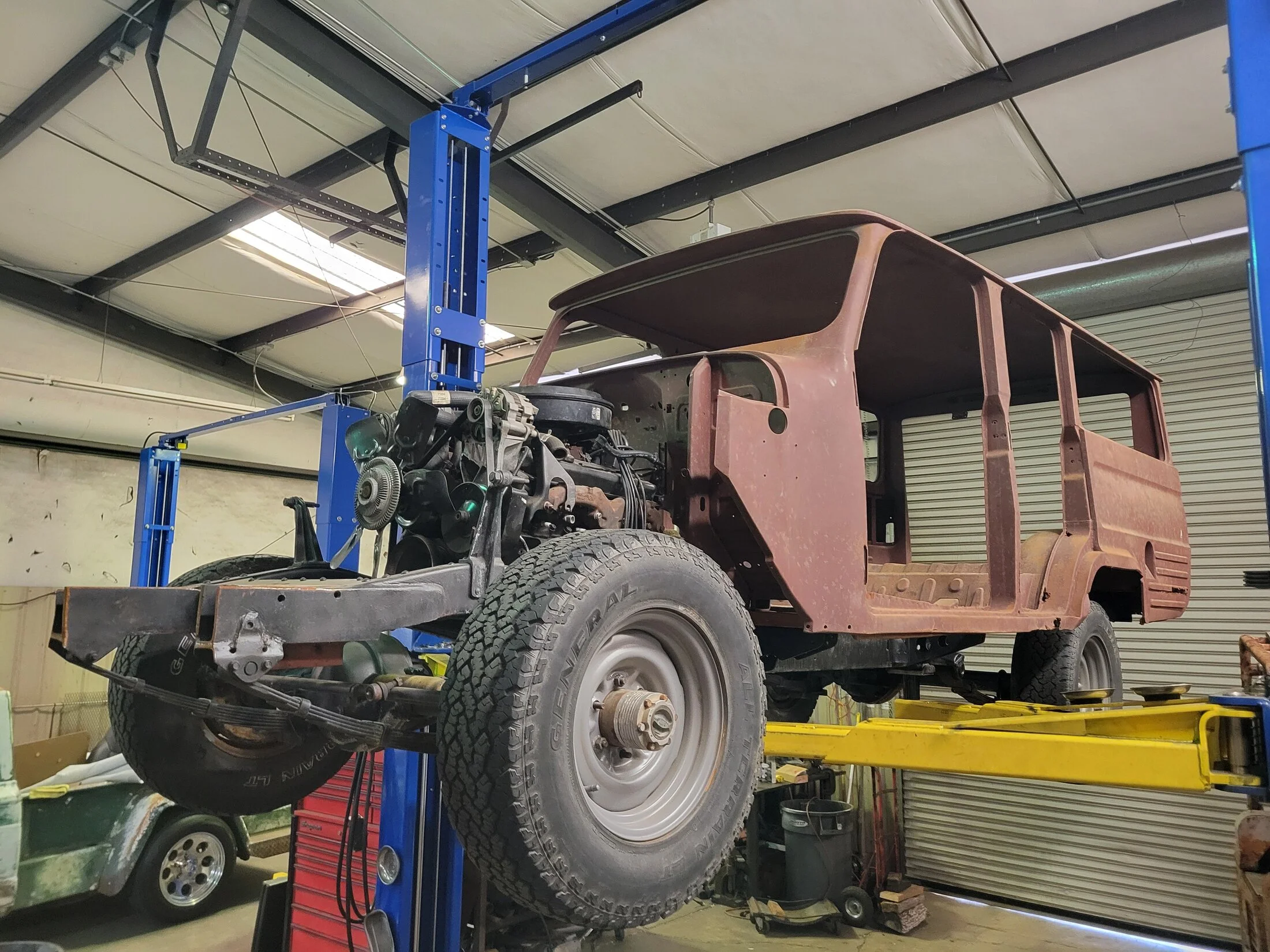

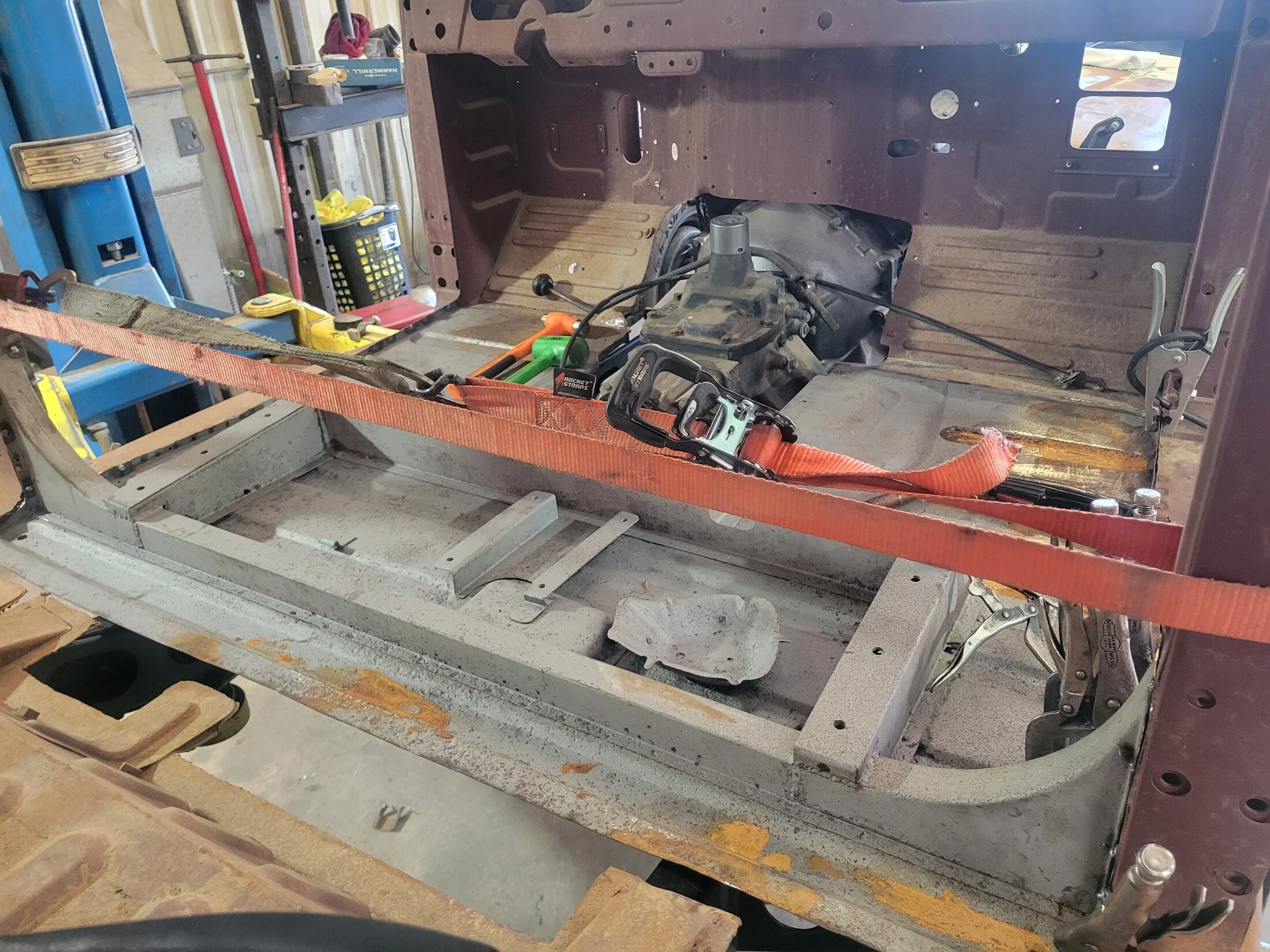

My buddy had an open rack at his shop so it was time to mate the body to the chassis. Lots of work to be done on the body yet but hey. I cut out the good floor and rockers from the donor. Time to trim and weld it in. Also, have the tailgate and hatch getting cleaned up and smoothed out. I guess the only thing good about buying an LV in pieces is that it's already apart...Right?

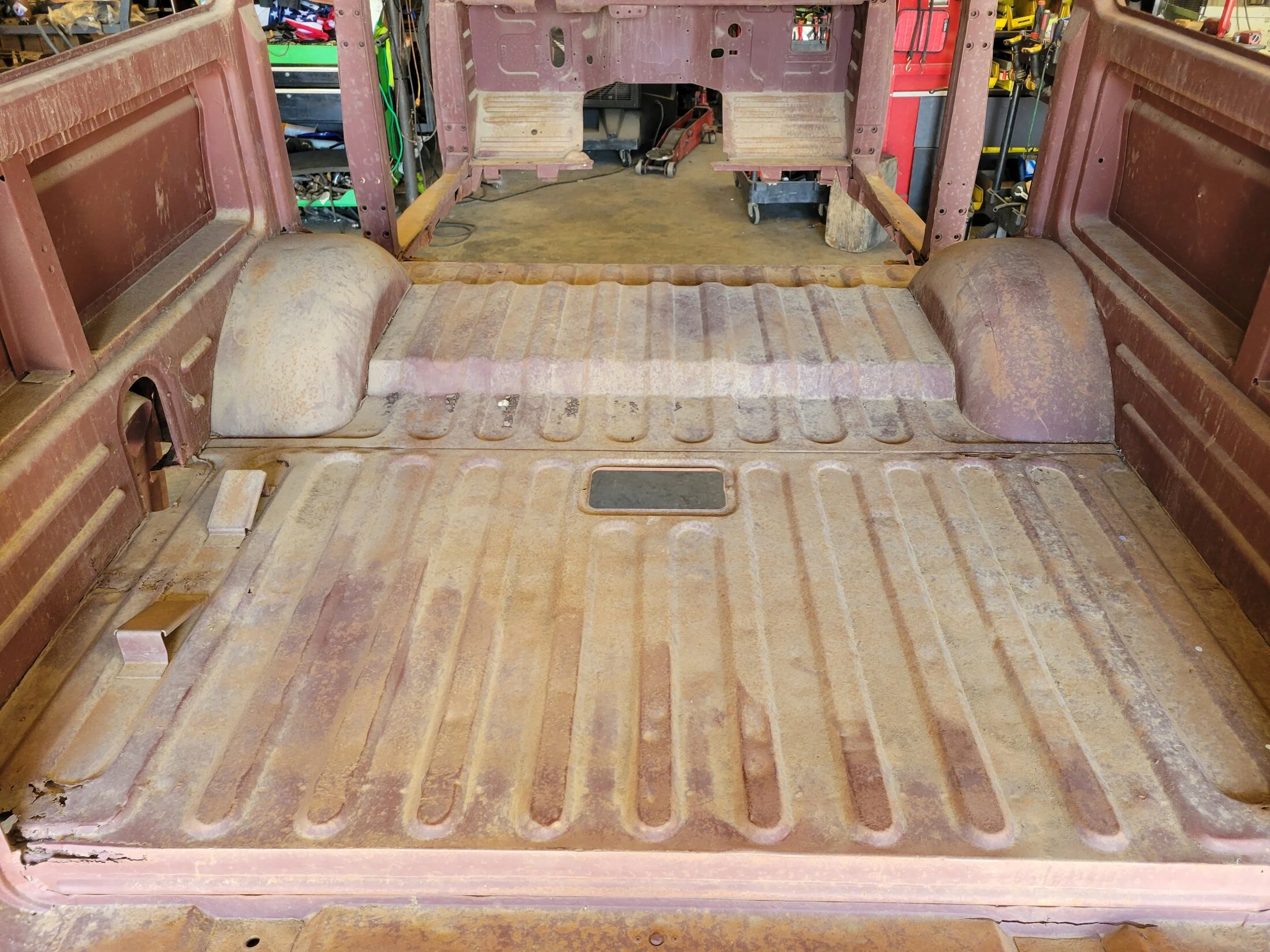

Been working on the rockers with some help from my buddies. Front floor pan almost ready to lay in there. Lot's of metal work to get it right. Thank god for the donor LV I was able to chop up and make floor sections. I seem to recall, reading, LV's take some time and patience to bring back to life. Hmmm. I know----stay focused..
So, I thought it was time to post a build thread from the "LV parts wanted" thread. I've been working at getting this thing pieced together, collecting parts from all over the world, local, and from the LV network. Last March I acquired this LV from a Cruiser guru, talked him into selling his last LV at a swap meet, and the rest is history. After releasing it from the rafters in his barn, and carefully loading it on the the trailer with his tractor, the LV made it back home. I knew it was going to be a project and so then the LV part search began. I've been able to source most critical LV specific goodies, searching high and low. Fast forward, the body is now on the chassis and the front floor pan is next that I got from the good donor. I'll keep updating as I go....Going to be a project, but I've been told, they all are. Thanks to all involved....View attachment 3900588View attachment 3900589View attachment 3900590View attachment 3900591View attachment 3900593

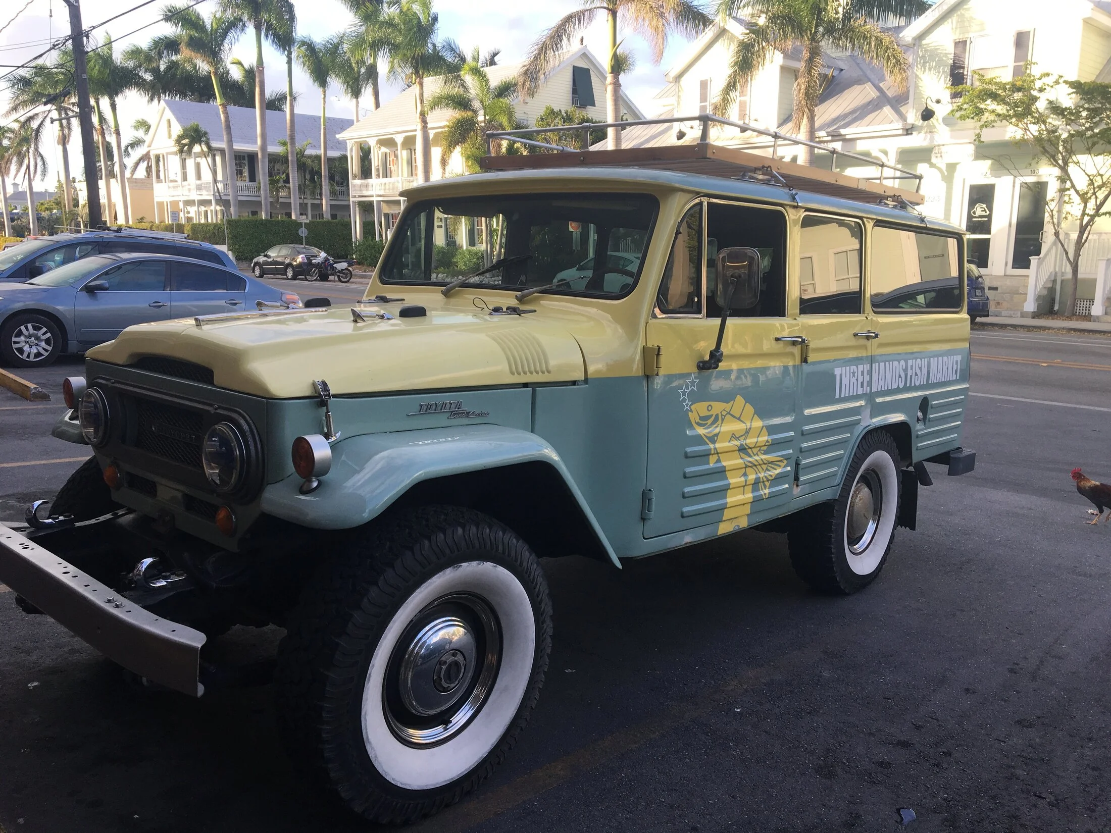

I’m finally back working on my LV after a long barn sleep that’s been 6 years. Too much other stuff going on. Thanks for documenting yours. Seeing what other LV owners do is super helpful. I did a restomod on mine 15 years ago and used it a lot then. I displayed it at my restaurant in Key West. Big mistake. The salty rain got into the doors and around the windows. Bubbled up a bunch. So back to bare metal in those areas and the paint. This is really a refresh this time. Your restoration is much more involved. These pics are just after the resto in the early 2000s. The colors are LV correct. But obviously the combo is not. It’s a Chevy 350 swap. I bought it in Colorado without any engine.
Keep your updates coming. I will share mine.

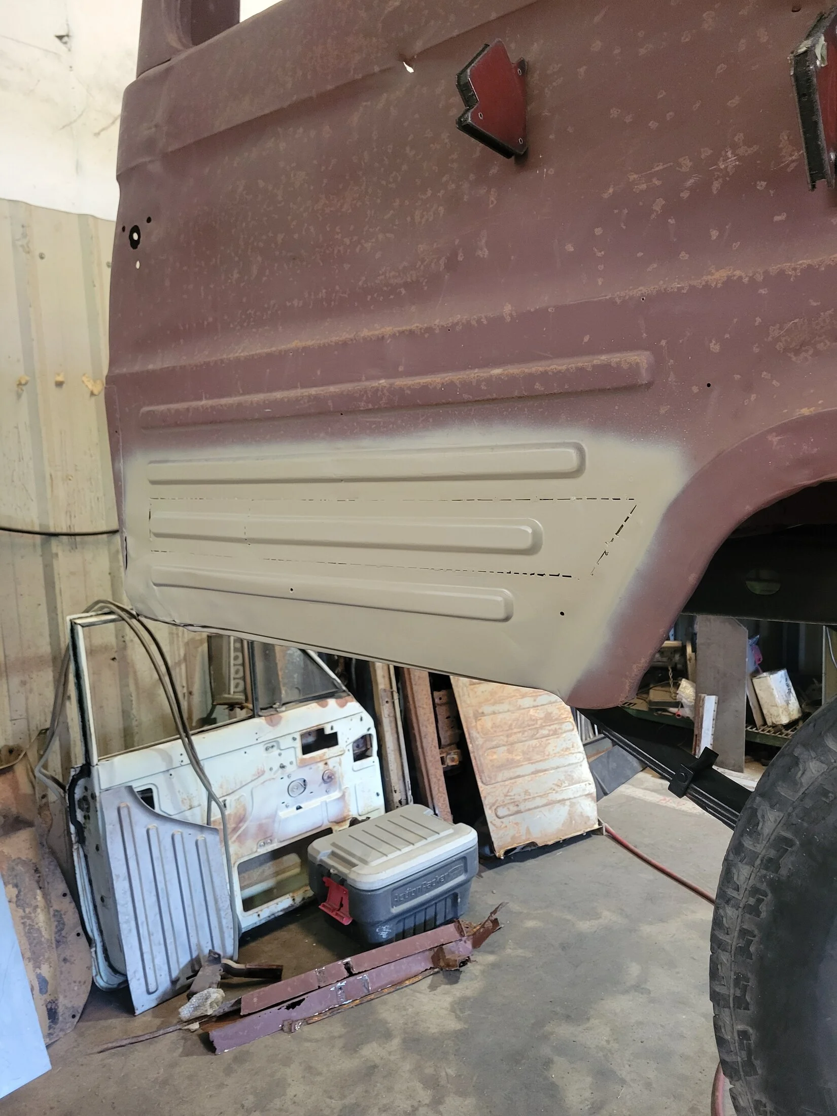

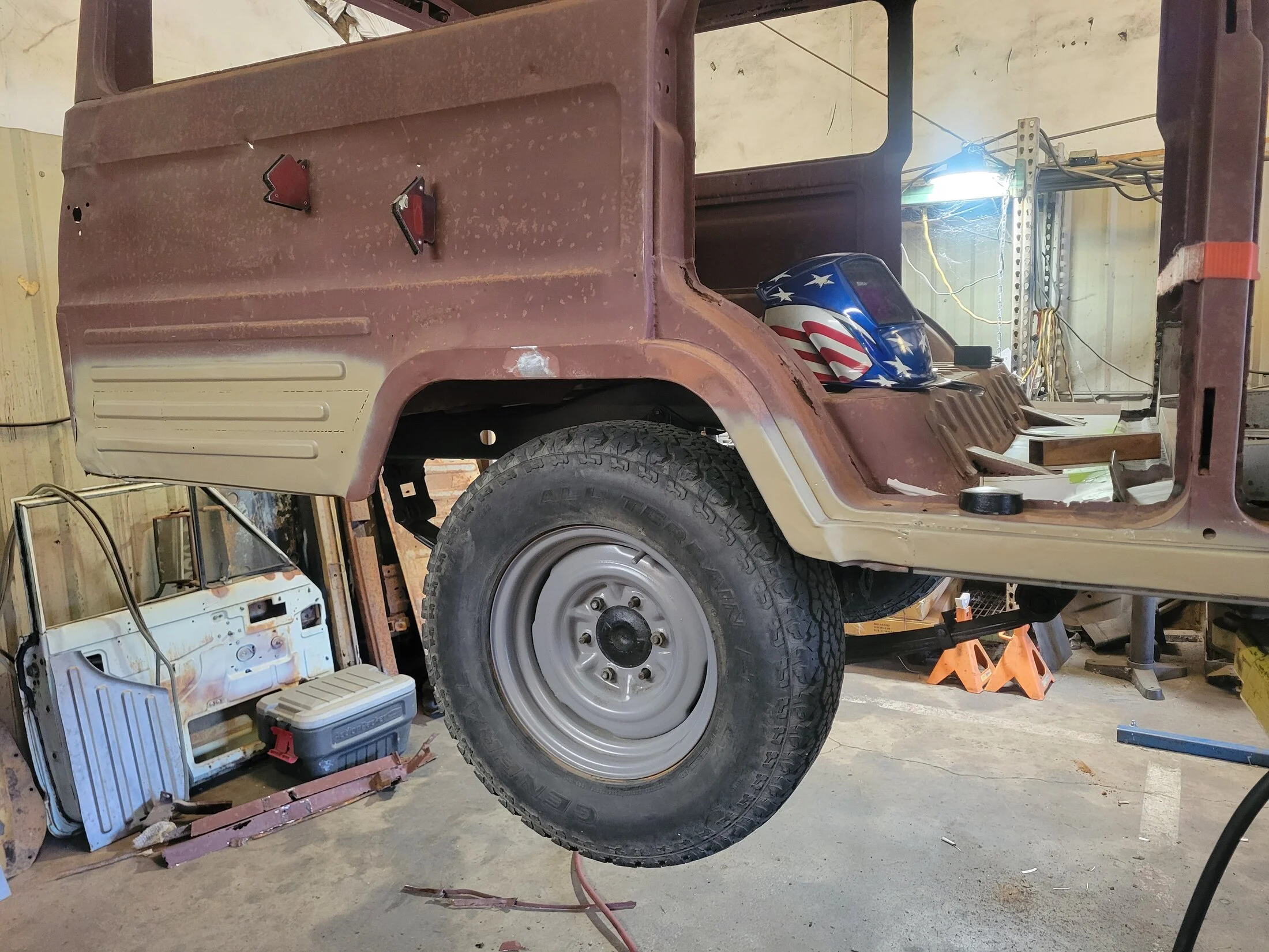

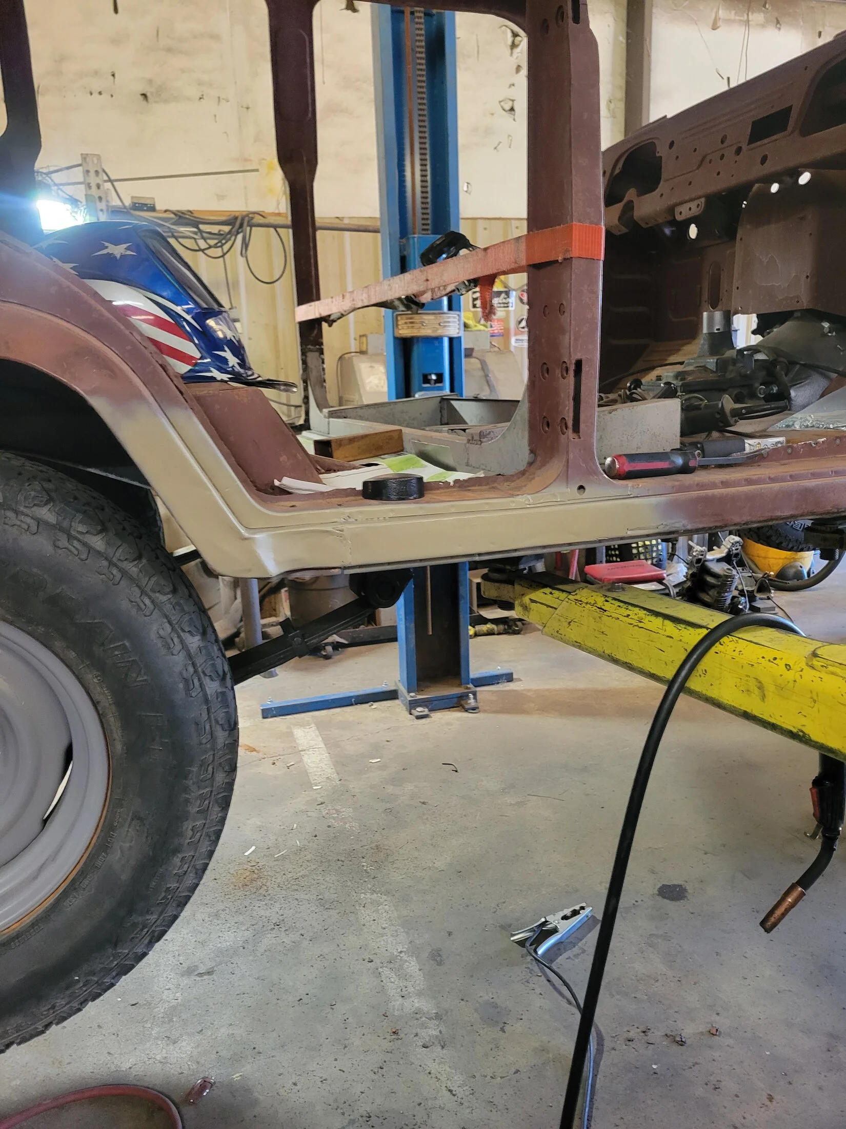

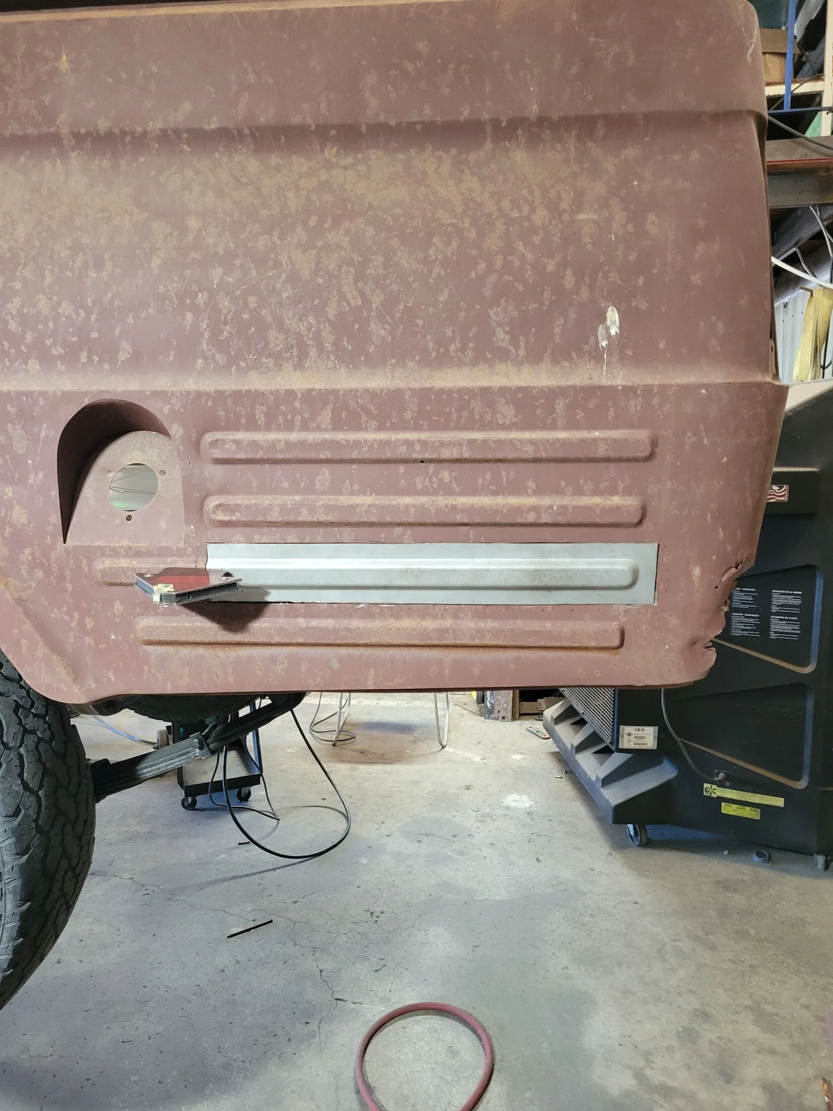

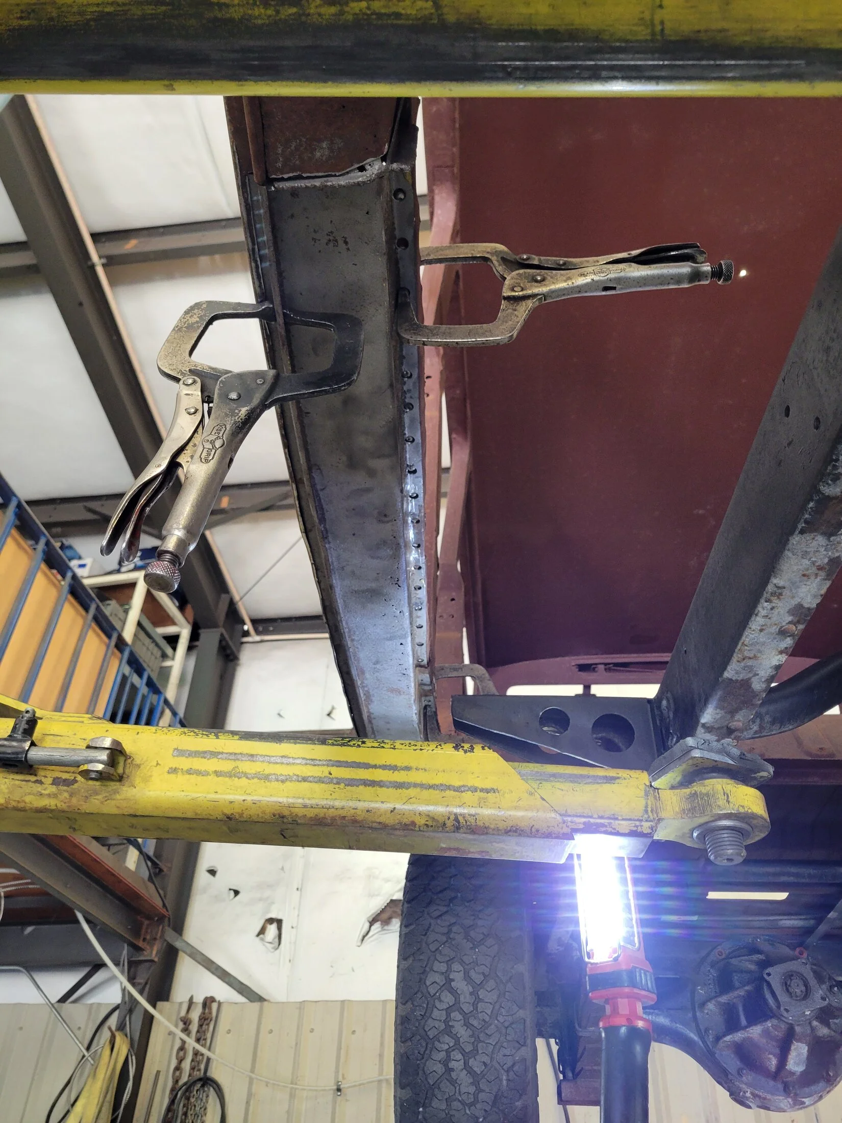

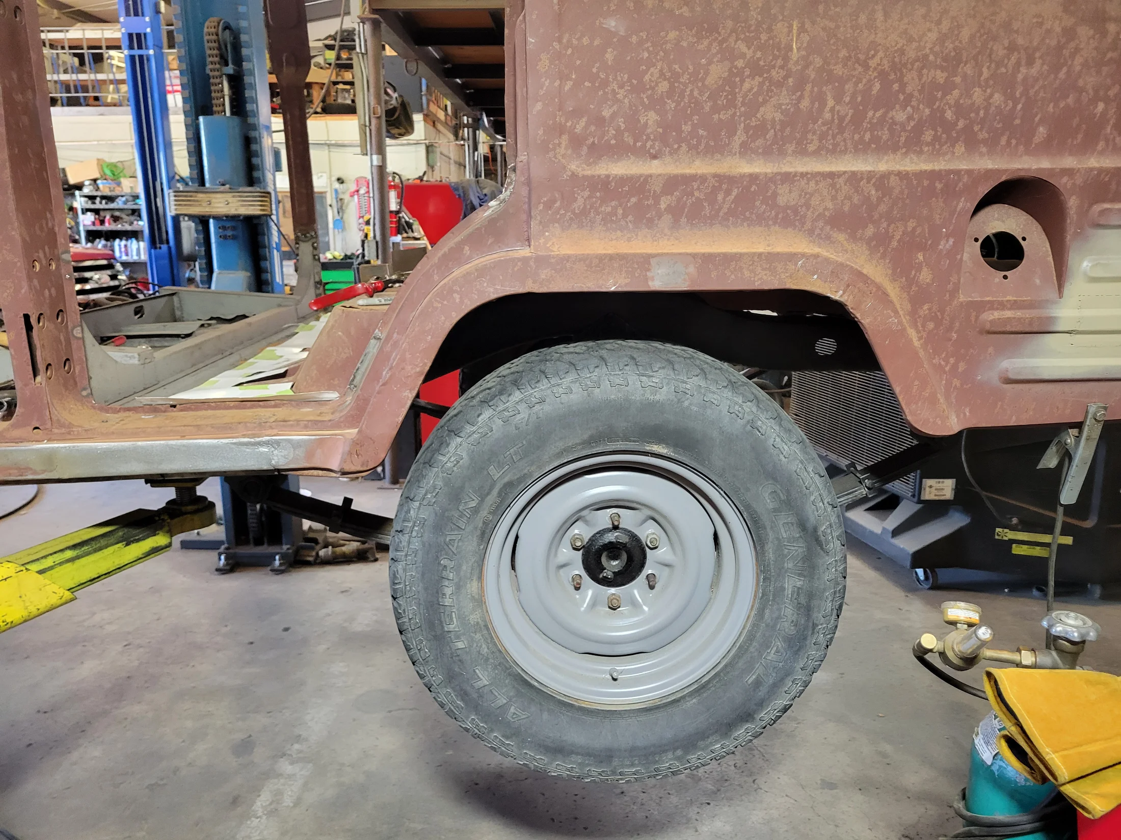

Here's some more metal work updates. Passenger side rocker and rear quarter getting some love along with various holes that were drilled in it's past life. Start to work around to the driver side quarter and rocker. It's nice to have patch pieces to cut in. The 2 rib sections came from outer door skins. Then under the tailgate is next. Once the initial metal work is done, some finish welding, and then bondo time. The good news is that everything that bolts up to the body is straight and solid.

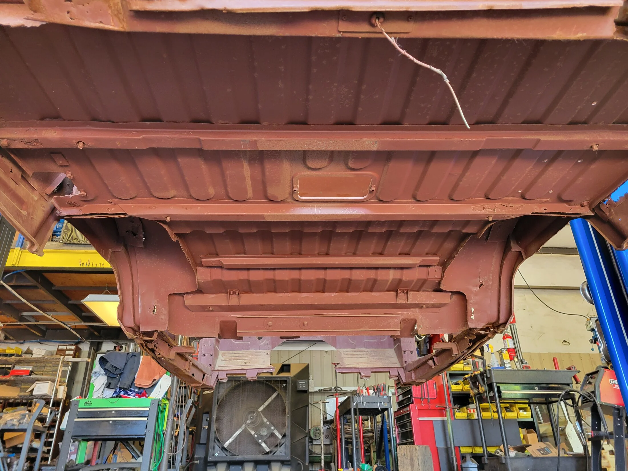

So, more progress pics of the driver side rocker metal work, some rust repair, hole in cowl, and mock up of the front clip. Spent some time on the driver fender well. Got some adjusting to do on the clip but seems to line up pretty well. Its finally starting to take shape. Have to finish the rear floor section and onto the rear quarters and under tailgate section. It's rough.....fingers crossed. Thankfully I have a rear section that came with the purchase I can cut sections from. It's not bondo time yet, but it's getting close. I acquired a Toyota front disc conversion set-up, and a period correct rear housing with factory sway bar setup. Just need to put them together.

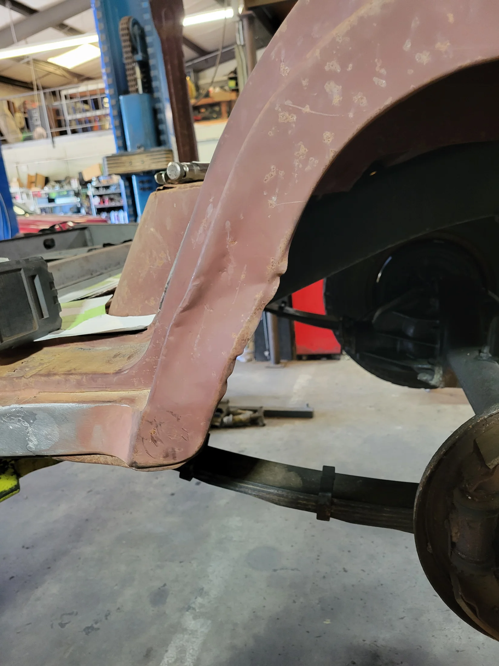

Well, I'm way over due for an update so here we go. The project has been steady since my last post and some of you have seen the progress. Finished the small rear floor section with flat steel. Metal work is nearing the end with body filler coming into play. The rear corners and under sill were rough, and took alot of measuring and precise cutting and fab work for the new sections to take shape. Fortunately, I had a few pieces/panel sections from the purchase that I could make work. I can not thank the LV guru's enough out there for all their insight and advice. I cant wait to finish the metal work, ugh, get it primed and start bolting/mocking up all the pieces.
