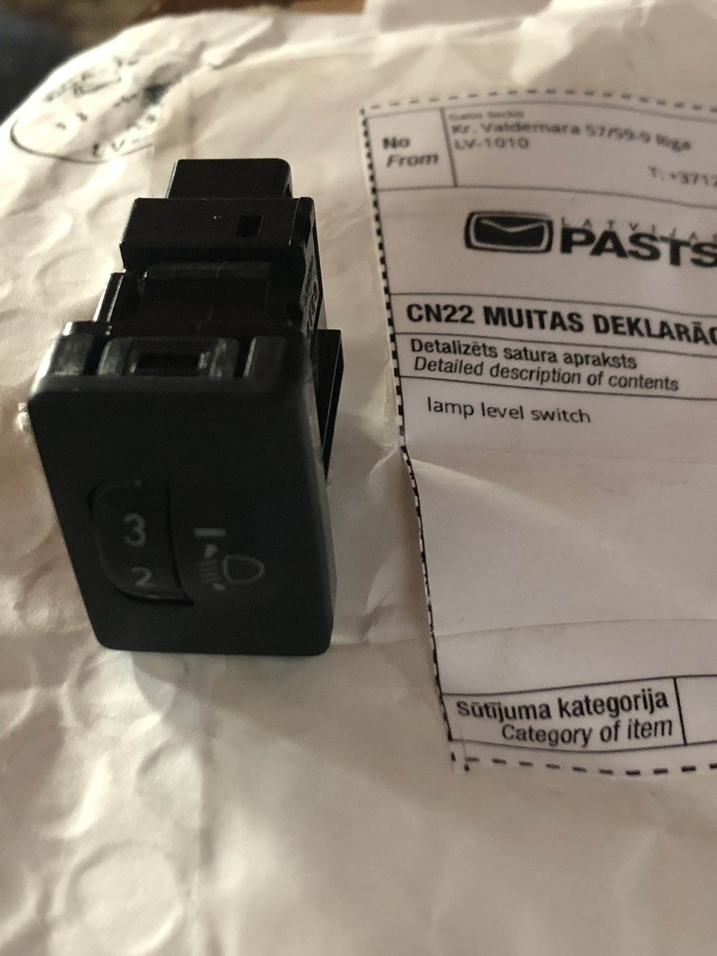

After a very long shipping time from Latvia (several months, with the last month of it a delay in the USA), my switch arrived.
Now to look up the wiring diagram for wire colors, and then to see if there is a harness for it in my ‘16.
If it comes down to a choice between one or the other (auto vs manual leveling), I’d prefer manual.
