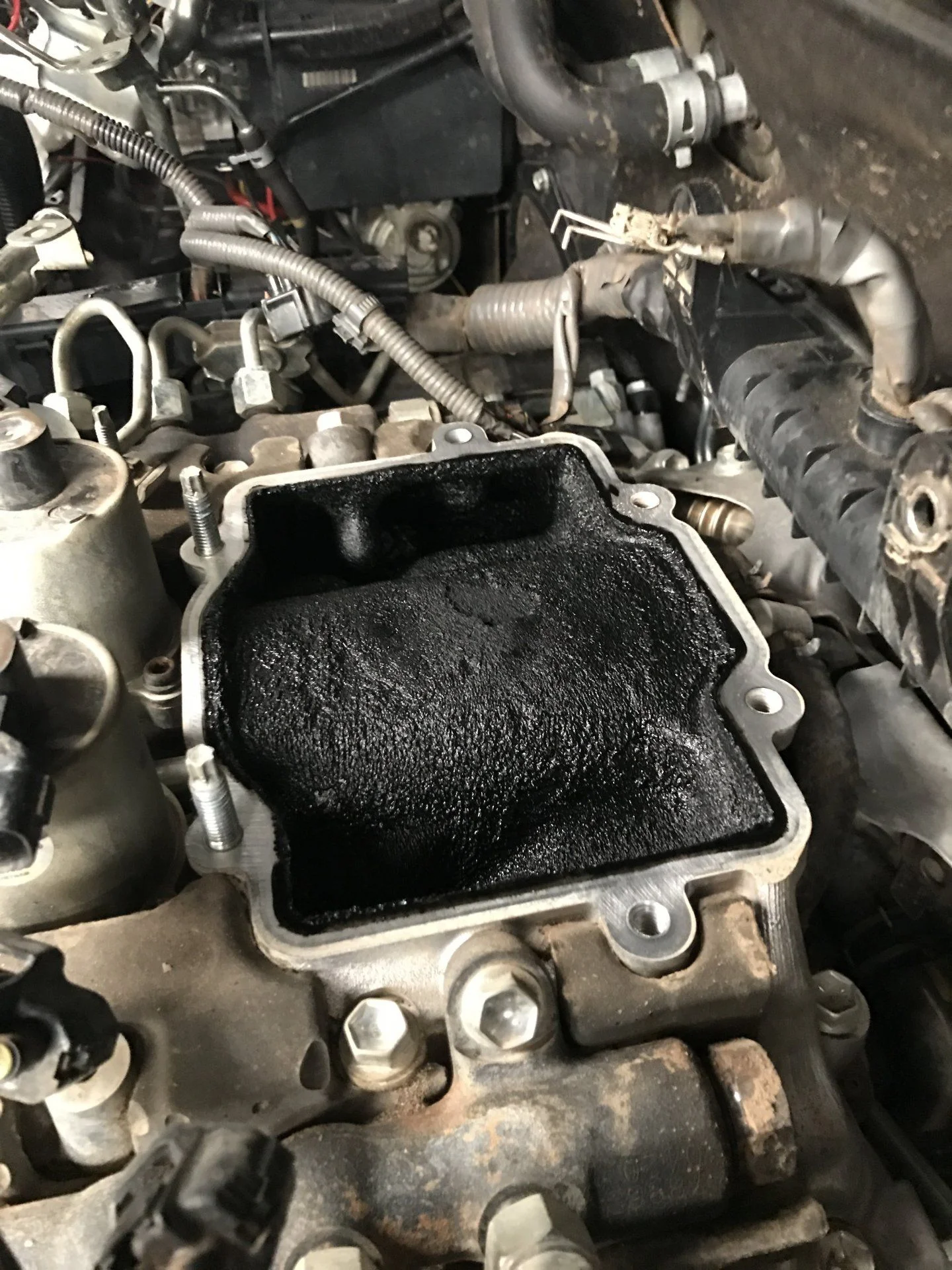

This was 70K with no catch can or EGR off

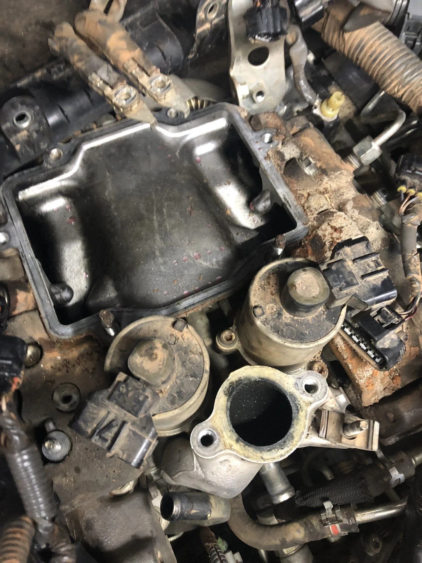

This was 170K with EGR blocked and a catch can fitted (not coolant was from the removal that splashed
not a leak
Awesome, that pretty much answered my questions. Will do the complete block off and catch can soon
