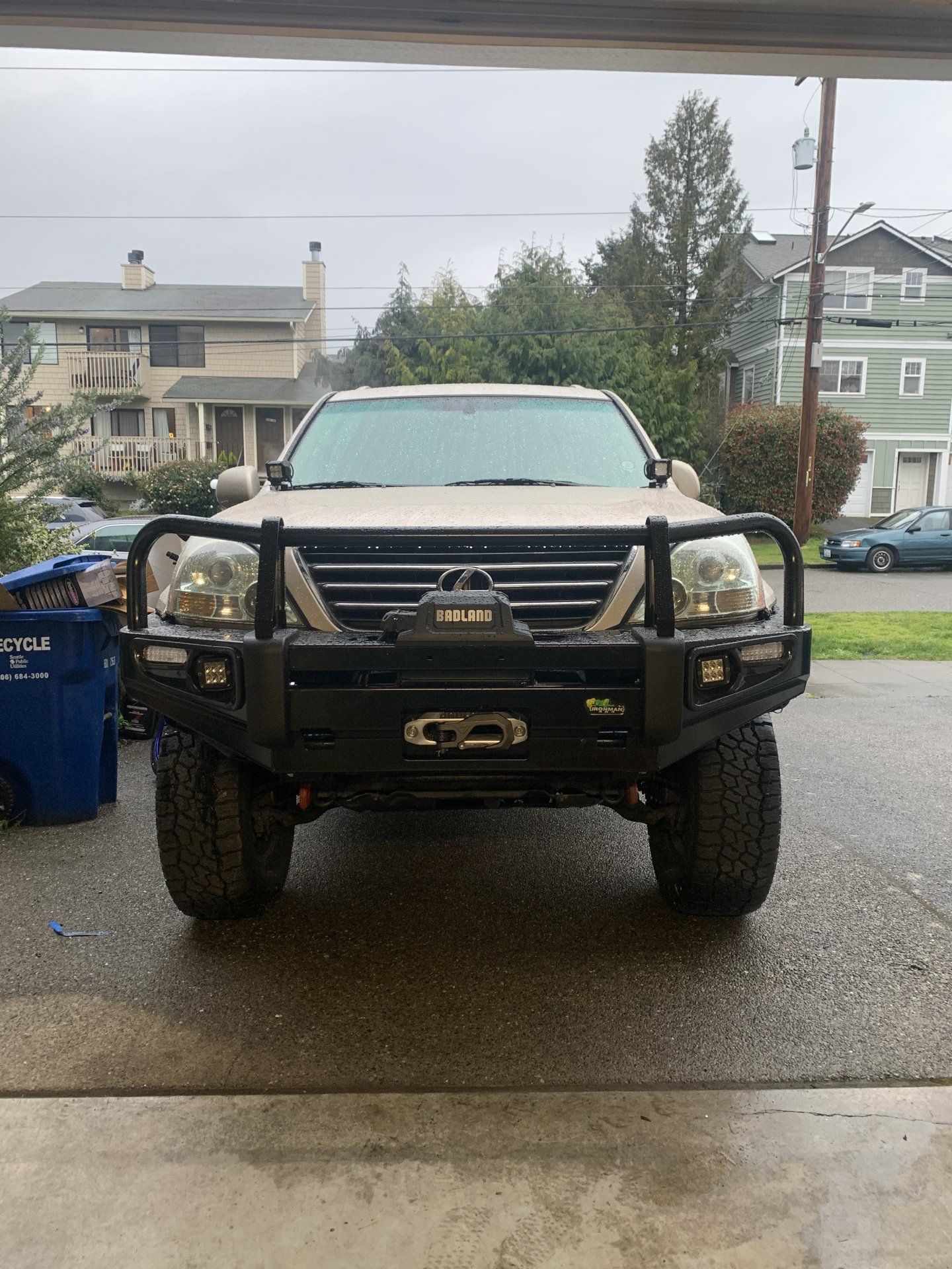

Ironman bumper installed this week. Minus the skid plates that go to it. Vendor sent the wrong ones so need them still.
My rig:
GX 470 2007
Dobinson 3” IMS Heavy springs
General notes:
- if anything go slow and measure like 5 times for each cut
-Do not cut anything till you set the bumper roughly where you want it to sit
-Floor jack helps a lot to support it. Did it alone and floor jack helped lift and push it forward
-Get door edging. Like previously posted..the ones that come with it are garbage
-Toss the hardware and get grade 8 hardware
-Oscillating tool cuts the fender like butter and helps a lot. Easier than the angle grinder
-Works kinda with the apex overland recovery points. Need to add another hole to allow use of the “U” bolt connection
-Bumper has lots of gaps in the under side to hide wiring. Works quite well with zip ties
-Total weight of the bumper and winch is about 175-200 lbs
-I marked a line on where the bumper bracket sits with the frame so I know where to line it up anytime I take it off

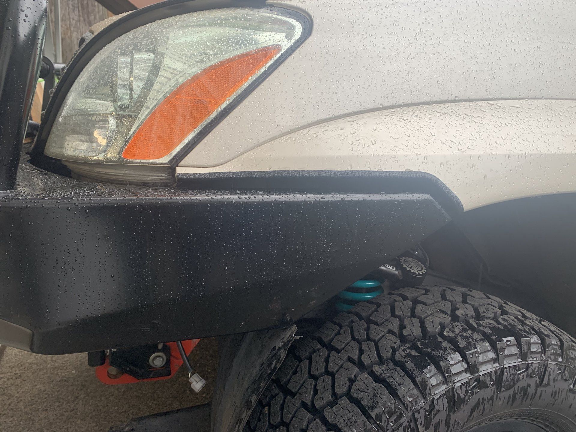

Bumper Side Fenders:
-Get a plastic pry tool to remove the outside fenders. It has some adhesive on the top edge so you need to pry a bit and release that too.
-Go slow and cut the inside metal first. ONLY after you have set the bumper close to where it needs to set
-With the bumper mounted template it with a spacer to draw a straight line. Do not cut this till the inner and bumper are set. This is the last step after everything is mounted
-Edge with car door edging for both the inner and outer fender to clean up your edge
-Leave a gap if you are going to off road at all. Body and bumper will flex a lot
Bumper Install:
-Floor jack is your best friend
-Keep some of the packaging on it if you want to protect it

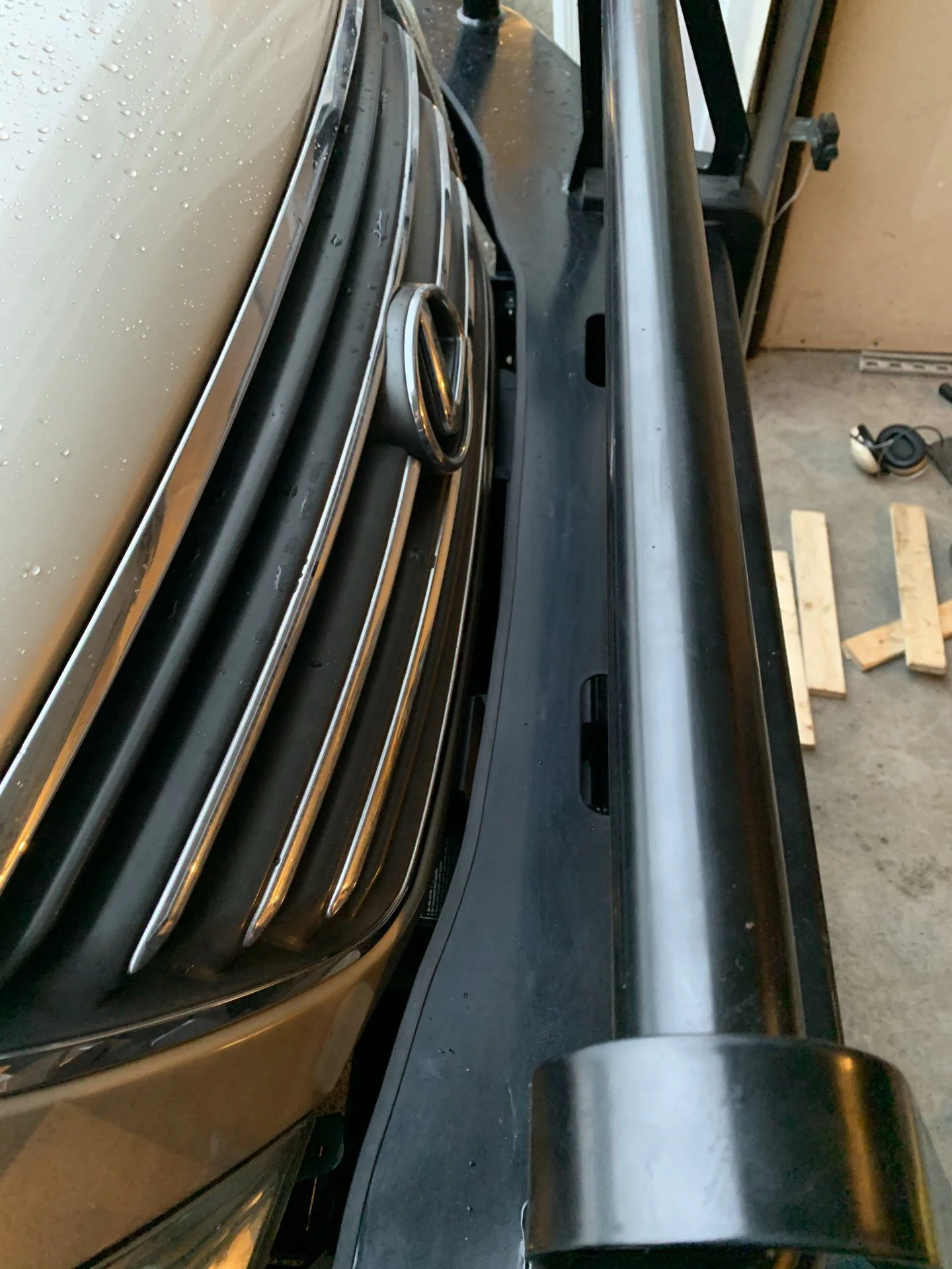

-Template the hood to the bumper and don’t free hand cut it. Use a spacer similar to the fender
-Angle grinder worked great to cut the bumper top. -Go slow and take your time.
-Touch up with some paint and edge trimmings if you can
-Do not fully tighten bolt till you have it set where you want then tighten them down
-Make sure your hood clears the top tube before you set it. I set it fully up and in and found out the hard way
-Center your bracket as early as you can. This will be your last chance before you add the actual bumper.
-For me the bumper angles slightly down. To allow hood to clear. You may be able to level it if you are bending the hood slightly
-Wiring for the bumper went directly to the stock wiring for headlights and turn signals. I removed the round fog lights to allow the rigid industry ambers
Winch install:
-Badlands apex 12k fits just fine
-Bend the ac lines a bit back so it clears
-Add some fuel line to protect the tubing. I still need to do it and prevent rubbing
-Head/control box does well on top of the bumper. Need to drill 4 bolts to mount it
Probably more but this was just the initial brain dump. Thanks for reading though and happy to answer questions

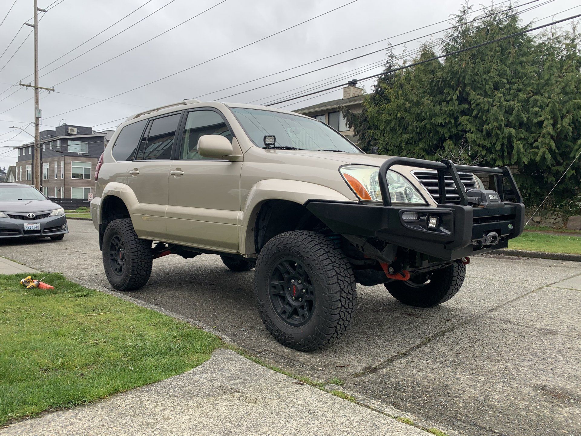

Kind of related but also not… which springs did you use front and back? Seems like you definitely have all of 3” lift if not a tad more
Dobinson IMS 3" heavy springs and LT rear. Full build here on this thread.
