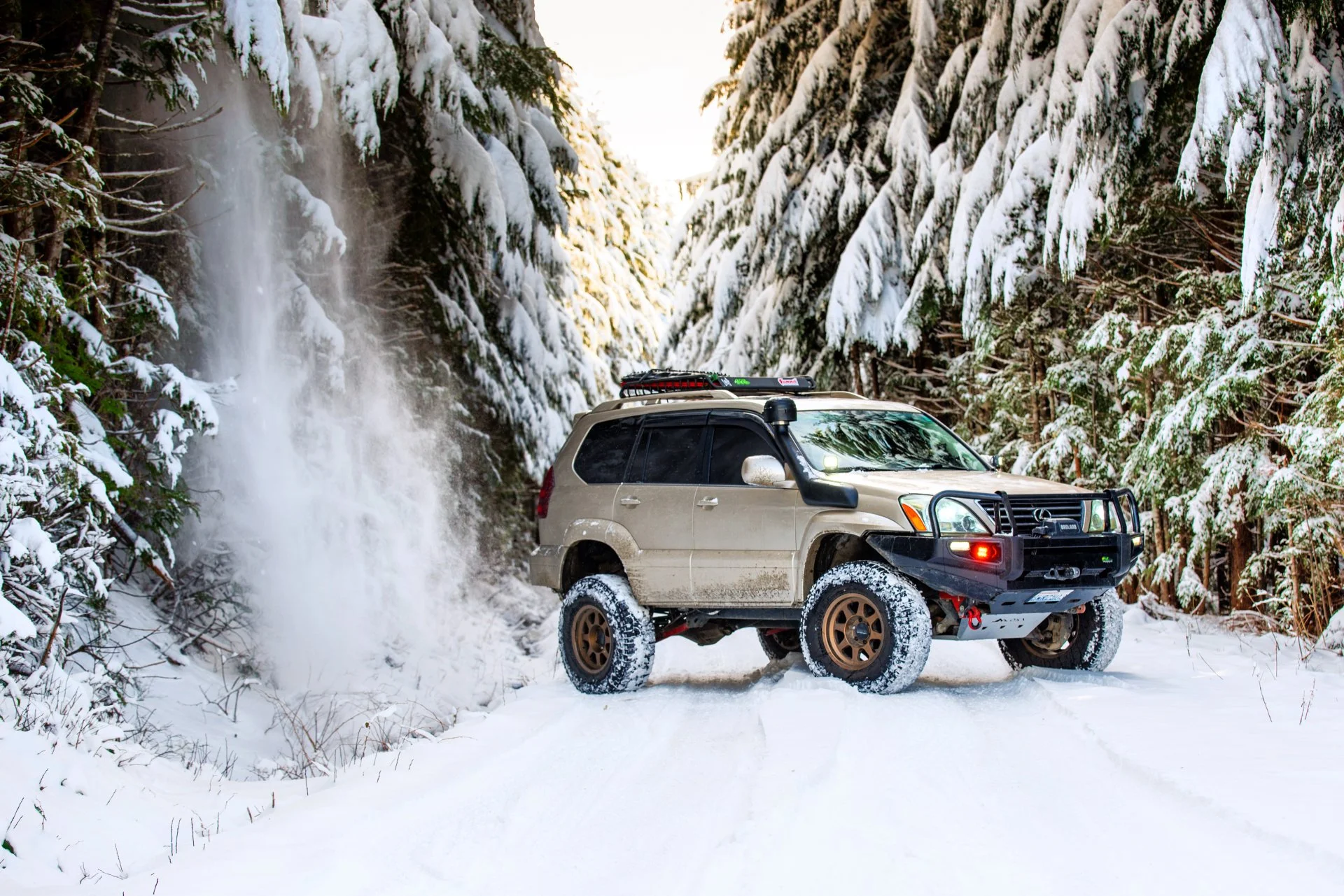

Finally coming around to posting my PNW Gramps Gold GX470
Come along way since I gotten it stock but here it sits as of now and some future plans for it.
IG: https://www.instagram.com/pnw_trailbound/
--Car Specs and Facts--
  • 2007 GX470 in Gramps Gold/Old man Tan
  • 205k miles
  • Purchased stock 1 year ago
--Suspension and Wheels--
  • Dobinson 3” IMS heavy springs and long travel rear. Really need to weigh these down still. IMO heavy is way too stiff without gear
  • Apache UCA - Don't hate them, don't love them. Wish I got the SPC sometimes for the extra adjustability
  • Energy Suspension bump stops - 9.9101R
  • Apache rear bump stops on steel tubes
  • RezFab rear lower and upper arms - Red. Beefy units if you can get your hand on a set
  • Method MR701 -12 offset Bronze
  • Spidertrax Spacers 1.25" - TBH too much for my liking with the -12 offsets already.
  • Wildpeaks 285/75/17
--Armor--
  • Ironman bumper - Heavy, beefy, and cheap for what it is
  • OK Expedition Skid plates Aluminum - TBH really fair value for what they are. I'd recommend them if you aren't rock crawling
--Engine/Air/Mechanical--
  • Ebay Snorkel with Snorkel Upgrade prefilter - If you go with the cheap snorkels..be ready to do some retrofitting
  • Magnaflow Overland exhaust - Nice rumble bumble. But drone can get annoying at times.
  • X2 Power AMG Group 27 Battery - Do get the voltage GM diode
  • DIY Blue Sea Fuse box and trigger switches
  • Pedal commander 38 - helps with the larger tires..but honestly its too sensitive
--LIGHTING--
  • Rigid industries amber spot lights in ironman bumper
  • Amazon cheepo ditch lights - Don't recommend these. They are trash.
--Recovery--
  • Apex overland front recovery Points. Yes these work with the ironman bumper with a few mods.
  • Set of 4 maxtracks
  • Harbor Freights Badlands Apex Winch 12000
  • DIY Winch extender with 3/8 Dyneema 150'
--MISC Mods/Gear--
  • DIY Rubber sheet rain guards in wheel wells
  • Wellvisers rain guard
  • DIY Window tint..yeah get this done by a pro
  • Lexus free side step lights turned down for rock lights
  • Diff breather extension for the rear diff
  • Cheapo roof basket till I get a full rack
  • Gazelle T4 Plus overland tent...this sucker is MASSIVE. Get a roof rack if you want this
--FUTURE MODS-- *LOOKING FOR RECOMMENDATIONS
  • Gas tank skid plate
  • Rock Sliders
  • LCA - leaning towards the Superpro Offsets
  • NEW Rear end. 8.2 or Diamond
  • ReGear
  • Lockers Front and Rear
  • Roof Rack - Leaning on Sherpa
  • Rear bumper and tire carrier
Thanks for reading. Happy to answer any install questions or in general!
