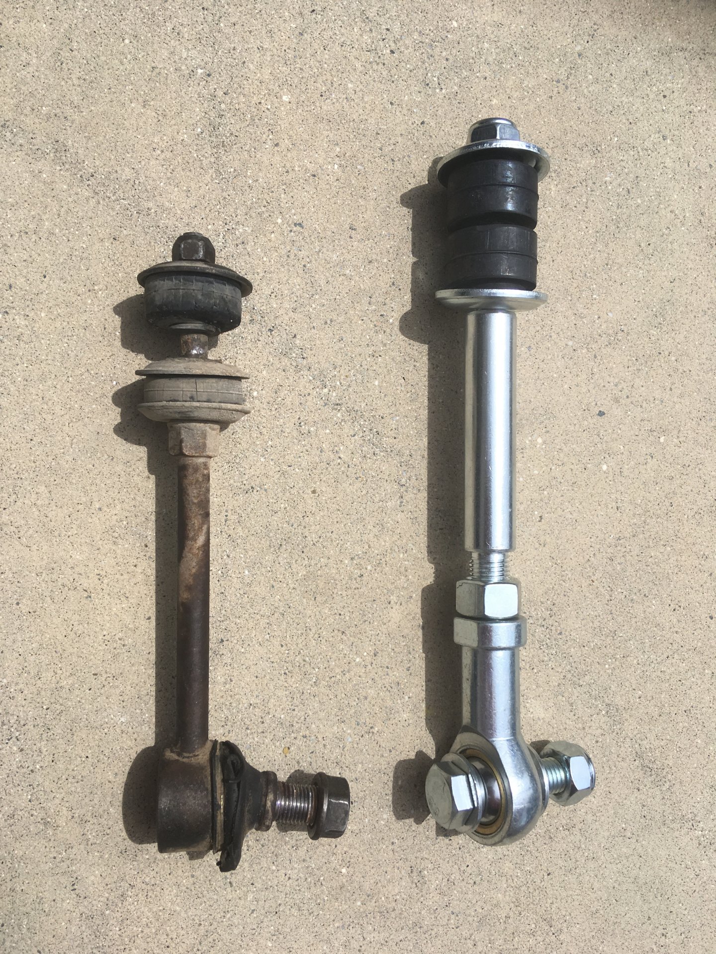

Alright folks - broke down and paid the big bucks for these things and I must say they are beefy. Pretty impressed.

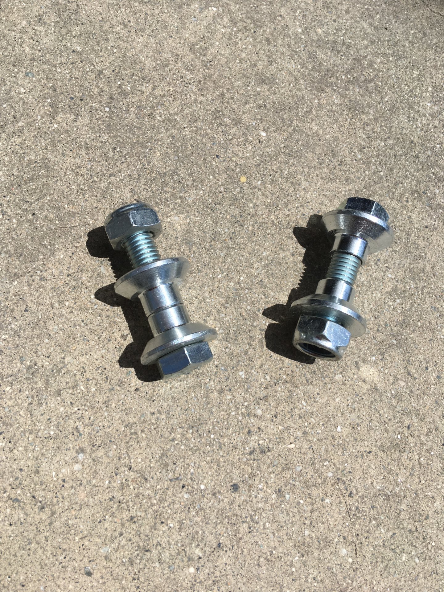

However, they didn’t come with installation instructions and there were two sets of bolts (four bolts total) that both worked with the setup on my GX470:
The above were left over - a narrower bolt with special ‘washers’ (not sure of the proper term here?) that seat through either side of the rotating section of the drop link.
I used the larger bolts that also fit through, but with more standard shaped (yet still angled) washers:
Did I do this right? If so, what are the other bolts for?

I just got some Moog links that I will be cutting and extending, but this would have been easier..
Edit: just saw that they list for $160! Even with the constant 25% off sale, I think chopping and welding my $20 Moogs will work for me. 😂
Yeah I paid under $120 with shipping/taxes, but it’s still a hefty toll for something I half wanted to remove entirely.

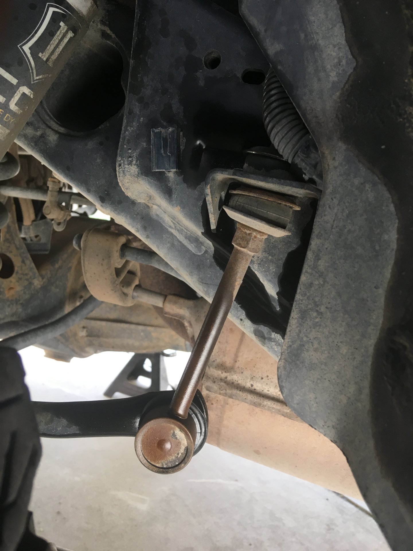

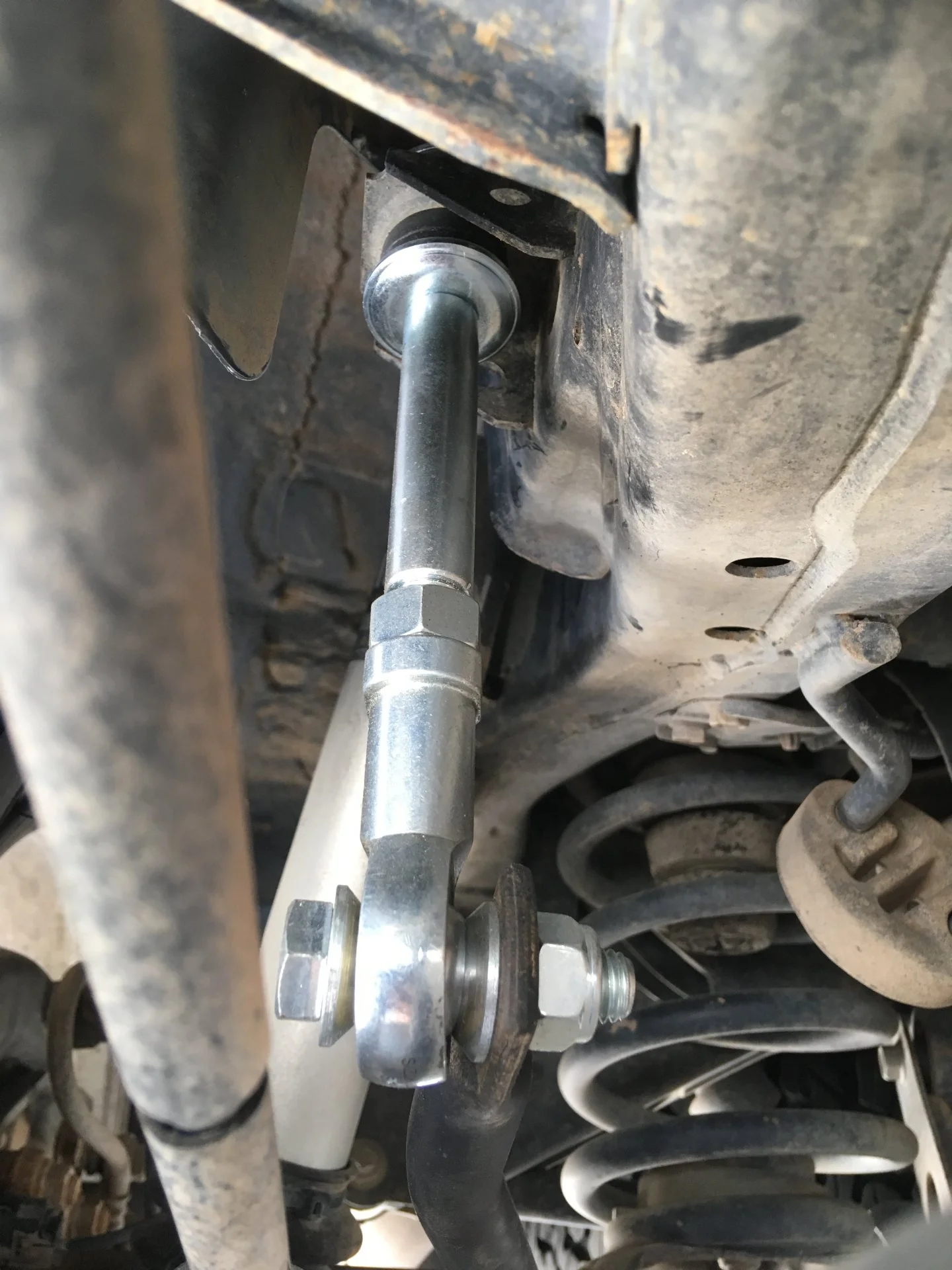

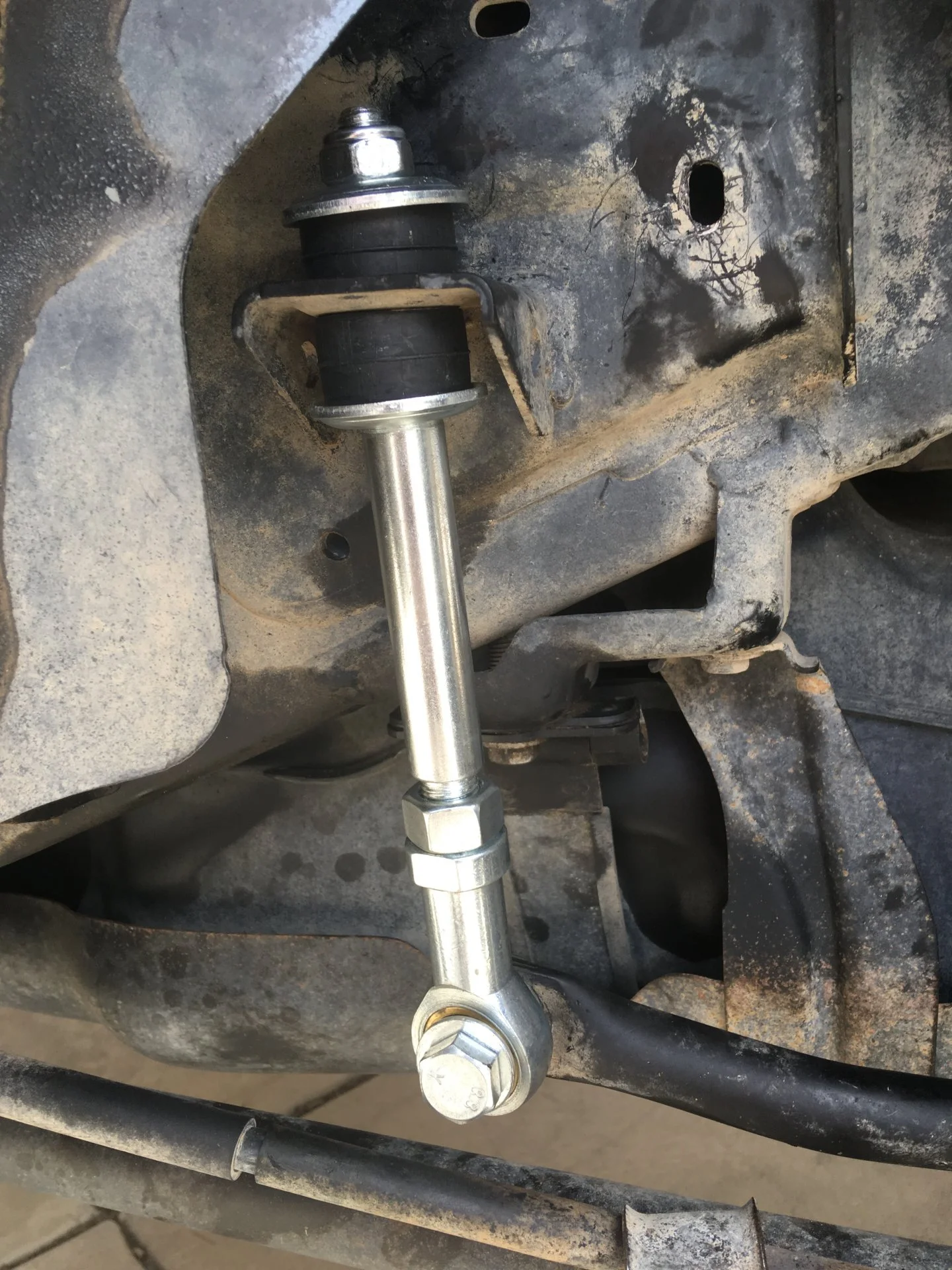

In the before pic, you can see the bar being pulled at an upward angle and with the Ironman unextended, it’s now level.
