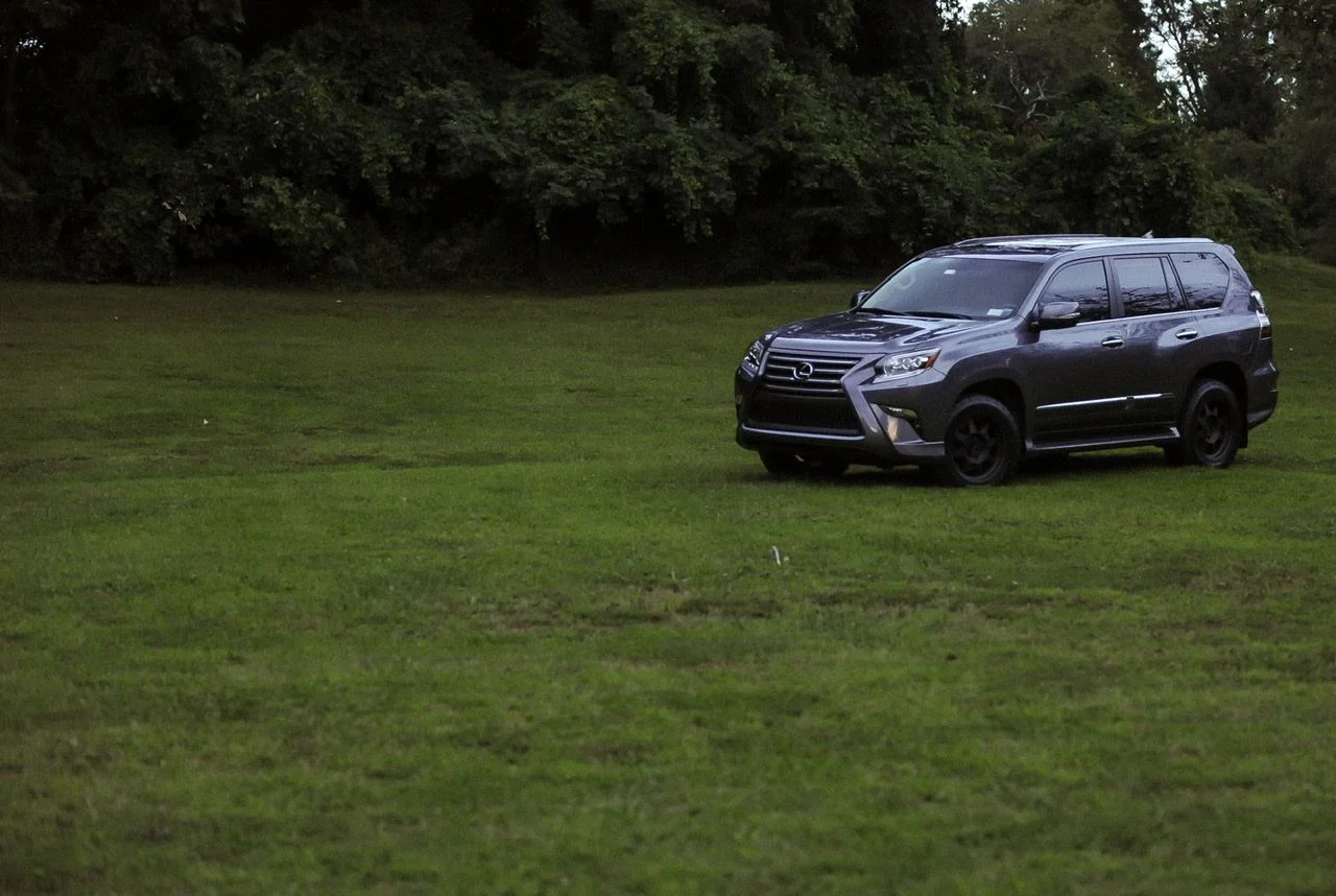

Hi all. Recent addition to the club. 2018 GX with some basics. Method 701s with Conti Terraincontact A/Ts, front tint, hitch, painted front valence and grill surround, and some interior organizers. Truck will be used as family hauler and adventure-mobile. Will regularly see fire roads and dirt, but nothing crazy. Love this forum, very interested in any local meetups in the NYC/Westchester area!

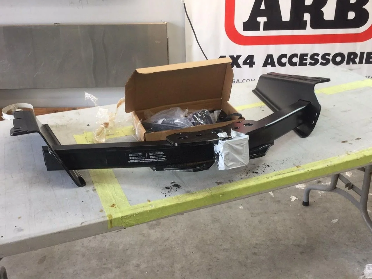

The Curt style Class III hitch is only rated to 5000 lbs. I'd be very careful. The factory hitch is a Class IIII 6500 lbs rating and is much more substantial. Much more expensive as well but I spent a lot more to ensure the safety of my occupants and vehicle.

The 5000 lbs rated receiver has 4-6 fasteners attaching it to a single cross member. The factory hitch uses those same fasteners and 4-6 more that attach to the frame rails running length wise along the frame. Thus spreading the load over a more substantially stronger structure. My fastener count is probably off but for sure more than the 5000 lbs rated receiver.
I bought this hitch on Amazon. It’s a factory hitch sold by a Lexus dealer out of Arizona and comes with all the fasteners and 7 pin relocation bracket.
Installation is pretty straight forward and easy.

Think of it this way. Your neighbor runs there crossover into a snow bank, it weighs 4500 lbs. with mire factor (slope angle, snow depth, suction of snow on the bottom of the vehicle) you could easily exceed the 5k.
