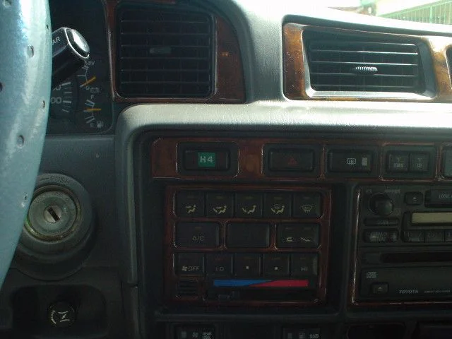

this is the switch he has on the dash of his VX 80
https://forum.ih8mud.com/attachment....entid=961&stc=1
its like a fj62 I think, just elec not vacuume, should just engage the front drive, sounds like its not engaging, on a 62 its would be the vac selnoids, on the 80 I dunno.
attachment.php
see my post on your the other thread limked by Landpimp Swanda. I suspect that H4 switch on your dash might be a central diff lock switch and you have a fulltime 4wd vehicle converted to part time by adding manually locking front hubs and using the CDL to lock out the front drive shaft when in 2wd. The VX 80 was fulltime 4wd in every market I know about.

Sorry it took me so long to reply. My Vx has a cool box (between the front seats) and an altimeter. Not sure about the shocks. I bought my VX in the Dominican Republic where I currently live. From what I know, My LC has 2wd until I lock out the hubs. The front axel is not spinning till I lock out the front hubs. When I do then I'm able to activate the H4 through the button on the dash which is in the above attachment.
Sorry but I do not know much more about my LC. Thanks though for your help.
