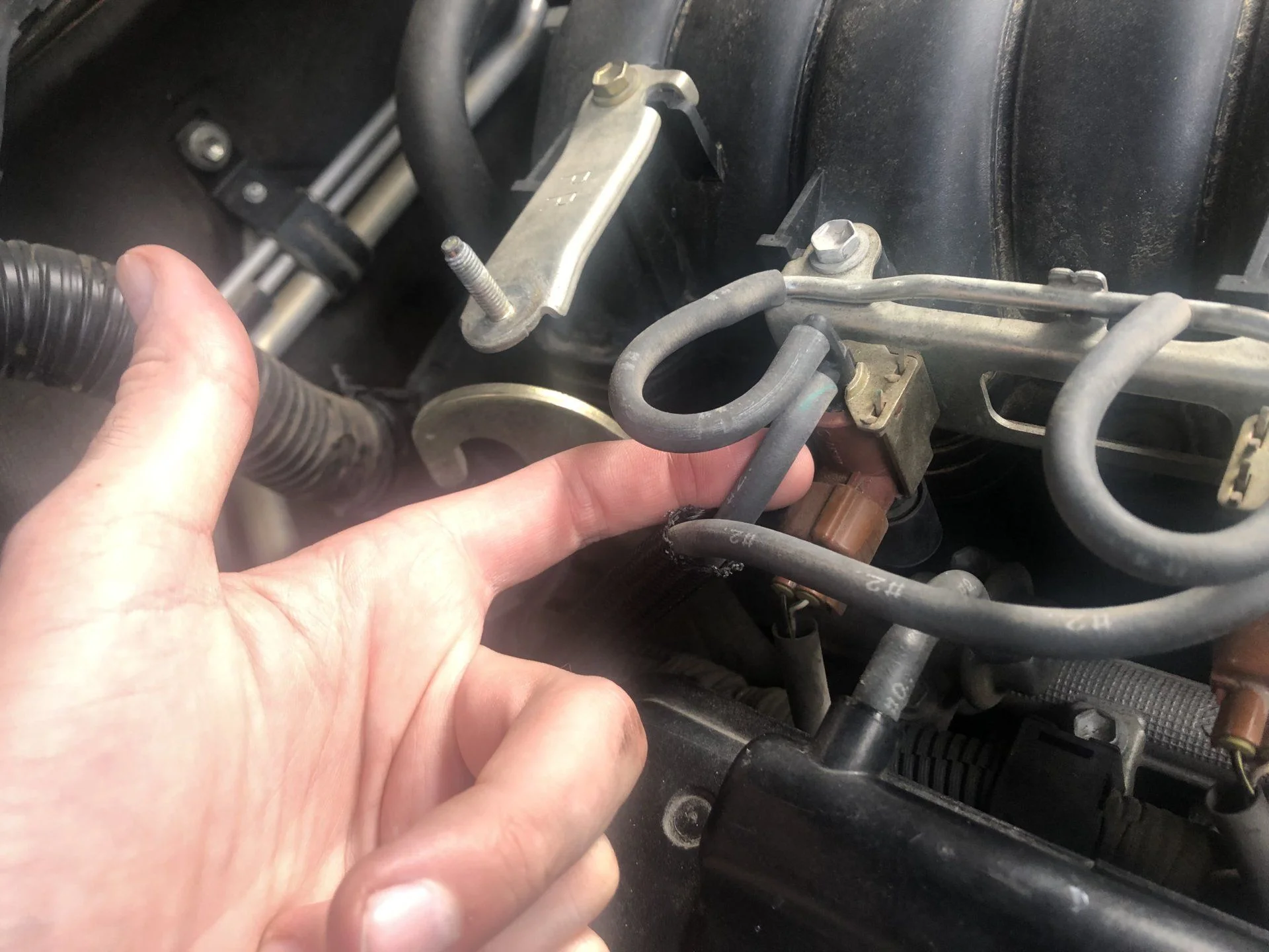

Also someone help me out with what these lines are? the one seems a little taught.
vacuum hoses from the vsv(s) where you left index finger is around both.
