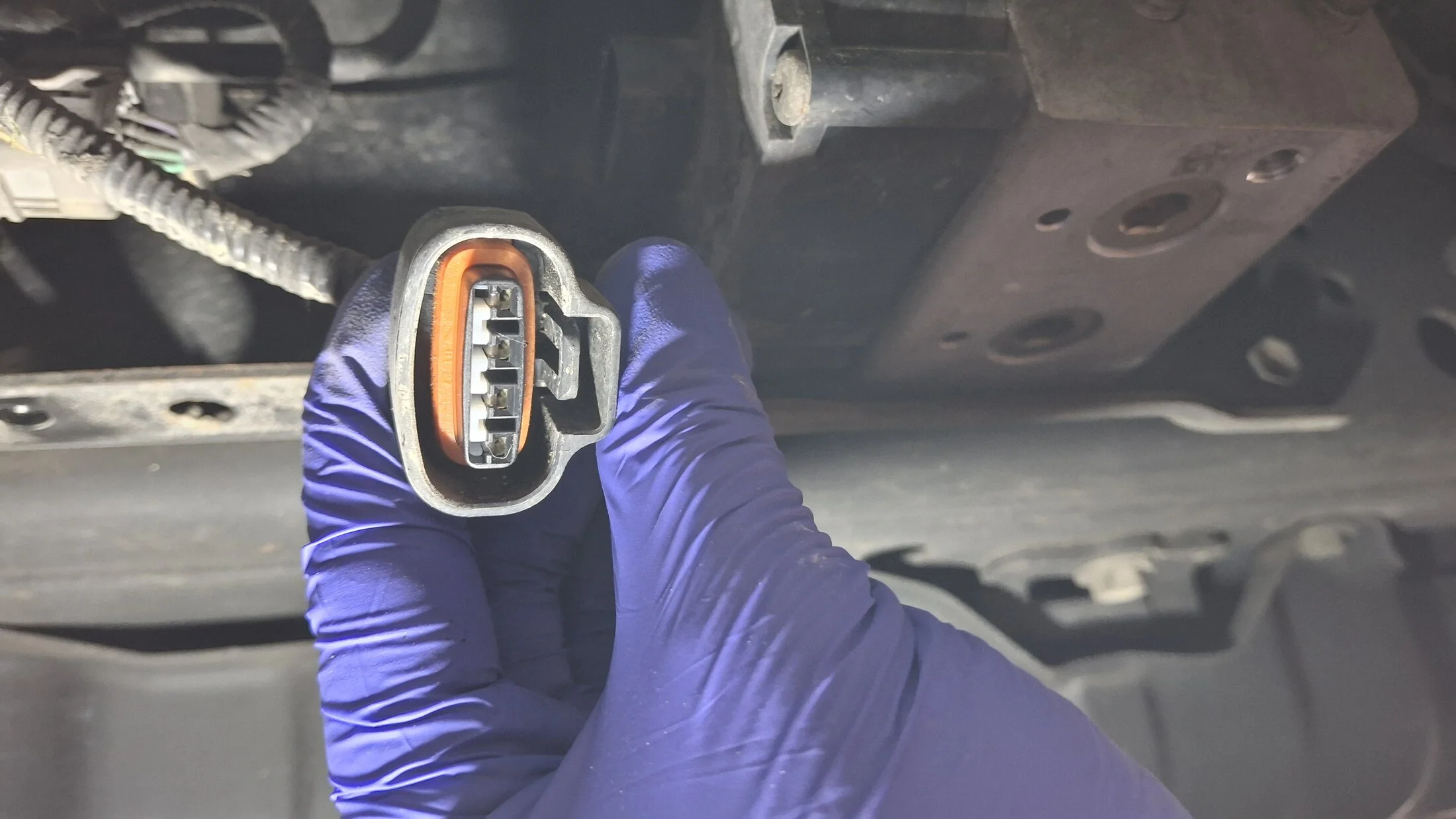

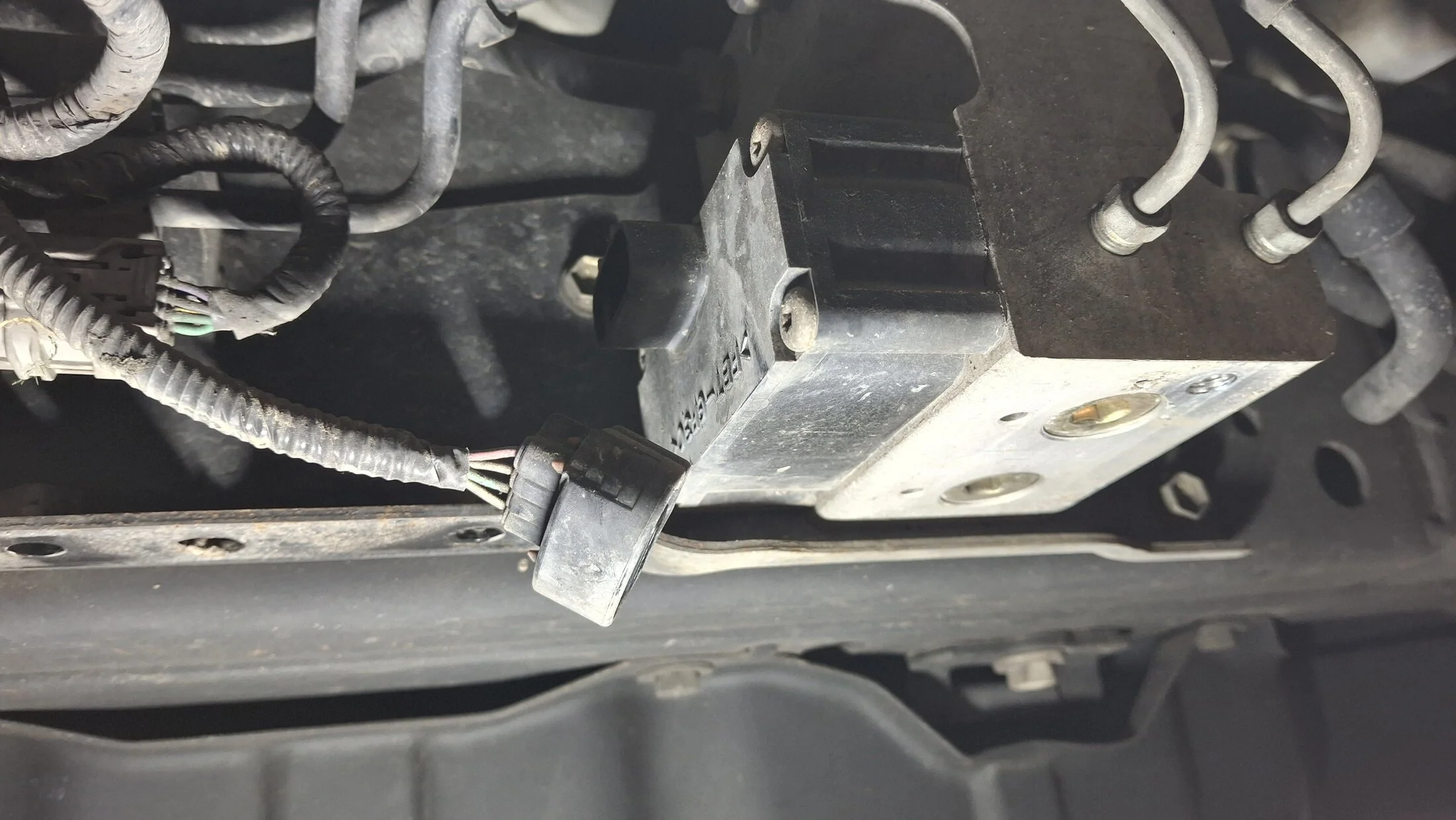

From some research, I know its a common problem for the connector and solenoid valves to corrode. But when I pull the steel plate off. It basically looks brand new. It lived its entire life in San Diego. So I doubt that corrosion would be a problem. Unfortunately I dont have a torques bit set. So I cant take off the cover to inspect the solenoids yet.

My intermittent KDSS was light was due to corrosion in the connector. Seems like yours is fine, but my codes were different too. Seems like you may have low pressure in the system but it's odd there are no visible leaks.
