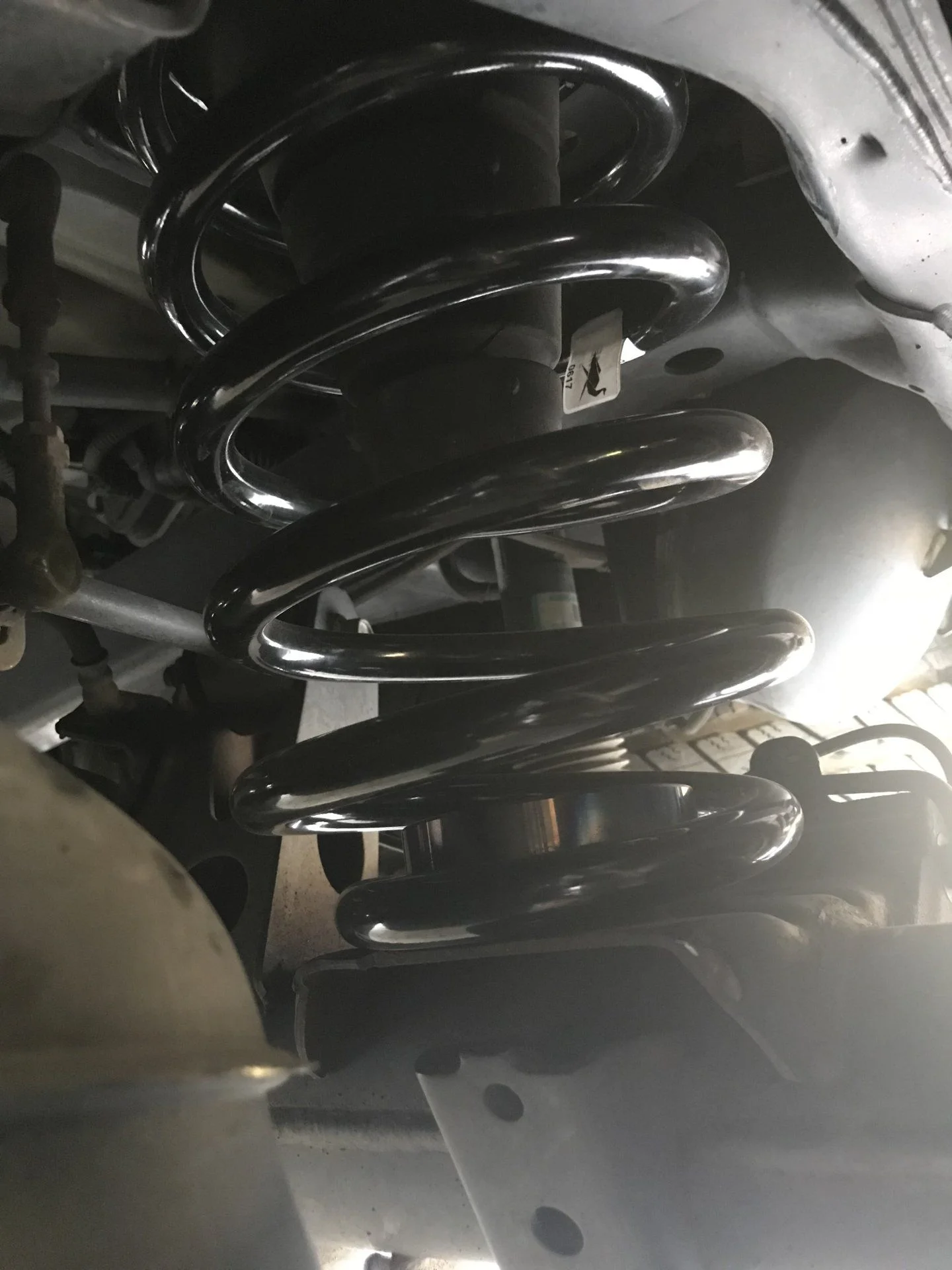

All fixed thanks to Will and his team at Sierra Expeditions.
Air bags deleted, yet the ride is remarkably smooth. It feels like 95% stock, which is what we wanted.
Lift is about 1.5". We love the result. With the number of spring and shock combinations out there, the outcome could vary wildly.
Hats off to Will for picking a combination to meet our desires!! He takes great care of our community!
2005 GX470 Sport (KDSS - With no nav)

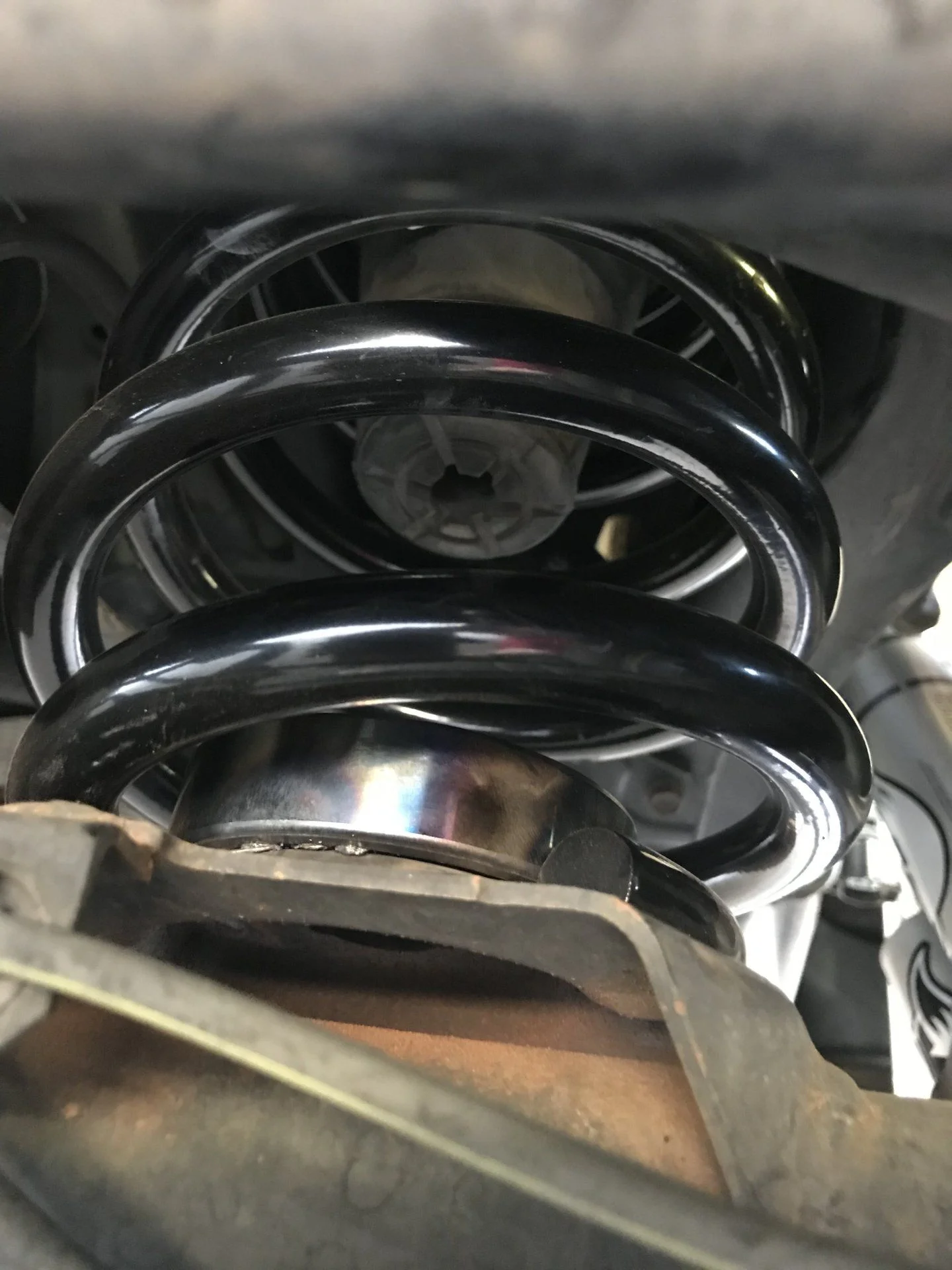

OME 2895E springs in back.

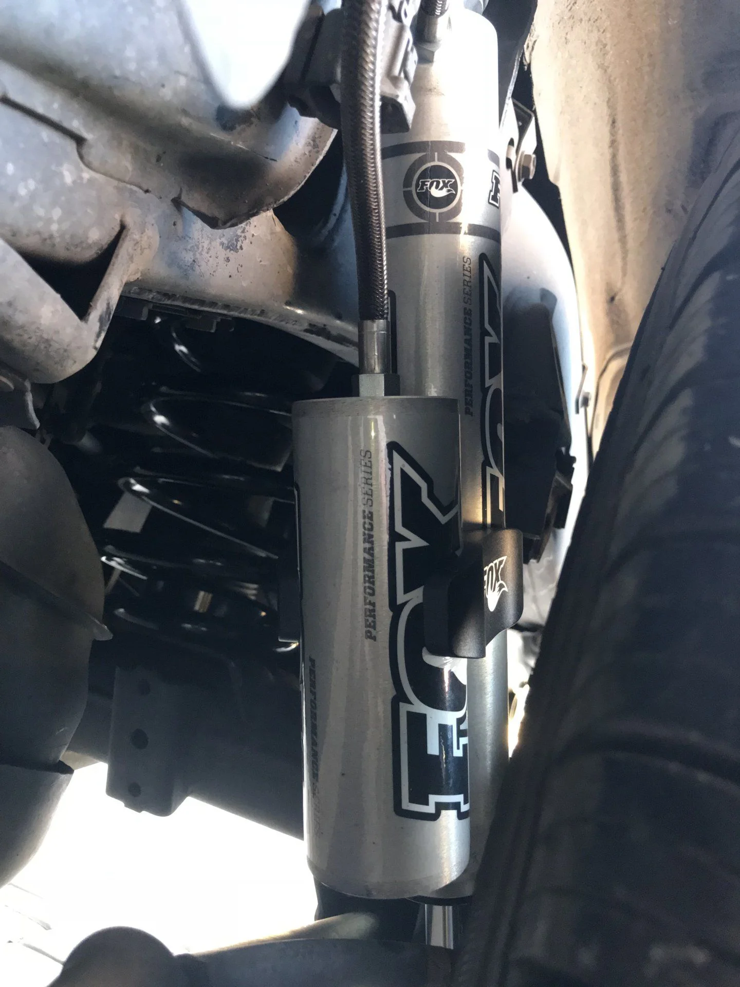

2.0 Fox remote resi shocks in back

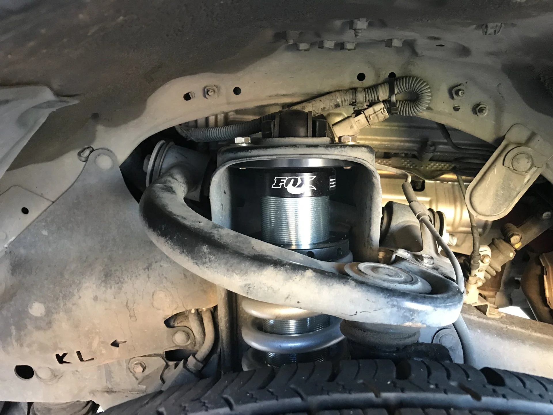

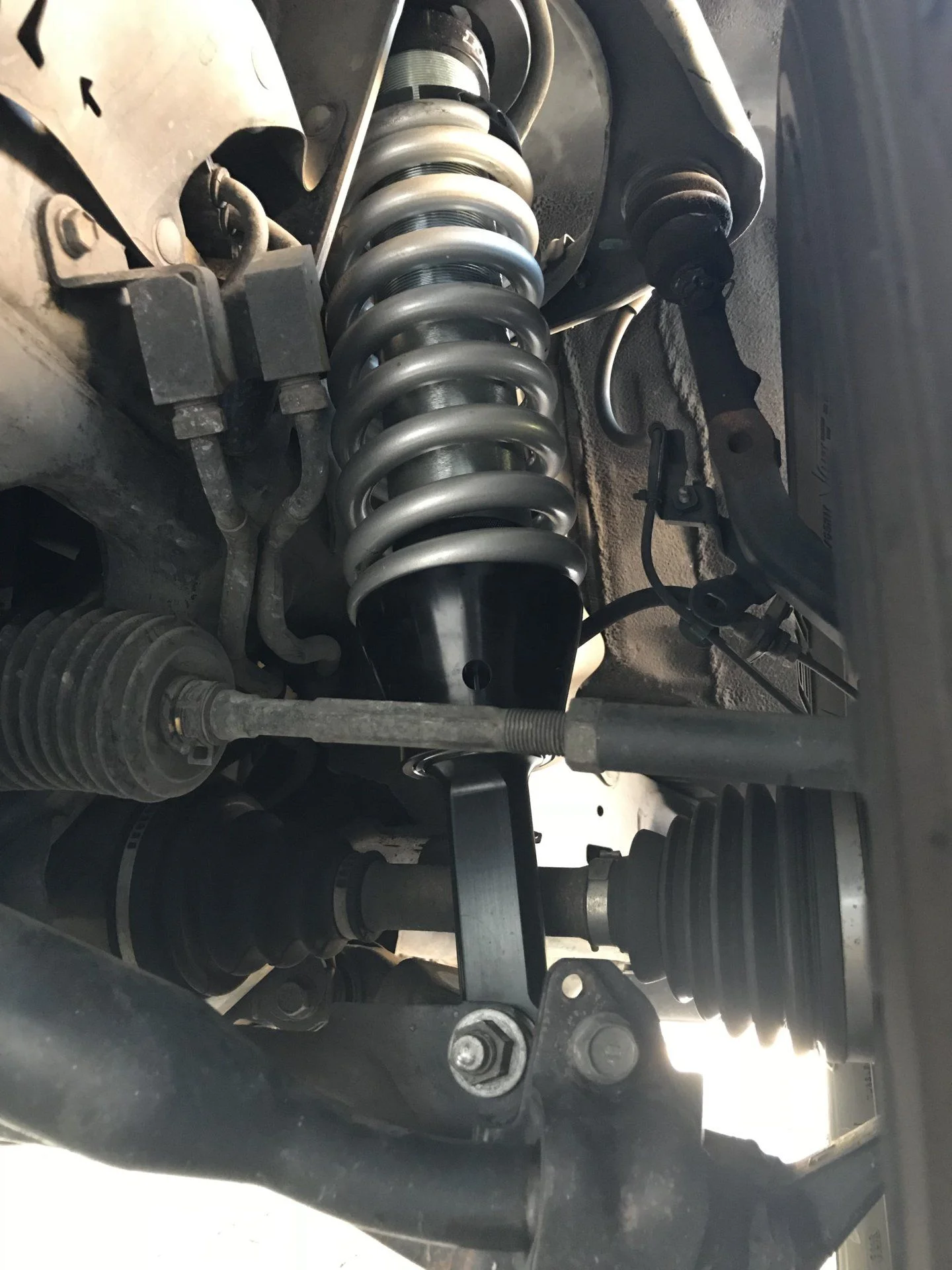

2.5 Fox coilovers in the front
That's great - love to see some photos if you get a chance. Also - I'd love a photo of the rear axle showing the spring, secondary isolator (if it has one) and the bumpstop - I'm trying to get an ideal of which spring configurations in the rear are giving the best ride with the least lift.
Thanks!

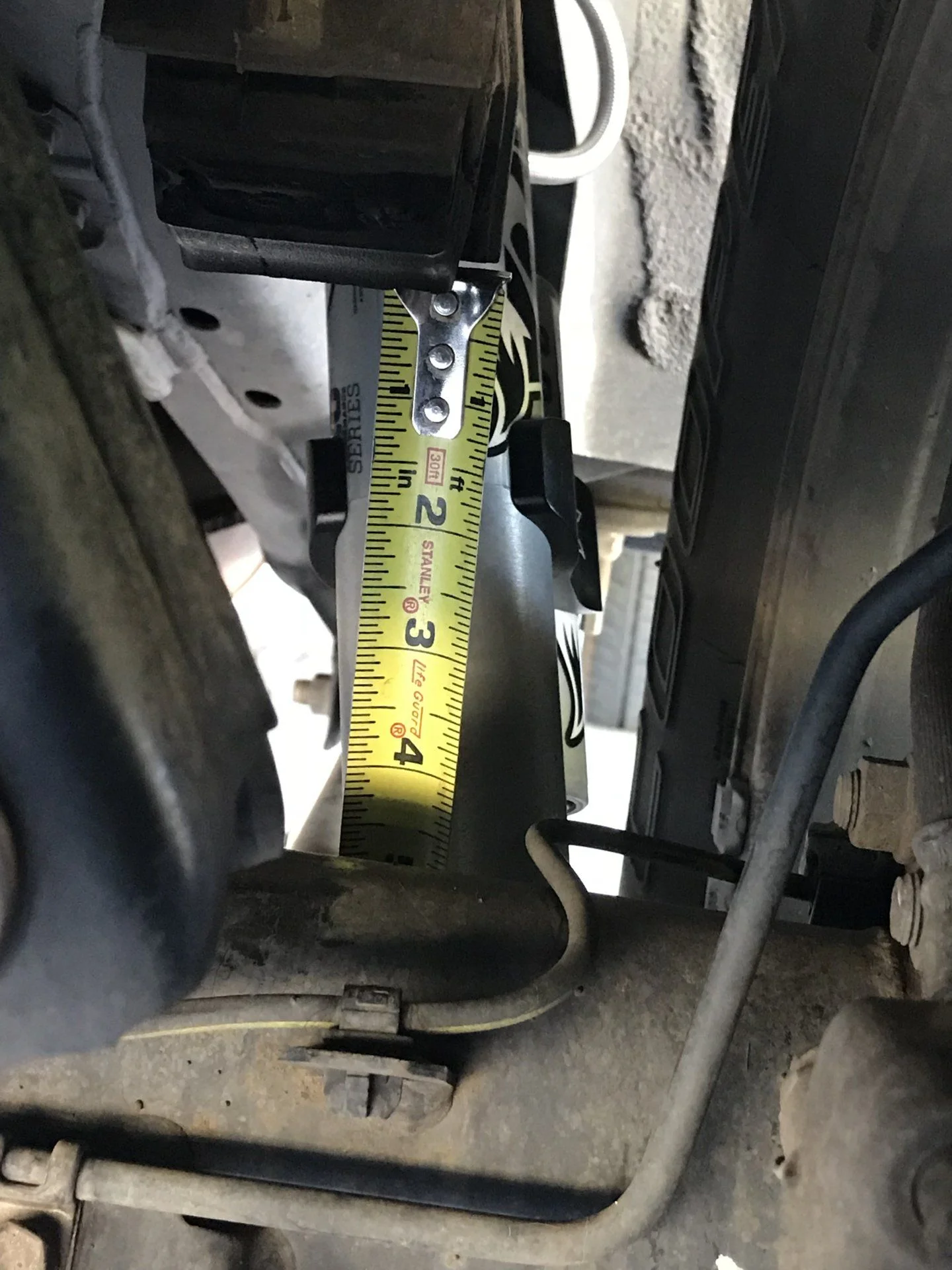

Looks good - I'm glad it turned out well! How much space is there between the frame-mounted bumpstop and the rear axle?
The spacing between the frame-mounted bumpstop and the axle is just over 4".
Here are some additional photos.
Guessing you got the 4” in shock travel?
